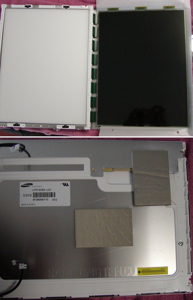

All,
Attached is a picture of the Samsung that has been pulled almost all of the way down. The top picture shows the backlight side of the liberated LCD. The connector to the left attaches to a single board that is behind the aluminum shield across the top of the lower picture. I will probably only disassemble mine this far, the metal tape/shield that will provide additional protection to the fragile cable between the LCD and board. This will also allow me to reassemble the unit easily.
If anyone is interested in a closeup of the driver card or anything else please let me know and I will post it.
On a related subject, does anyone know what the three 'tabs' across the top of the bottom picture do? They don't connect to anything. There are similar tabs on the laptop LCD I have.
BT
BT

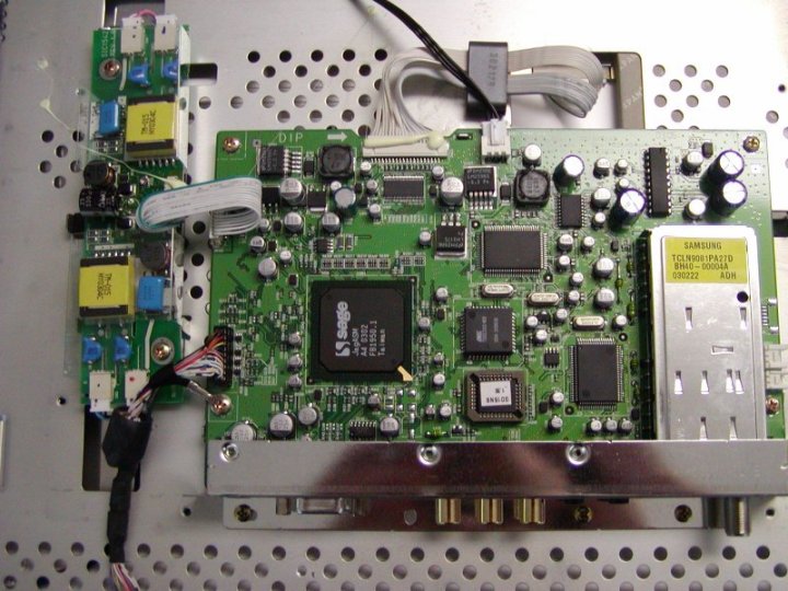

Yes, it's interesting. Especially the way the LCD is connected to the driver board(s).bigtinker said:If anyone is interested in a closeup of the driver card or anything else please let me know and I will post it.
Samsung 150MP Driver board
Afan,
Attached is the picture of the driver board. The driver board attaches to the LCD electronics through the single connector cable at the top. If you look at the bottom picture on the previous post you can see the edge connector next to the vertical pad on the right. You can also see a little of the pad through the metal shield the board is mounted to. It is not visible in the picture, but the other connections go to the buttons on the bottom and the IR reciever on the top.
If there is anything else, please let me know.
BT
Afan,
BT
