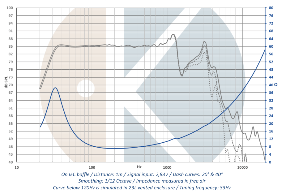

Sub180 xmas looks very good, but basically that's it. The surround seems not very wide(xmech can be limited?). No shorting ring(although motor seems well optimized), bandwidth limited. The cone has ventilation, which is a big improvement compared to Sub120.
E150HE/E180HE are direct competitors at a lower price, and Anarchy is cheaper still(with lower xmax though).
Also don't forget Misco BWX-6502/6501.
All of them have wider operating bandwidth.
Wonderful looking driver, but compared to two E180HE (so the 6 inch), the price is almost double.
So unless you have a very specific use case to be only ably to use one driver, I would go for two in many cases.
Gaining 6dB extra or halving the distortion, is extremely difficult with just one driver.
On the other hand the Kartesian is just a much more sophisticated woofer in sense of engineering and finish.
While the Dayton are much more simple and kinda build on a simple brute force way (incl many leftovers from glue)
This woofer most definitely has shorting rings, look at the description as well as the inner structure.
Also don't know why you say that the bandwith is limited?
https://www.kartesian-acoustic.com/copie-de-wom185-vki
(no this link does not go to the WOM, but to the Sub, kinda confusing, I know)
Edit: updated graph, they have the wrong one on their website, that is very very confusing.
