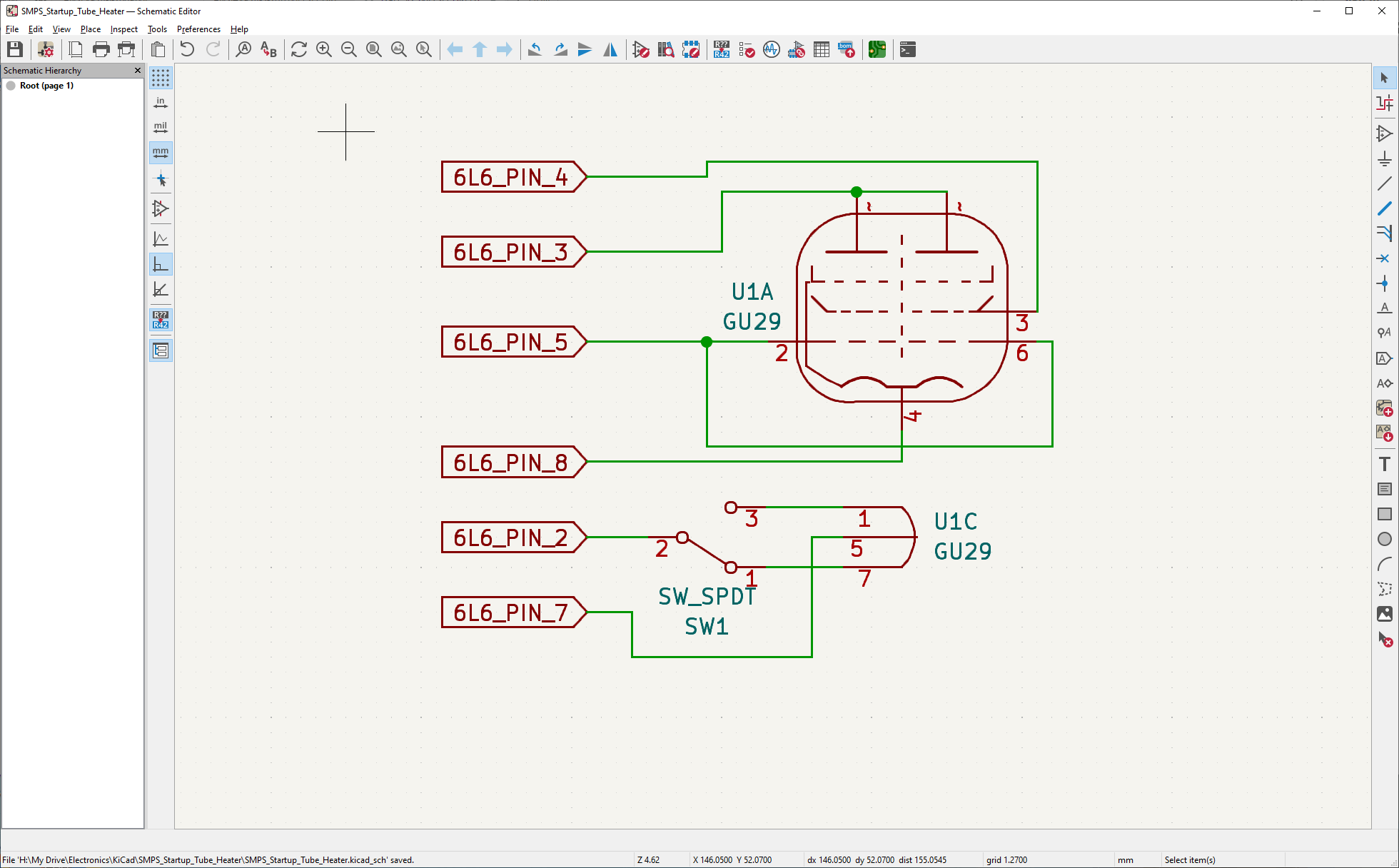

My "logic" is to fabricate a pair of octal to 7-pin adapters and then select a pentode from the Jackson's parameter list which seems most similar to half of the 829b for testing:
  • a pair of sockets to test half the tube at a time
  • The curves for the 6L6 look very close
  • the objective is not accuracy in testing, but balancing of tubes, so use of similar tube parameters should work in spite of not providing results
So my questions are:
  • are there pentodes closer in performance parameters to one segment of the 829b than the 6L6?
  • is a pair of adaptors overkill? could I just fabricate one adaptor and move the anode connecter from one side to the other to test each element?
Also be careful. The screen grid and cathode are common, if you only connect one anode you may burn the screen grid of the other section. The good thing is that the heater is centre tapped, you can power just one heater section at the time.
So the conclusion is that I need two adaptors, each powering only one side of the heater and only one anode?
Or is the conclusion that I must test both sides at once?
  • If so the single meter in the Jackson will display the sum of both segments.
  • This would drive the meter to 200% with 6L6 parameters, (and the meter pegs at 130%) so I will need to select parameters of a different tube. Any suggestions?
I always want to measure both halves. I would build an adapter with a switch to select the heater section. One thing to be careful is never operate SW1 when the tube is hot and powered. Start from cold, measure one half, turn off, let the tube cool down, 5 min to be safe, then switch to the other half, power on and measure again.

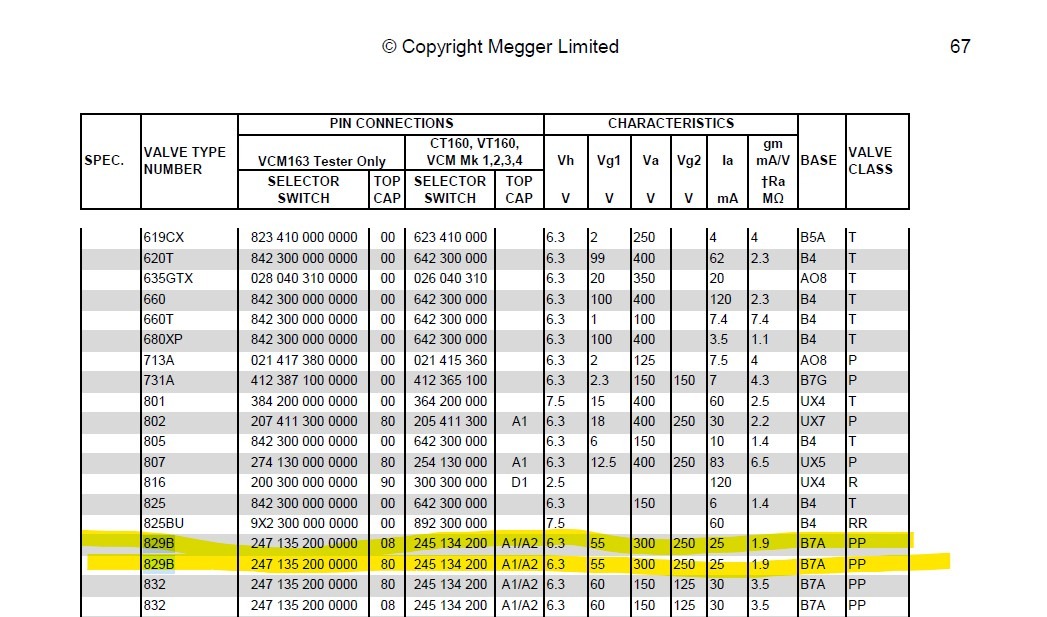

If you don't have access to a purpose built tube tester like an Avo or one with similar capabilities then you could rig up a basic test circuit with HT supply for the anode and G2 and a variable bias supply for G1 and note the anode current at a certain bias point - do this for each tube and compare, if the tubes are a close match the anode currents should be close to each other, if you need to check the Gm just vary the bias by 1 volt and note the change in anode current.
I attached a screen shot from the Avo tube tester data manual, it shows suggested voltages used for testing.
