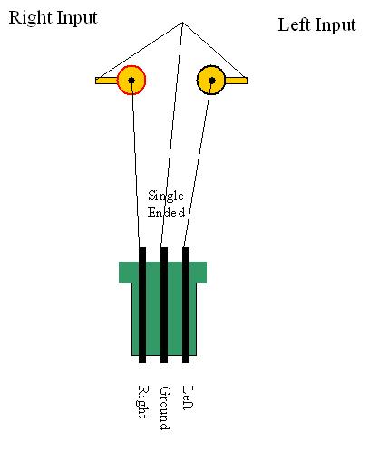

Can output section be used separately
Russ, I was thinking to use the output section of Darwin for switched outputs after Xbosoz and Joshua Tree (with the input section before Xbosoz).
But it seems that it would make a ground loop in Darwin board (inputs and outputs have common ground according to shematic), so maybe it should not be used that way ?
Even otherwise the ground would be quite same, but can be arranged as star ground. Maybe there is no problem, I am quite a beginnger in DIY.

Re: Can output section be used separately
It is a good question.
The Darwin is designed to be used with common GND (a very common technique for source selectors) if you use one PCB for both channels.
It is also designed to you can use one PCB per channel and switch GND as well as hot. This would be the same as when using the Darwin for balanced operation, but GND would be connected where the inverted signal would be, and you would not connect GND to the normal GND location.

Re: Re: Can output section be used separately
Yes I understand that but in the schematic all input/ouput header pins number 2 are connected even without the loop jumpers ? I think that the problem is this direct connection between input and output sections and a loop comes by going from loop jumpers to xbosoz and jt and back again.
I will use balanced operation, one board per channel. Well, I really dont need the switched outputs, I will just leave the output section unused.
One more question: in Control Wiring Diagram there is "Ground from Power Source" in the switches, but "+5V from Power Source" in the IDC connector, is one of those wrong ?

Re: Re: Re: Can output section be used separately
The "loop" is there to inject something like a preamp. The outputs are there to go so some other amp (like power amps) that would share exactly one source and the loop.
The loop can simply be a jumper in which case the two outputs will be direct connected to a single selected source. The two outputs can either be on or off, but they must in order to share input be tied to a single signal(s) since they are sharring a common source.
The best place to put your preamp is in the "loop". Connect the side of the loop coming from the input to your preamp(with JT), then the output of the premp to the side of the loop connected to the two outputs. You can then switch between power amps or run two at the same time (say for biamping or multi room).
I hope that makes it more clear. 🙂
Cheers!
Russ

More directly, there is no way I can see to avoid connecting with a common GND for balanced circuits unless you use three pole relays
or three single pole relays, which would be a lot of relays....
As an example I am using the Darwin to select between balanced sources with a balanced preamp (twisted sibling) and two balanced power amps (LM3886 SuSy, and a super secret SuSy chipamp 😉) with no problems at all. Certainly no humm or anything that would indicate a problem with the shared GND.

Ok, thanks! Maybe newcomers just become afraid ot grounding issues in forums like this, nearly always problems seem to be humming and nearly always grounding is suspected to be the problem.Russ White said:More directly, there is no way I can see to avoid connecting with a common GND for balanced circuits unless you use three pole relaysor three single pole relays, which would be a lot of relays....
About my other question: can the IDC connector +5V used in the switches (even said to be ground in the diagram) or do I have to do separate ground wires and leave the +5V unconnected ?
khaho said:About my other question: can the IDC connector +5V used in the switches (even said to be ground in the diagram) or do I have to do separate ground wires and leave the +5V unconnected ?
The +V should come from some power supply. It is common to all the relay coils. Each relay's negative pin goes to a control pin on the IDC connector, which in turn is switched to power GND (not signal GND) via the rotary switches. You don't connect +5V to anything else but the +5V pins on the IDC connector. 🙂 The key here is that the +5V is common and the switches switch to GND.
