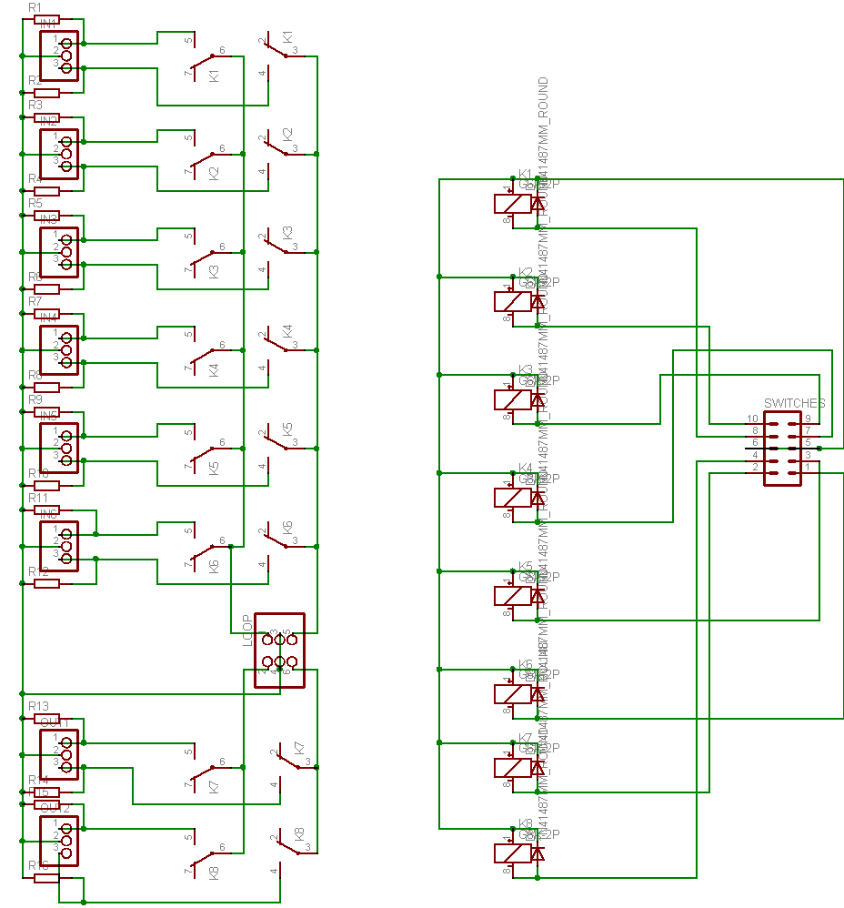

I am trying to understand the reason for the resistors on the pcb, they would always be across the input to ground except for the input that that was active adding to load presented to the source. They are probably not needed or were they ment to be in series with the input.

They are there simply to provide a high impedance (100K or so) GND reference for unused sources and ouputs. They are only active when a source/output is "off". Some sources don't like "open" loads, and most amplifiers don't like open inputs. So really I am just keeping any inactive input/outputs from floating.
They can of course be omitted.

I understand your reasoning but to me then the switches need to be redrawn or the resistors tied directly to the inputs..............or maybe I am missing something?

You are correct. It has been fixed thanks!!!
Russ,
Works for me................just a thought but you could rewire the unused pin on the relay to short non-active inputs to ground thus eleminating a potential source of cross talk...........but then again some sources might not like their outputs shorted........😉

Thank you very much for your input. I think the layout is safest the way it is. I don't want to have explain to every person who builds one of these which sources can be shorted and which can't. I think I will leave it as is and if some want to they can very easily throw on a jumper or a resistor from that pin to GND.

The second relay board is for balanced operation. With one relay board, you can do single-ended (R+, GND, L+). With two boards, one would switch R+, GND, R-, the other L+, GND, L-.
