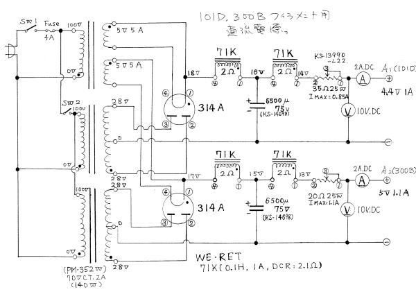

A Japanese gentleman has come up with nice DC heaters for his 300B amp

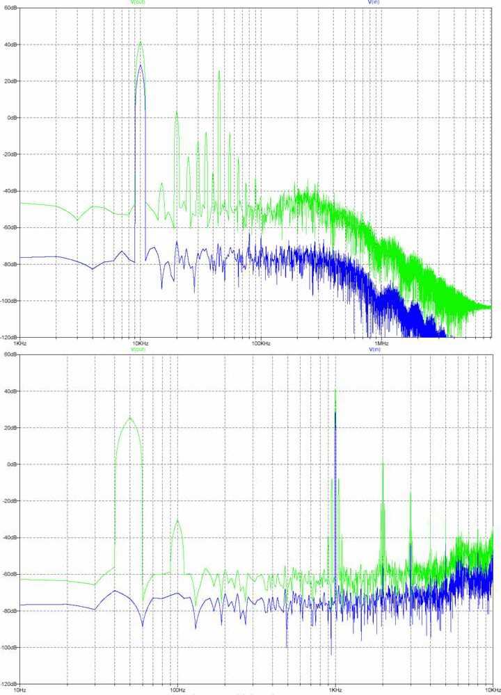

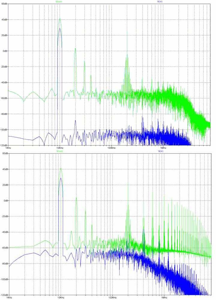

Hi Kuei,
I have done a quick Spice simulation to show what I mean with the heater frequency must be high enough and even DC switching does not hurt.
1.page:
input signal 10KHz; cathode 5V heater @200KHz sinus
(generates no audible signals)
2.page:
input signal 10KHz; cathode 5V heater @200KHz DC switched
(also no problem)
3.page:
input signal 10KHz; cathode 5V heater @45KHz sinus
(heater comes in at 15KHz)
4.page:
input signal 1KHz; cathode 5V heater @50Hz sinus
(humm @50, 100Hz and modulation around 1KHz; 950,1050,900Hz...)
The results show that also a 10Hz heater is the wrong way.
Maybe with the DC heater supply I am wrong. I will do a some Spice (seems difficult) and I will post the results.

Konnichiwa,
I still question you basic assumptions which no doubt have influenced your Spice Models.
Let me repeat, if you actually take a real 300B and test it at 50Hz you find that you buck out (make common mode) the 50Hz fundamental very effectively, making it sufficiently disappear that we need not worry about it. The same will hold true for any RF Heating fundamental, however one may require some form of adjustable capacitive "hum bucking" to get the balance right.
If we use the frequency I commonly recommend (76.5KHz) for the RF supply you also avoid any issues with difference products folding back.
However, it is a comparably high tech solution which has no real advantages over a more traditional well filtered DC Heater, at least outside commercial manufatcurerd gear.
And I repeat that I fail to observe any issues with a static deflection of the operating conditions of a given "sub-triode" within the main envelope, as cause by DC heating.

kekso22 said:Hi Kuei,
For arguments sake, I found two approaches to DC heating to sound as good as AC Heating but without the softening of sound and the general haziness and indistinctness AC hetaing brings.
1) Use Schottky Diodes & CLC as well as CMC Filtering to minimise noise and to keep any mains related nosie components low order. Use with classic balancing network (adjustable preferred) and noise can be extremely low.
2) Use schottky diodes with C Filtering plus CMC filtering (CMC filtering is essential even with AC BTW) and a regulator. Connect the cathode resistors to the negative side of the filament but connect the cathode bypass capacitor to the positive side of the filament. This was shown by JC Verdier and I found it to be a major step forward on (voltage and current) regulated DHT heater circuits.
Both approaches seem to show non of the negative sides usually ascribed to (and also observed by me) to DC heating.
I must agree that the traditional methode with a cheap bridge and a single 10,000uF Cap usually seen for the 300B is absolutely abysimal and sounds a lot worse than AC, edgy, agressive and hazy. The reason becomes quickly obvious if you put a 'scope on the filament or better do an FFT of both the error current flowing into the cathode/ground (and thus grid) loop of the output stage and of the voltage across the filament....
Sayonara

One key problem with heating a DHT from a mains supply (AC or DC) is that there are usually quite a few 10uA to 1mA leakage of noise (50Hz all the way to FM range) into the secondary circuit referenced to earth/ground. This current is in dact injected into the cathode. The 50Hz leakage can be dealt with much easier than HF leakage. Common Mode filtering removes some of that noise.
My current 300B SE Amp which uses DC on the heaters (like most of my designs) is here:
http://www.audioasylum.com/forums/tubediy/messages/71898.html
The heater circuit is shown here as part of the whole schematic:
To see the kind of chokes used look at this Photo:

kekso22 said:This sounds good to me, I will try it. Can you please tell me what you mean with CMC filtering.
CMC = Common Mode Choke.
