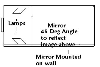

i have ade a new discovery. i think these are called artograph projector or something where u place the thging on top and it projects it. it looks like a standard projector witha lid on top. I belive thisidea has come up b4 but ppl say it has been unsuccessful. maybe it caus they dont use lights pointing @ mirrors mounted on the side . oh well just an idea.
oh yeh ad if this doesnt work then ill just have to put it into a custom-built, double sided picture frame.

OK, we had an initial picture that was worth less than a thousand words to start with. It was misunderstood.
Let me make sure that I understand what you are trying to do:
--Bounce light off of an LCD panel and have it end up on a screen, right?
--No light gets to the screen without bouncing off of the LCD panel. right?
Let's follow the light:
--All of the light we are going to shoot onto the screen will start from either a bulb or the backlight on the LCD, right?
--Light goes from the bulb bounces off of some half-reflective surface, illuminates the LCD panel, then goes through the half-reflective panel, through a lens and onto a screen, right?
--None of the light from the bulb gets to the screen without bouncing off of the LCD panel (and going through it twice, once in and once out), right?
And check a few premises:
--Polarization has nothing to do with this working, outside of the polarization that occurs inside of the panel, right?
--The very first picture shown in this thread had the mirror in an unworkable position (rotated 90 degrees from workable), right?
--The mirror doesn't have any intelligence or moving parts or circuitry (like a DLP mirror), right?
--If you took away the LCD panel from th design and replaced it with, say, a magazine page, it would work essentially the same way, right?
And add a bit of conjecture:
--You really just want to shine a bright light on the LCD panel (regardless of any mirrors employed or not) and get it through a lens and onto a screen, right?
--The use of the mirror is so that the light can enter and exit the LCD panel perpendicularly to its surface, right?
And wrap up with a couple of suggestions:
--When you make a drawing, draw at least one ray of light following the path from the lamp to the screen. (With all of the bounces in between)
--Take your LCD panel outdoors on a sunny day (while connected to a signal and power source) and see if the sunlight makes the image on your LCD panel bright with saturated colors or simply washed out and 100% unviewable.
--Lacking the above, just aim a flashlight at your screen. Do you get a bright circle of picture, or a bright circle of glare on the surface from it?
--See how long it takes for the panel to get warm to the touch. (These things have problems startimg at about 100 degrees F. --Human body temperature. Therefore if it feels warm, that's too much light energy landing on it.)
--If you want to use the panel as reflective, you'll need to either start with a reflective panel, or dissassemble the transmissive panel and put something reflective in the back of it. You will get SOME reflection out of the light source assembly, but not much.
All of the questions above (that ended with the word "right") are being presupposed by me here. If any of them are not true, let me know.
Once you have responded to this, I can show you how to greatly simplify the design of this thing.
But we need to be talking about the same fruit here.

As far as a simplified design, I first need to be sure of what Jake is trying to do here.
I will pretty much guarantee that we won't need any half-silvered mirrors, though.
If the idea is really just "shine a light on an LCD and put a lens between the LCD and a screen somewhere" then it can be done very simply.
The experiment still needs to be done though. Shine a light on an LCD panel and see if you can make a bright IMAGE, not just a bright glare on the screen.
If it is a point source light (like the sun), we only need a bright image in the center of the screen. Collimating the light out into parallel rays can even out the sweet spot to cover the whole screen.
If all you get is glare (pretty likely) we will need to add one element to the experiment: a sheet of polarizing film.
Basically, only light which is polarized diagonally to the screen (like from corner to corner) is going to make it in and backout of the whole panel. Light polarized the wrong way will be wasted in two ways: [1] as heat, since it will be absorbed into the panel and heat it up and [2] as an "early" reflection--that is, it will reflect before it goes through the panel.
[1] above will just cook the panel and [2] above will just make glare.
If you have access to a sheet of polarized film, just hold it between the panel and light source and rotate it until the glare is at a minimum.
One likely problem though: if the colored filters are reflective, this may cause glare. This is one different between a panel made to be reflective and one that is designed to be transmissive. In a transmissive panel the light can go through actual LC twist and then through the colored filters. In a reflective panel, the colored filters sound be on the far side of the panel, meaning on the other side of the LC twist.
Am I making this confusing?
Let me know and I can clarify.
Having not attempted this with a panel, I don't know how much unfiltered reflection will occur. My guess is that the unwanted reflection is going to drive the contrast level so low that this scheme will be unworkable.
I hate to say that someone's bright idea won't work. In fact I'm still rooting for the "lots of white LEDs" guys and the "hi intensity flourescent" guys.
I have seen a lot of apparent "cheats" here though. People keep coming up with ideas that involve taking white light and passing it through extra colored filters and trying to send it through 3 panels and such. Many of these ideas LOOK like what is happening in commercial units, but this is only an apparency. Really there ain't know way to add filters and get more light (think about it--all a filter can do is waste light).
There are so many points in the light path that subtract light, we need systems that add light.
Outside of DLP's and CRT's the closest we are getting is a backless LCD monitor with a ton of light pushed through it as parallel as possible. An efficient screen can help a bunch, too.

reflective panel losses ain't so bad
As far as the losses incurred by going throught the same apnel twice, it's not really that bad because most of the reasons for loss don't get doubled go through the second time.
Big loss - the color filters: Shine white light through a red filter and you lose 2/3 of it (all of the green and blue) in a 100% efficient system. Take the resulting red light and send it back through the same red filter and (theoretically) you lose nothing, because all of the green and blue is already gone. Whatever red light passed through the first time should pass through a second time without any problems.
Big loss - polarization: When unpolarized light is sent through the first time, half of it gets absorbed (at least) . When it comes back through it is in the correct alignment to pass through with no additional loss.
Big loss - the "screen" : Whe the light goes through the first time a lot of it hits the spaces in between the pixels (the "screen" as in "screen door") . If a well-aligned mirror is on the back, any light that made it through a "hole" will come back out through the same hole.
It is even possibly to have TWO LCD panels, perfectly aligned, in a sandwich. The light goes through the first one, then through the second one. The loss through the second panel is very small. You can use an arrangement like this to boost the contrast ratio through the roof.

just to be clear, shouldnt the original design in this thread be:
yes that is the original idea but those plus projectors work in exactly the same way! they use a mirror and circulate light throughout the "chamber". apparently this brings a wahed out image but the plus projectors dont.
does anyone know why the plus projector works - the only diffence is that i notice the plus projector lamps shine onto mirrors at the side and thats all.
thanks
