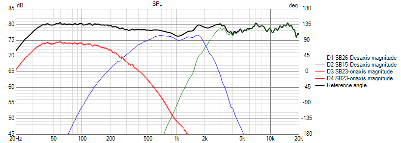

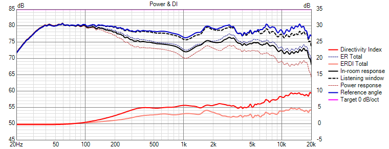

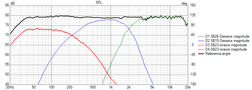

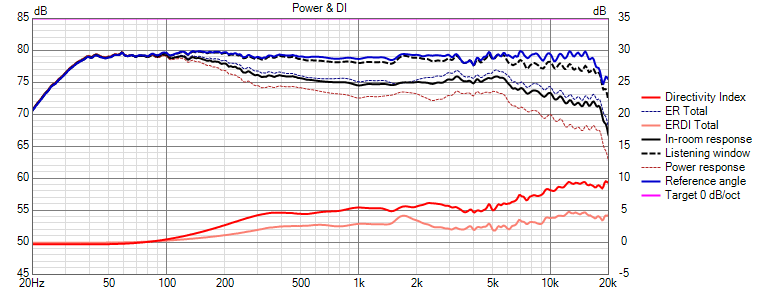

As I said, the most important parameter is the frequency response and radiation pattern.
This first speaker will lack clarity and detail compared to the second speaker
This second speaker will be percieved as much smoother, with more clarity and detail, and less listener fatigue. Same drivers, same cabinet
Distortion and other secondary effects are meaningless until the the first speaker is transformed into the second speaker by a well designed crossover. Only then does it make sense to focus on secondary effects.

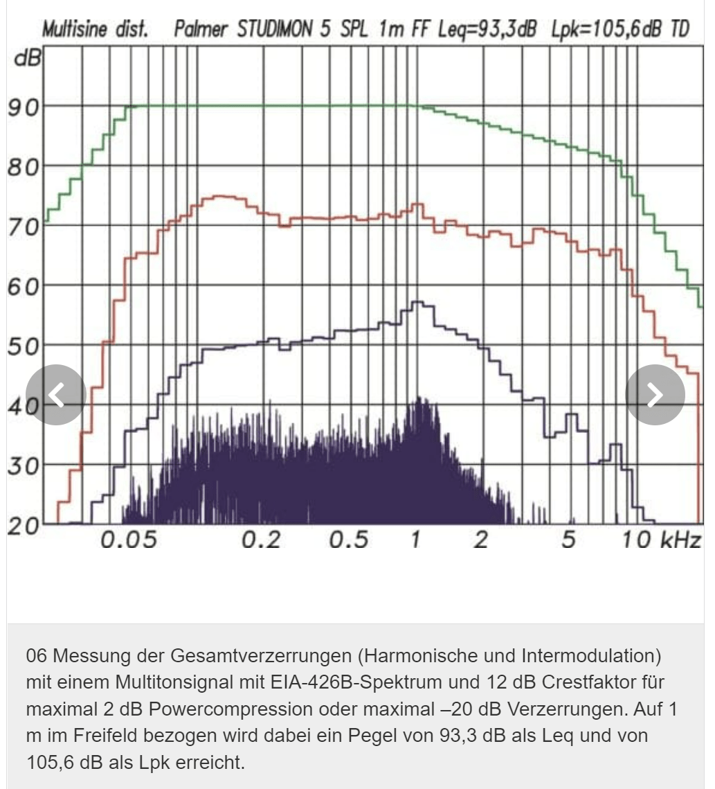

About intermodulation distortion, I don't think it is a problem in hifi speakers with reasonable quality. Even making it show in measurements is very difficult, because of room noise, mic S/N and driver's HD are masking it. 32-tone signal is often used, but the fuzz that measurements are showing is not necessarily IMD, just regular HD. German magazines have been measuring multitone for ages with Klippel system, and they call the result "gesamtverzerrung" (common distortion)

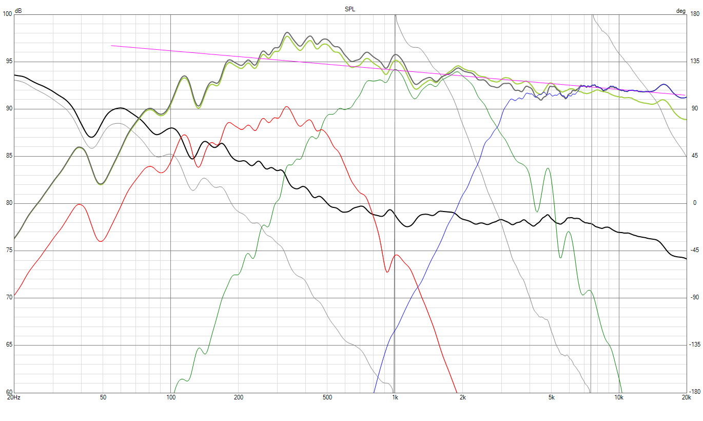

i'd follow more test with vituixcad:
1. "remove" IEC baffle refraction response from manufacture frd response.. (as you know, SbAcoustic have measurement on IEC at 30cm)
2. Cleaned response and used on simulate baffle dimension as project draw
To export single driver measurements i'd used mic at 3Meter in tool simulator, about on listening position.. 1Meter over floor , center on horizontal plane.
3. Loaded exported directivity measure for each driver and create xover.
i share with you response , minimal phase still about in enough level fron 300 to 8000.
Next step is to merge woofer response with simulated box response.. to be and to have more details data.
If someone know how to do that.. very thanks
