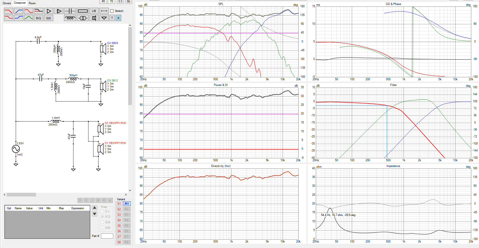

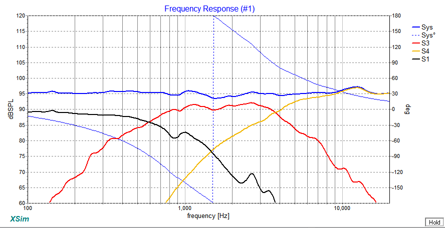

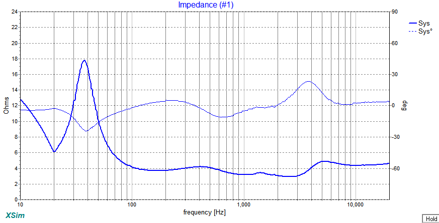

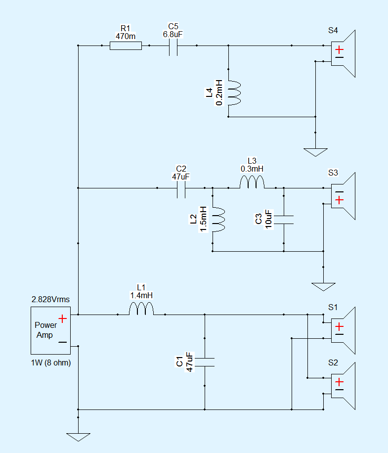

just to back in topic 😉 .
i'd follow more test with vituixcad:
1. "remove" IEC baffle refraction response from manufacture frd response.. (as you know, SbAcoustic have measurement on IEC at 30cm)
2. Cleaned response and used on simulate baffle dimension as project draw
To export single driver measurements i'd used mic at 3Meter in tool simulator, about on listening position.. 1Meter over floor , center on horizontal plane.
3. Loaded exported directivity measure for each driver and create xover.
i share with you response , minimal phase still about in enough level fron 300 to 8000.
Next step is to merge woofer response with simulated box response.. to be and to have more details data.
If someone know how to do that.. very thanks
