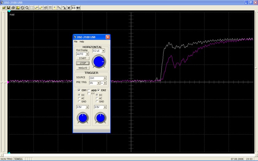

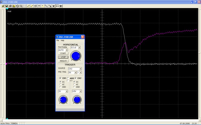

Now turning ON again and showing Ugs and Uds of the lower MosFet.
Halfbridge has no load connected. Due to MosFet capacitances we can expect that the half bridge will not slope during dead time.
Sloping takes place when the lower MosFet is turning conductive.
Turn ON delay is something like 50ns .... or so...
White Trace: Uds of lower MosFet, 20V/Grid
Red Trace: Ugs of lower MosFet, 5V/Grid

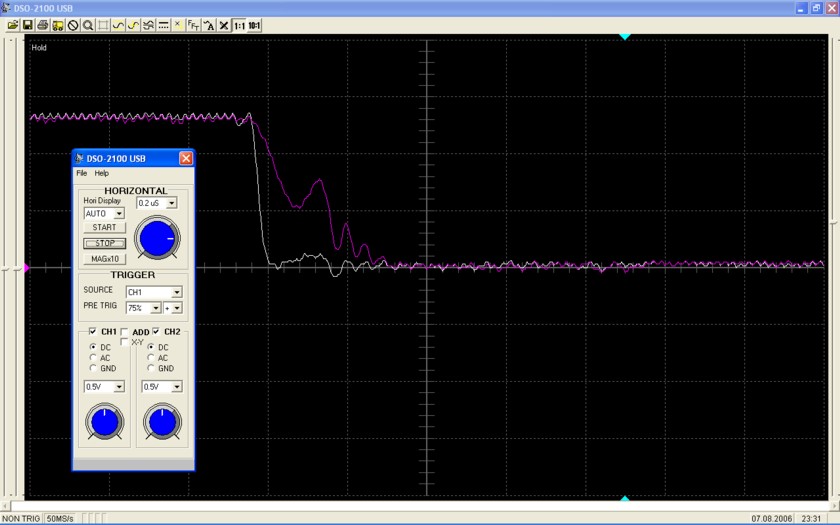

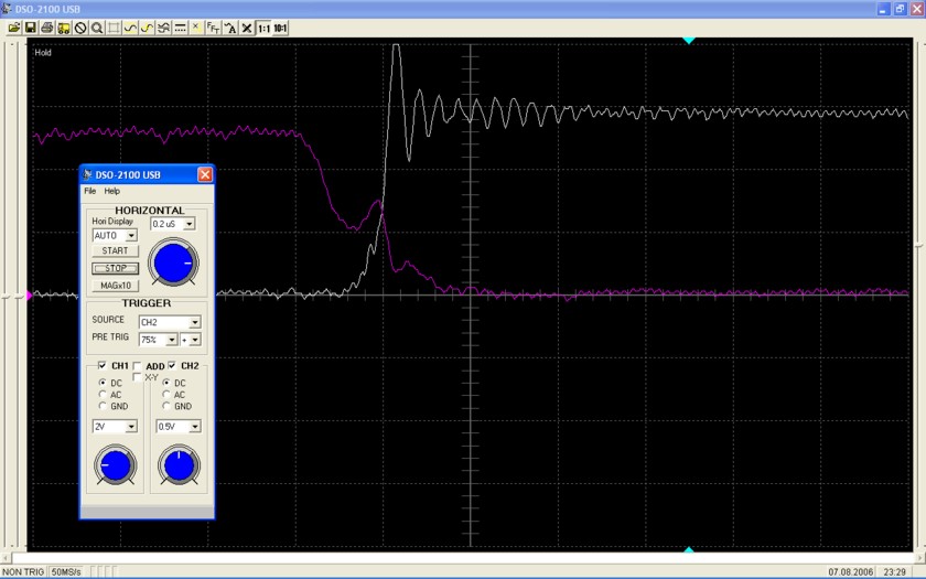

...the last measurement, before I have to go to bed:
Turning OFF and showing Ugs and Uds of the lower MosFet.
Turn OFF delay is something like ??!!
.... or so... for sure above 100ns.
I am in the range of some cross conduction, even if there was not much heat generated, when running with 400kHz.
...have to examine this more detailed...
Also the 20MHz ringing of Uds is ugly and has to be cured.

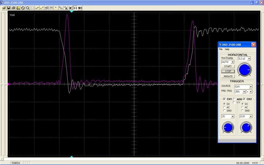

Welcome to reality
My fat MosFets are definitely the max limit, which this tiny driver can handle....
With the simple 22 Ohms gate drive, there are some nice crossconduction peaks around 7A for roughly 100ns...
This di/dt also caused the ringing, means the entire rail was ringing due to rail high inductance and only 2uF at the power stage. But rail ringing is no issue, because some larger fast caps at the power stage is smoothening this and without cross conduction this ringing is not triggered anyway.
When I parallel shottky diodes to the 22 Ohms in order to speed up the turn off with all available driver capability, then these crossconduction peaks go down to something like 1A/60ns. Well this seems to work, but is still ugly.
Unfortunately you cannot increase the 22Ohms for turn ON because this is delaying the turn ON to much and the overcurrent protection is shutting down, because sloping is not fully finished before the 200ns blanking is over ...
Hell !
I will have to play around with more non linear gate drive circuits, which do not charge the gate up to 13V, but to something like 8V-9V only...
Or I will have to look for some lower gate charge MosFets, but IRF540Z is slightly to weak... hm...
Or forgetting the IRS20954S and using a silly L6388?
Nice IC, but not suitable for high power MosFets.
I guess that's the reason why they state suitability for amps up to 500W. The limit will in many cases not be the voltage rating. Also not the thermal of the IC, but it's driving capability in combination with unpleasant short OC blanking. Unfortunately I do not see any option to enlarge the blanking time or disable the overcurrent protection of the low side FET. Is IR adressing to headphone amps with this IC ? 😀
Attached the ugly crossconduction with simple 22 Ohms gate drive.
(This condition can also sometimes trigger the shut down.)

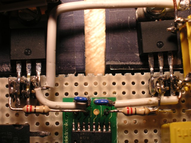

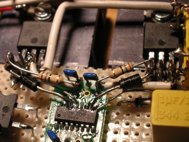

Also I made up my mind about the inductances in the gate drive.
But from my perception I would guess the inductive impedance of the attached wiring is much lower than the 22 Ohms gate resistor.
The white wires are the source connections between IC and MosFets and do not carry any load currents.
The gate resistors are placed mostly in line and the enclosed loop area appears not so bad for me. But I must admit: I am a HF-beginner.
IRF6665 seems to be a nice device. But it is to weak for my pupose, because I am going to run two paralleled 4 Ohm woofers from a +/-50V full bridge.
An additional discrete driver would probably help to speed up the Ugs sloping, but I am afraid of the group delay of such a buffer. It might cause similar issues as a slow dv/dt at the gate. ...up to now not tried, just a feeling from my stomach.
...also playing around with 18 Ohms and paralleled discharge diodes.
In order to reduce the inductances, I added an additonal straight wire between IC pin and source of the MosFet. The shottky diodes for discharging are directly connected to the IC and the MosFet. Also mostly straight geometry. Ugly looking, but more or less low inductive.
Nevertheless today, the shut down phenomen is quite strong, no matter if I use the older set up or the new one.
...not pleased in the moment.... May be there is another shut down mechanism, which is troubling me.
But it seems not to be related to my connection of the floating input, at least two other floating input connections and also input section bound to negative rail showed the same issues.

On the other hand I just measured the delay between ON signal of the lower gate driver output and the moment, when the output voltage of the halfbridge is touching the negative rail. In the setup of posting #54 I am measuring a delay of slightly less than 100ns. So I am not sure if I am still in trouble with the turn ON delay and 200ns shut down blanking.
Well, I can only measure this if the system does not shut down.
The poor triggering of my scope does not allow me to fetch the Also I repaired my differential probe and tried to measure the
moment of shut down with sufficient resolution.
Also I repaired my differential probe and tried to measure the VB.
Hm, probably OK. But my diff probe does not have a sufficient HF common mode rejection, so I cannot judge how much of the displayed peaks during sloping are reality or just a measurement error.....
...comes time, comes better understanding and a solution.
Unfortunately I have no chance to go on during the next days. May be Sunday, or may be the week end in ten days....
It looks like you have short, minimal loop area connections directly between the G-S drive pins on the IC and the G-S pins of the MOSFET -- so far, so good. Unfortunately, the MOSFET power circuit is not completely visible in the photo. I can see one big wire between the top MOSFET's source and bottom MOSFET's drain, but not the rest of the loop (back around through the power supply capacitors). There may be enough inductance there to lead to forward biasing of the IC's substrate diodes during ringing peaks following switching. If that happens, bits of the IC can get flooded with carriers (which could possibly lead to the unexpected shutdowns you are experiencing). And on the subject of grounding, how are the ground connections made to each of the supplies and to the IC's input Zener's center point?
To make life easier for the IC you might try adding a 100nF (0.1uF) capacitor from Vss to Zener ground and add a fast diode (like the one to Vb) from Com (anode) to Vs (cathode). Place it right at the IC, pin-to-pin if you can.
For your information, I've run simulations of the various permutations of your test circuit (I modified one of the LTspice VDMOS models to reasonably match the important parameters of your MOSFETs). With the original corrected configuration (still the large gate resistors) the simulation shows HUGE cross conduction spikes, regardless of deadtime setting. But with the speedup diodes in place, you should be able to dial in as much as 60ns of deadtime (even with the IC's wimpy drive working into those large MOSFET gate capacitances).
Could you possibly post a photo that shows the rest of the test circuit wiring?
Regards -- analogspiceman
