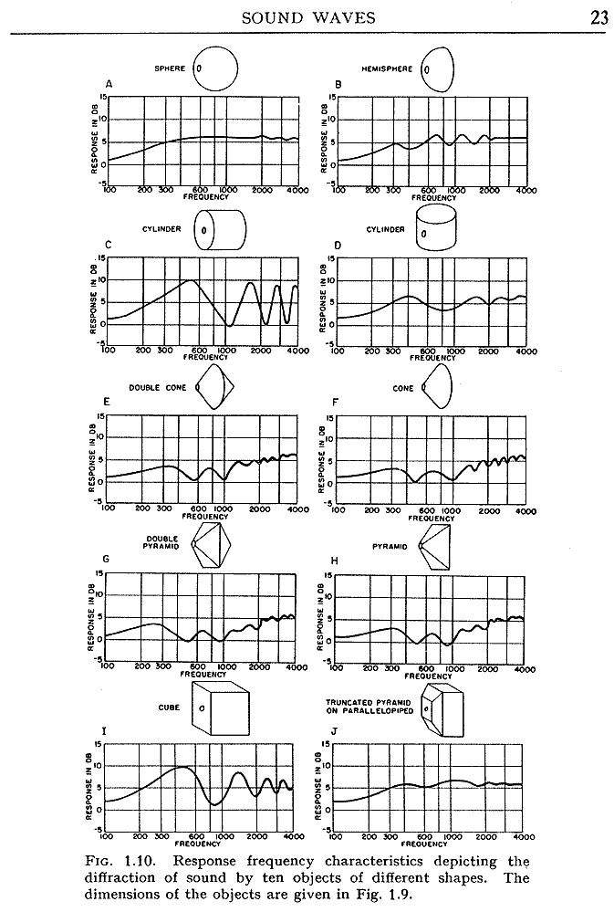

OK, baffles. Everything's a compromise -it simply depends which you select. Step-loss is not quite the same as shape, so I'll briefly deal with them separately.
Step-loss is well understood & related to width. The transition from 2pi to 4pi radiation space, and the apparant loss of SPLs below this point at the listening position (due to less energy being directed forward) occurs at a frequency which is determined by 4560 / baffle-width in inches. Adding an extra baffle wider than the front of the cabinet allows you to push step-point downward to a point where cabinet gain takes over, the two cancelling each other out, without needing electrical compensation etc.
Baffle shape and it's effects are a different issue, and something Ron in particular has put a lot into over the past few years. First up, attached is p23 from Harry Olson's Acoustical Engineering, which shows the effect a number of different baffle-shapes can have on a wavefront. In addition, wavefronts tend to take on the shape of whatever it is they happen to be travelling across. Ergo, a baffle can (indeed, it should) be regarded as a separate transdusor in its own right, with it's own main and secondary sources of radiation. We can use this to our own ends if we wish / have the ability (that's where software like The Edge, Ron's private stuff, and the new versions of Martin's MathCad worksheets that he's currently working on come in). Because to use one example, we can use the baffle, as well as for shifting the baffle-step point downward, to help shape the frequency response of the speaker system.

I'm aware of Olsen's work, and still can't see any benefits of having round or square baffles with the driver in the middle.
Ok, I see at the last example of baffle now the connection with the square baffle recomended for FH, but what about the suggested round baffle for BIB. I tested it with my BIB and certainly I could not hear any improvement, for what that is worth, but enough for me!

Re Ron's work there is in fact no contradiction. If you re-read Ron's posts re his software, you'd note that he can't give graphs of the type that are directly comparable to those you're familar with, because it's not that sort of programme. It doesn't produce graphs like, say, Martin's MathCad worksheets, AJ Horn, WinISD or others. Ron's spent 4 decades working with wavefronts, including for military applications, so he knows what he's talking about. He has proof in the physics, but unless you know how to interpret figures relating to the balancing of wavefronts, resonances, pressure and thermal energy losses, there's little point in him presenting it, because it'd be like ancient Martian to most people, myself included. Martin King can probably follow it; I certainly can't. However, I understand enough to appreciate that it works, and for example, I've done my best to model cabinets using different flare constants for different expansions in MathCad, and things do indeed improve. It's not that surprising.
To give one example, if I understand it correctly, Ron has used a conical final expansion section in some of his cabinets like the Austins. Conical is known to produce the lowest distortion (a fact found in any physics textbook). The price though is that it is the least efficient of any horn profile. So, he takes a different approach. He uses a more efficient flare for the initial stages and a low distortion flare for the final stage, to get a compromise offering mostly the best of both worlds. That's heavily simplified, but you get the idea. Sneaky, huh?
Re the baffles, as I explained, in general terms baffles can be used to adjust step-point, and to significantly tailor the frequency response according to what you want to achieve. The driver being in the middle is neither here nor there -you place the driver in what's optimal for a specific driver / cabinet / baffle combination.
The round baffles were more a homage to TC than anything else. The BIB generally doesn't benefit massively from them, though this varies according to the driver / cabinet / baffle combination and shapes. Some drivers beam more than others, and the surface wave / wavelaunch can have less obvious effects than other combinations. YMMV as ever.
