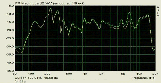

OK, so let us have a look at Ed's own measurements: http://www.audiocircle.com/circles/index.php?topic=44701.0
Attached is also a sample of my measurement, in a small room with no proper corners.
SveinB.
Svein_B said:OK, so let us have a look at Ed's own measurements: http://www.audiocircle.com/circles/index.php?topic=44701.0
Attached is also a sample of my measurement, in a small room with no proper corners. SveinB.
I rest my case.

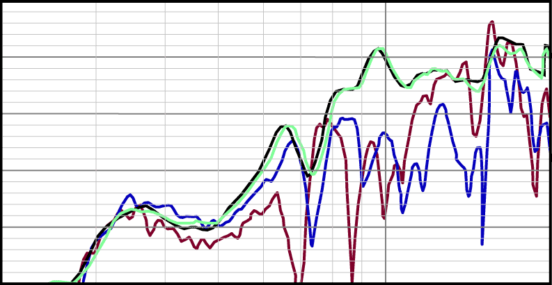

Here is a comp i did of Ed's measures that gets the scales the same. Ed was quite specific in saying, listening to the speakers not the the measurements. Sill if one ignores the ceiling height suckout, useful response to 65 Hz or so....out of the corner, no better than an mFonken (but with better dynamics i expect)
What is really useful here is the comparison of corner/no corner.
The curved mouth/deflector gives the FH an edge on the Ed Horn (BTW Ron did a deflector for the EdHorn too, but it was poo-pooed by Ed and has mostly been ignored), Ron's estimate being something like 10-20 Hz. Listening in Chris's room with speakers properly in the corners suggests usable bass to 50-70 Hz.
It will be very interesting to see what Martin comes up with when he measures the FH. These measures (& the extra capability of Martin's models) were always intended to help develop a better, 2.0 version of the Frugel-Horn -- that does not negate how enjoyable the current FH is to listen too)

Here are those same JA measures overlaid with a sim Martin did of the 1st experiment that lead to the Frugel-Horn (the modified Buschhorn on the last page of the FH plans). All the ripples in the same place strongly suggest that the modded B-Horn is substantially the same (in the bass) as the Hornshoppe Horn. Until someone takes a chainsaw to a set of Ed's Horn we'll never know the detail. It is moot anyway -- at least to me -- the FH sounds better than the modded B-Horn (no comparisons yet with an actual Ed Horn).
The 1st alpha build that lead from that was a better sounding box than the modded B-Horn, but should have similar bass extension (8% more mouth and not quite as severe an aspect should give it a bit of an advantage). This would be equivalent to the Level 0 build of a Frugel-Horn.
