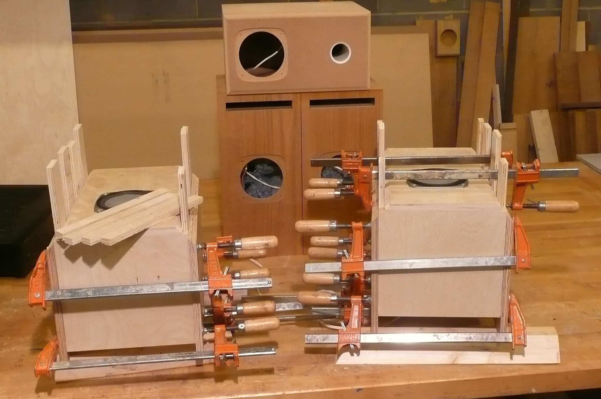

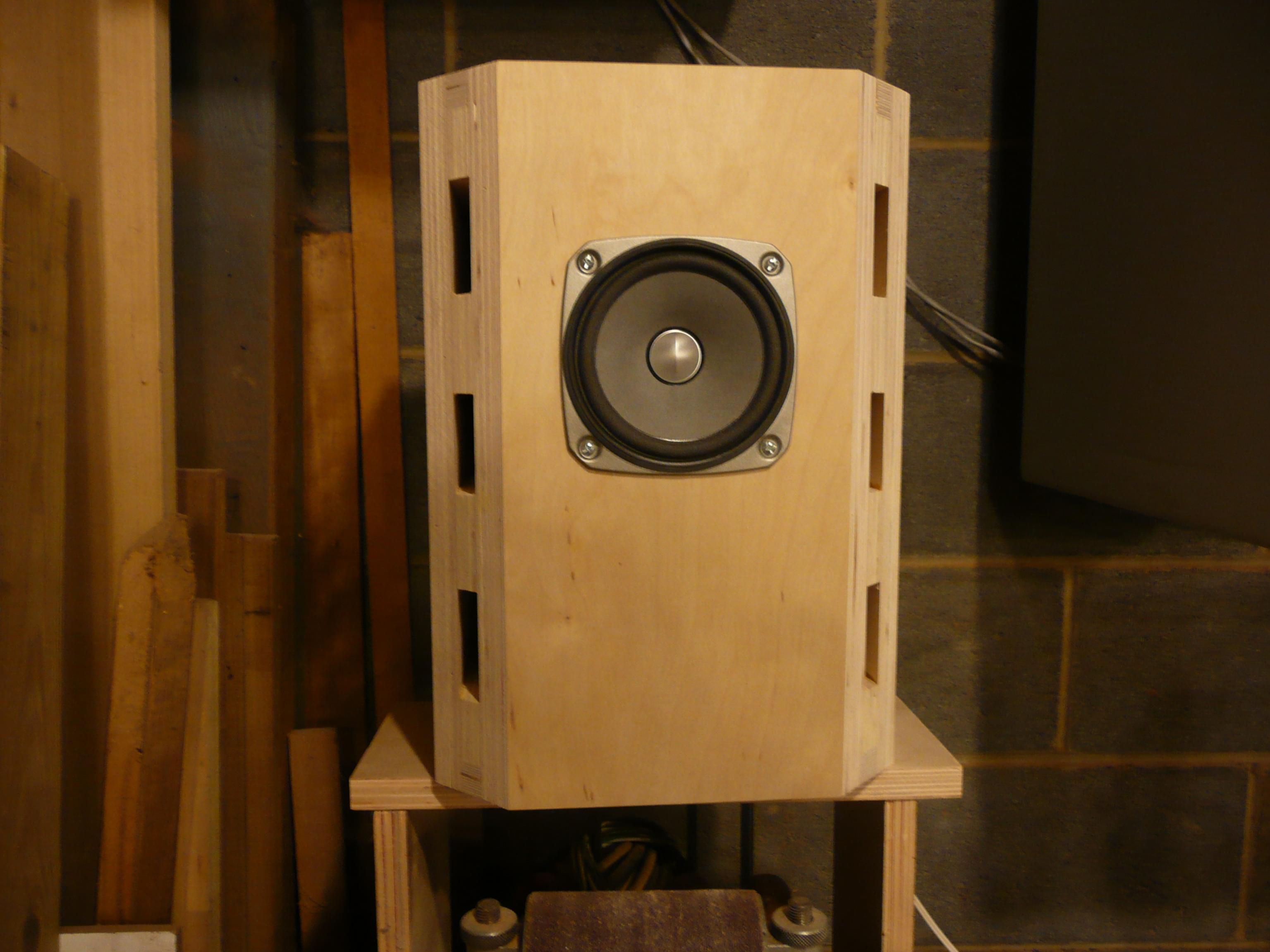

The pic is too long a story to type, but I have about 100 hours of building time for different boxes (the single BR box design is from Fostex).
The boxes with the clamps do not have a name; it is just a look-a-like.
Tuning continues today by changes up the strips and A/B testing; this is working pretty well; the volt meter readings are “soft”, so hard to pin point the Fs.
I'm really enjoying the 125wks, they sound very nice, natural, could use a bit more bass, hoping these boxes help/work; which are larger than the single test, BR Foster Box (with PCV).
You'll want break them in, they have a "secondary" sound right out of the box, it will go away though.

Results of yesterday’s tuning
Results of yesterday’s tuning, I found out one thing, its not that easy; larger strips will push down the Fs, however that reduces "vents" at the same time ~ which defeats the purpose....I don't how they design them on paper, my hat's off to the few that can design them. Maybe there is a vent calculator <kidding>
Investing in verified plans would save a lot of time, trouble and wood; of course, buying a pair is an option.
I do think these are the ball park; they sound very nice and a hint of bass, more than the previous BR boxes. There may a dip higher up, around 100hz, according to the modeling.
IMO, the imaging is the main event with full range. You can stand 6' in front of them and can not tell where the music is coming from.
I would expect the length of the ports to be more effective in tuning, but more difficult to manipulate.
