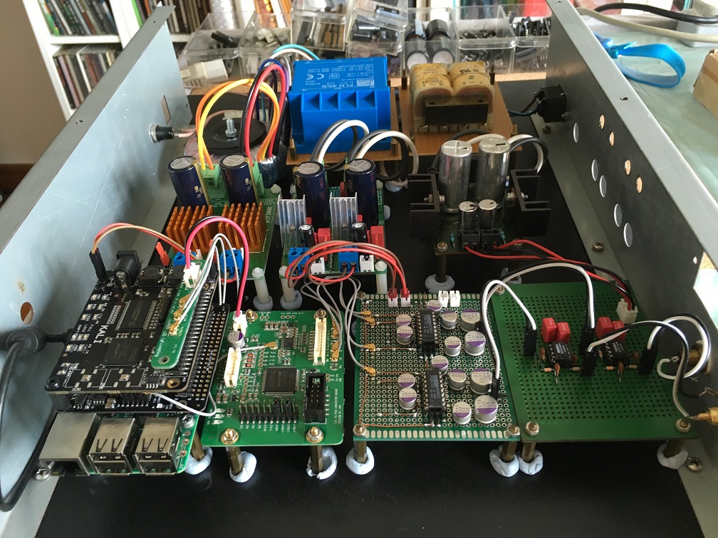

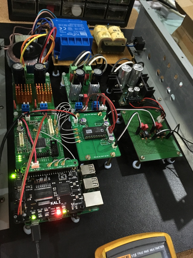

Hi everyone,
I posted on another thread, but I think I better try asking here.
http://www.diyaudio.com/forums/digi...1-fifo-universal-i2s-pcm-driver-board-89.html
Recently, I assembled a dac with the following hardware combination with no luck.
Volumio - Rpi3 - kali reclocker - ian pcm board - AD1865/PCM1702 board - opamp IV
I did checked for dc offset at the output before inputting a 400hz signal (from youtube thru volumio). The frequency measured thru DMM doesnt show a 400hz, but it shows frequency fluctuating at a few thousands hertz. Out of curiosity, I connected it to my amplifier & speaker, only to hear pink noise.
Assuming i2s data (with mclk) is a standard, I wonder if anyone have tried connecting kali to ian pcm board?
I have no problem connecting the kali i2s data to TDA1543/passive IV. It is playing music, but the output level is low.
Cheng
