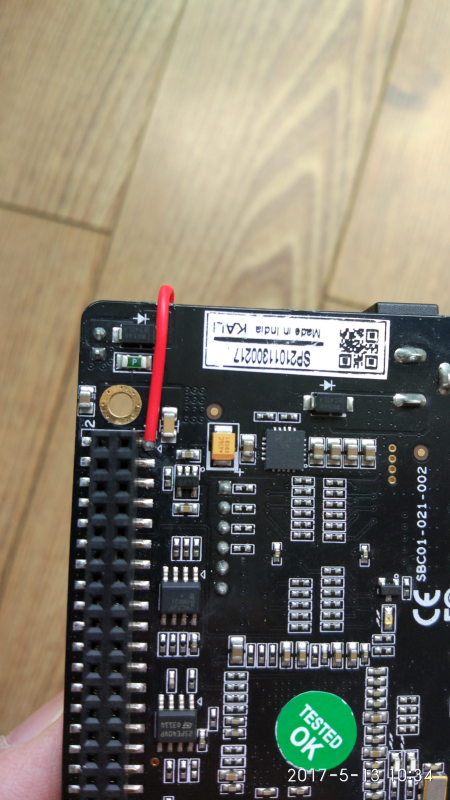

My i2s to aes card need 3.3V.So I get 3.3V by this way!
But I have some problem.i2s to aes card wm8805 work on MCLK rate of 512fs, 256fs, 128fs and 64fs.when I play 44.1/48 with Kali Reclocker,MCLK rate is 1024fs. So it can't work, until It resample to 88.2/96 .
Can you find a solution to this problem?🙂

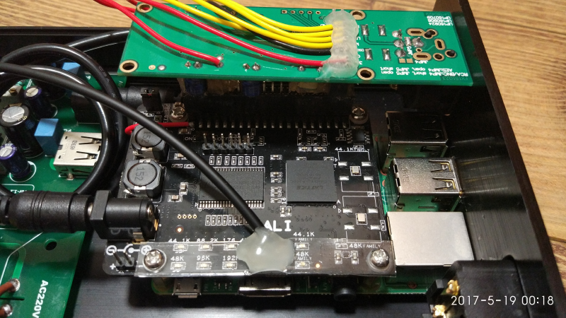

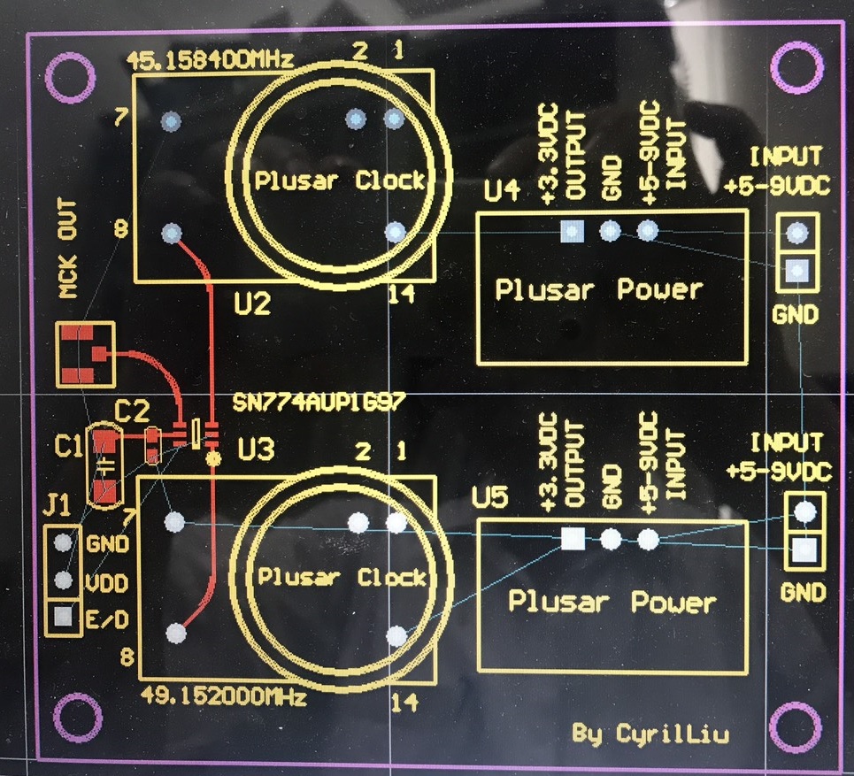

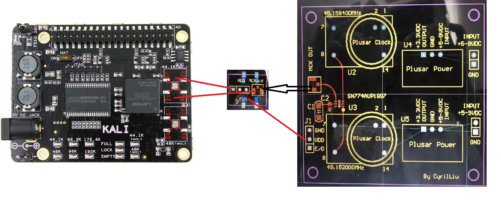

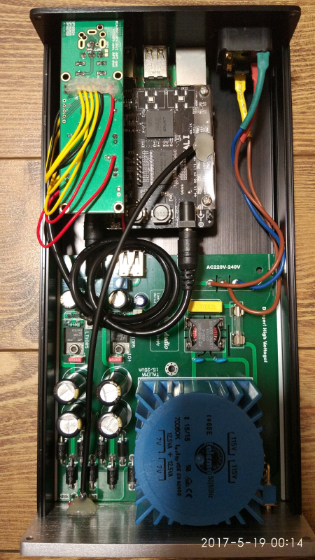

A external clock board for KALI is in progress.
Wow, 🙂
It could be also keeped for less expensive Crystek CHD-957...
Why not just make one board to avoid the uf-l wire which add jitter on its own (around 190 pico second by 1" length, so 0.8 nano second with a classic 4" uf-l cable) ?
With the two pads on a main clock board but on the upper left corner to allow to stack it with soldering on the Kali board ? (I saw IanCanada makes plain board with empty space : for instance the MC Clock where the 3 LDO regs have empty space around it but the side towards the Inside of the board of course"
https://www.flickr.com/photos/135181977@N06/34857119345/in/album-72157681347089082/
(By the way I even ask myself why Ian don't allow its MC Clock to be stacked by direct connector on the MC Fifo to avoid flat cable and uf-l cable ?? maybe there are not pins or plugs matched at 50 ohms ?????.... but as the flat cable for I2S is not so common, why not ?! : just make the flat connector bigger for the MCLK signal near the I2S signal and overlapp the boards by stacking to reduce the EMI surfece and added jitter by length of the cables ?!)
But it should be very difficult to design, draw and solder with stacking !
I find the little adapter and clock-board pcbs very sumpathetic, asking myself if I could use it with the ANdrea Mori adapter for its OCXO Discroll board as well (dip 14 format as the Supra clock, the Crystek Ian's adapter, or Andrea Mori TWTMC afdapters made for Ian's clock board II)...
Very good Job Cyrilliu, bravo !
You need to dismantle the NDKs on the Kali or just cut the traces towards the biggest soldering trace ?
If CDSGAMES allow vias on the KALI II traces XO areas at the size on a DIP 14 spacing it could be even easier to fight against the jitter because the distance between the clock board and the final Flip/flop chip (I assume fifo chip can not do any thing after itself to fight against the jitter after its outside while the flip/flop is slaved by the clock yet ??? Sorry btw if I missunderstood !😱)
regards

The four clock pad on KALI is in compliance with the Crystek CCHD-950 specifications, so I have to make a back side of a small adapter board equivalent to a back side of Crystek CCHD-950 (SMD). This is why there is no way to use a single board to complete the main reason for the external clock board.
I will need re-solder two clock on KALI before I install the small adapter board.
I'm not sure the CCHD-950 is a good swap vs the NDK, but the better CCHD-957 maybe ! And of course the OCXO from Supratech is outside the competition for people who can afford them.
To me the CCHD-957 sounds not harsch has some have pointed out, it just is very transparent with a low noise floor : all is about the layout and the decoupling caps and powersupplies arounds. At least with the TDA1541A, I just don't know with an ESS chip or SD family chip !
