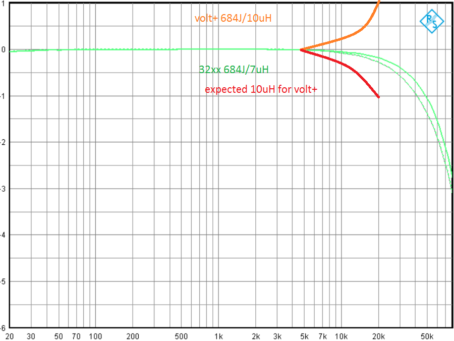

A TI published 4 ohm frequency respons for 684J filmcapacitor/7uH inductor and equal snubbervalues, with in orange the volt+ latest shown respons and in red the location I would expect it to be.

The first measurements you posted where absolutely nonsense, and no-one at your team checked that before publishing them.
You compare your measurements to the EVM data but do your measurements at a different gain level. You simply can't compare this data directly.
If your board has better performance than the EVM, kudos to you and your team.
Getting kudos simply needs a minimum level of scientific work or proper engineering.

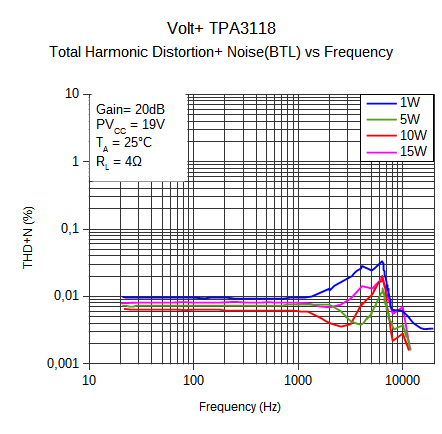

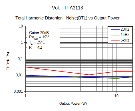

One thing really makes me wonder. From your measurements the Volt+ has decreasing THD+N with increasing output-power, how does this work?
I don't see any aggression in my comment from a German point of view. 🙂
One thing to note:
It seems that the channels where swapped for the 5W and 15W measurement, as they measure worse on the other measurements.
1W: Ch2 worse
5W: Ch2 better
10W: Ch2 worse
15W: Ch2 better
Anyway i'll compile some data to see the performance more clear.
Yes , the first data I published was sent from testing team and I publish it without checking. I simply posted the data
Second yes you are right you cannot compare , but you could admit its a good implementation .. thats all that I have been asking.
Third you say that its "strange" to see that THD+N is increasing with W ...ok lets check a bit from engineering point of view.
1W highest THD. Could that be explained by the fast that we used 4ohm termination instead of 8ohm as we designed the filter ?
15W---second highest Ok that checks
10W-5W data is very close but under the 15W.
Higher levels THD+N On 5W the higest (0.015) and on 10W is 0.02 (so it checks)
Lower levels THD+N : Could it be that at levels of 0.007 vs 0.0055 anything matters including RF, temperature skews , common mode noise ??
