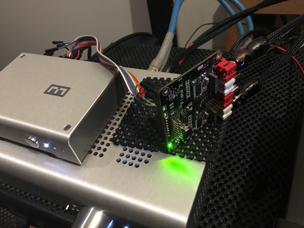

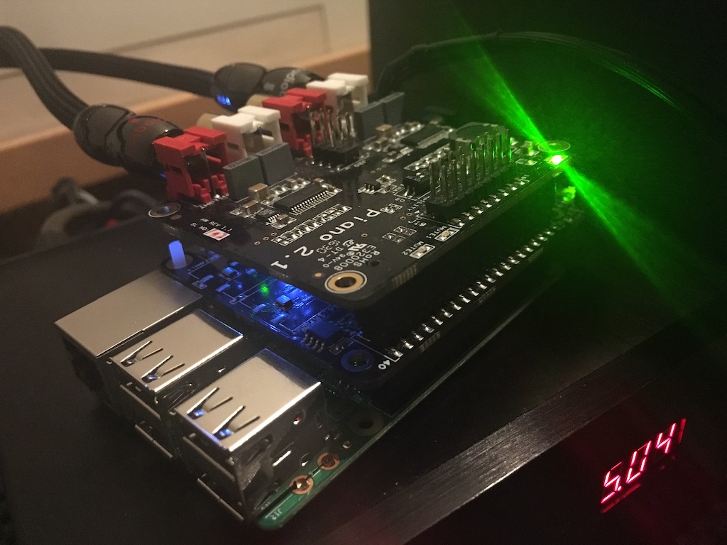

Experimenting with the Piano a bit...
i2s w/(MCLK) straight in (no pi)
Interesting thing is both Dac chips are active... less load on the LT3042's ? -- when I hook right on one, left on the other?
And the generic ESS9023,384K i2s option works, and both Dac's are active...
Ioan, wonder if this is utilizing MCLK (the PLL bypass) that we've discussed, since we know the allo/hifiberry/iqaudio PCM51xx based driver does not utilize mclk, even though it is there.

Just an update on the issue of the filters: I made some measurements of the filters for the Piano 2.1 in Volumio and found that there is indeed a big drop in frequency response at the crossover points. I reported this to Allo, and they are in the process of revising the filters.
Sckramer , yes all our drivers use the MClk. Jonners seems the issue is with TI DSP algo , we reported the bug but I bet it will take a while for TI to fix it. Meanwhile we just changed from LR to another filter. Last I heard it was working fine.
