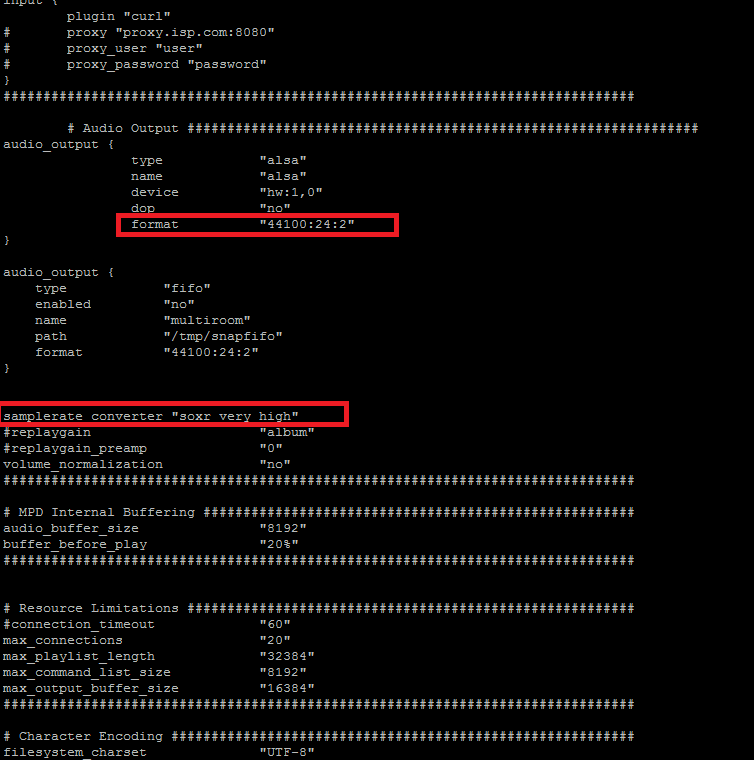

I have recieved my Kali and rpi3 and am now testing it with volumio 2 connected to a dddac with the pcm1794.
I ran into the problem that it puts out mono signal on flac files, mp3 plays in stereo but flac only mono. This makes it fairly useless for my 99% flac music collection :(
I am a linux-software noob but I understand this can be solved by using the right drivers-kernel? I just need to know how to do it on volumio 2.
Is there anyone that can help me fix this?
The problem is missing 24 Bit output, has imho nothing to do with FLAC (but I guess your FLAC files are with 16Bit format and are therefore played with 16bit). DDDAC needs 24 Bit signals. With Odroid and Volumio 2 standard installation, the redbook audio (44.1K / 16Bit) is played with 24 Bit, so everything works fine with my Odroid setup. But I have faced the same problem in the past with Volumio 1 and RPI B+. I think you would face the same problem without Kali in chain. The problem has imho nothing to do with Kali. What you can do is to force 24Bit Output with resampling option with modified mpd.conf.
Attached you can find the needed changes in mpd.conf to force 24Bit output. Note that you have to adapt sample frequency to your audio files format to not have a resampling but only 24Bit instead of 16Bit output. In my example the sample frequency is 44.1k...

I can concur that using this RPI-DAC I2S driver solved my redbook Audio related problems with RPI-Kali-DDDAC combination. I'm using Moode Audio 2.7 as player sw. It was an easy fix for me, as I didn't have to tamper with Linux code at all.

Yes it is only on 16bit flac files, all 24bit files are playing fine.
Thank you for the tip, this works!
I assume on top of the 16bit it is filled with 8 zeros up to a 24bit word? Or is the file resampled to 24 bit?
Stefan
A slightly better solution would be to use this:
Code:
format          "*:24:*"
This way you don't mess with the sampling rate, only with the bit depth. And yes, going from 16bits to 24bits means padding with zeroes, so no actual re-sampling is performed.
