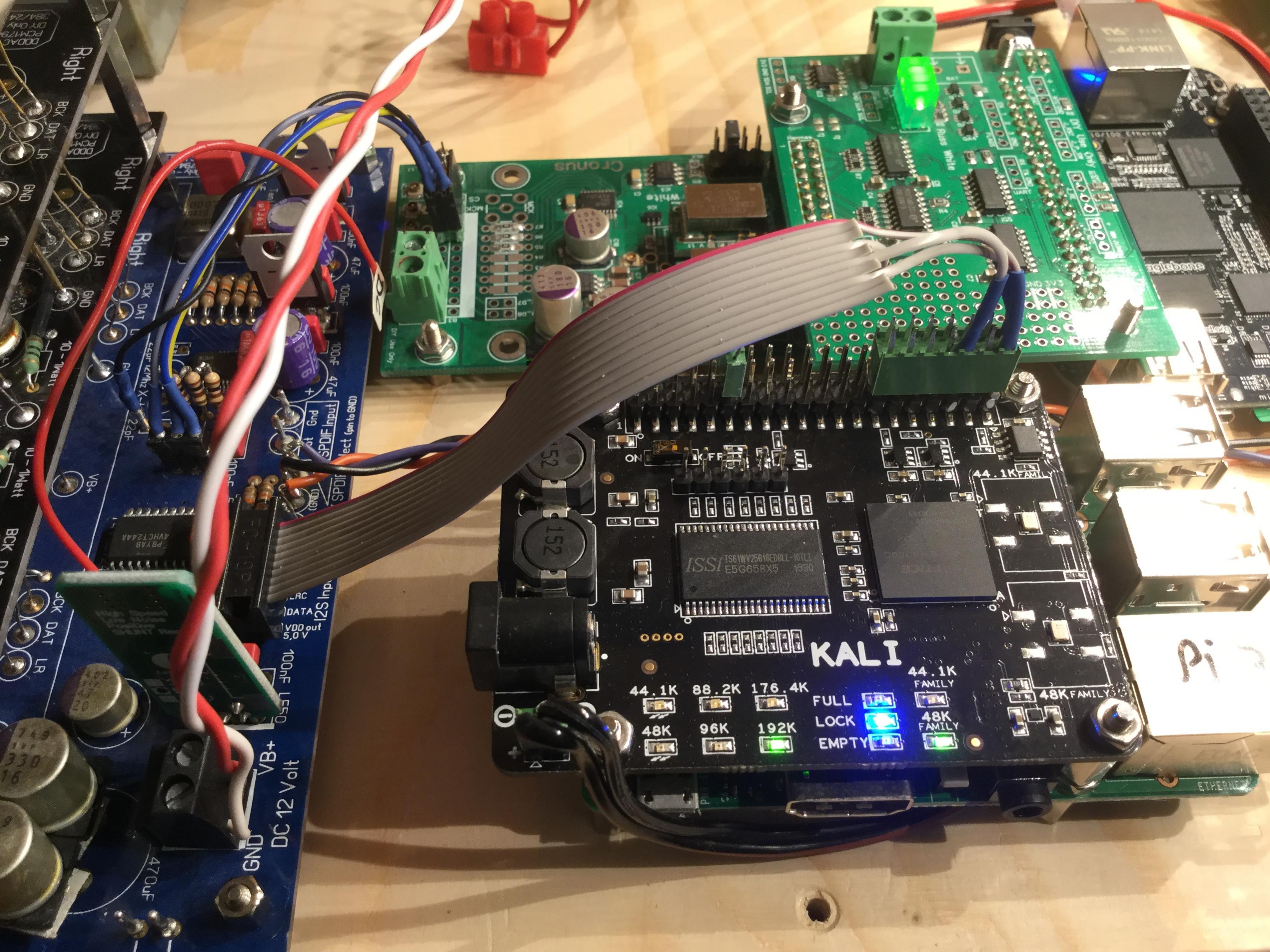

sorry for the late response. My setup is Odroid C2 -> Kali -> DDDAC. DDDAC is powered with choke PSU (Lundahl 1694 in LCLC setup). Kali is also powered with this source. Odroid is powered with DDDAC standard PSU with Rcore. I've a single decker with tent regs and CCS mod and Silmic caps on the DAC board. The Kali is is a very good upgrade. The stage becomes more defined and better microdynamics. Everything sounds more real and subtle. I've also tested the same setup with additional isolator between odroid and Kali to prevent the ground connection between Odroid and Kali. I'm using the IL715 for that. Unfortunately this was not running from beginning. Had to add some resistors in the wires between isolator and Kali to get kali to Lock mode. But I cannot hear differences between with and without isolator in this setup.

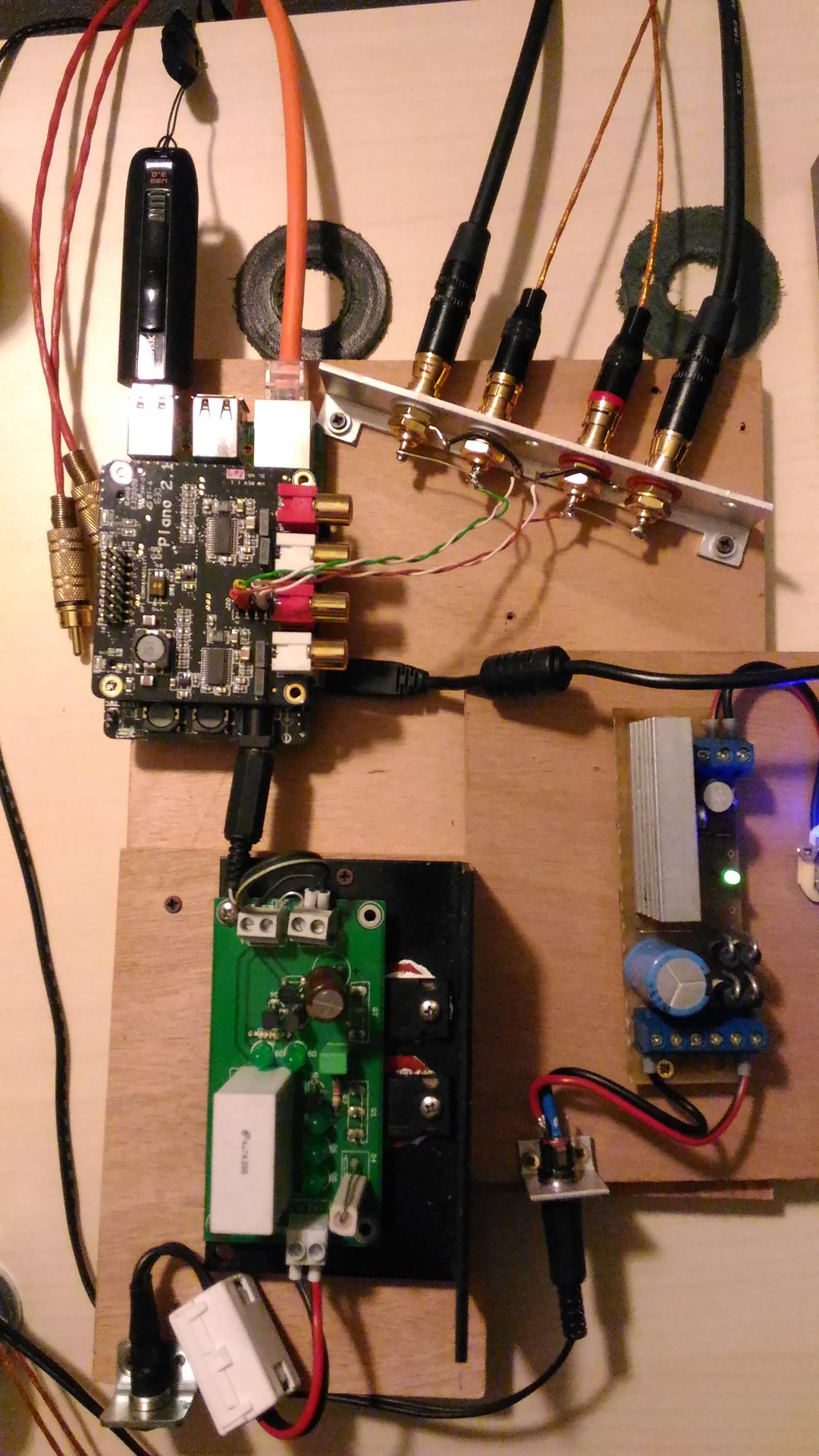

Hello,
my first test with Raspberry Pi 2- Kali-Piano 2.1
I'm using Runeaudio.

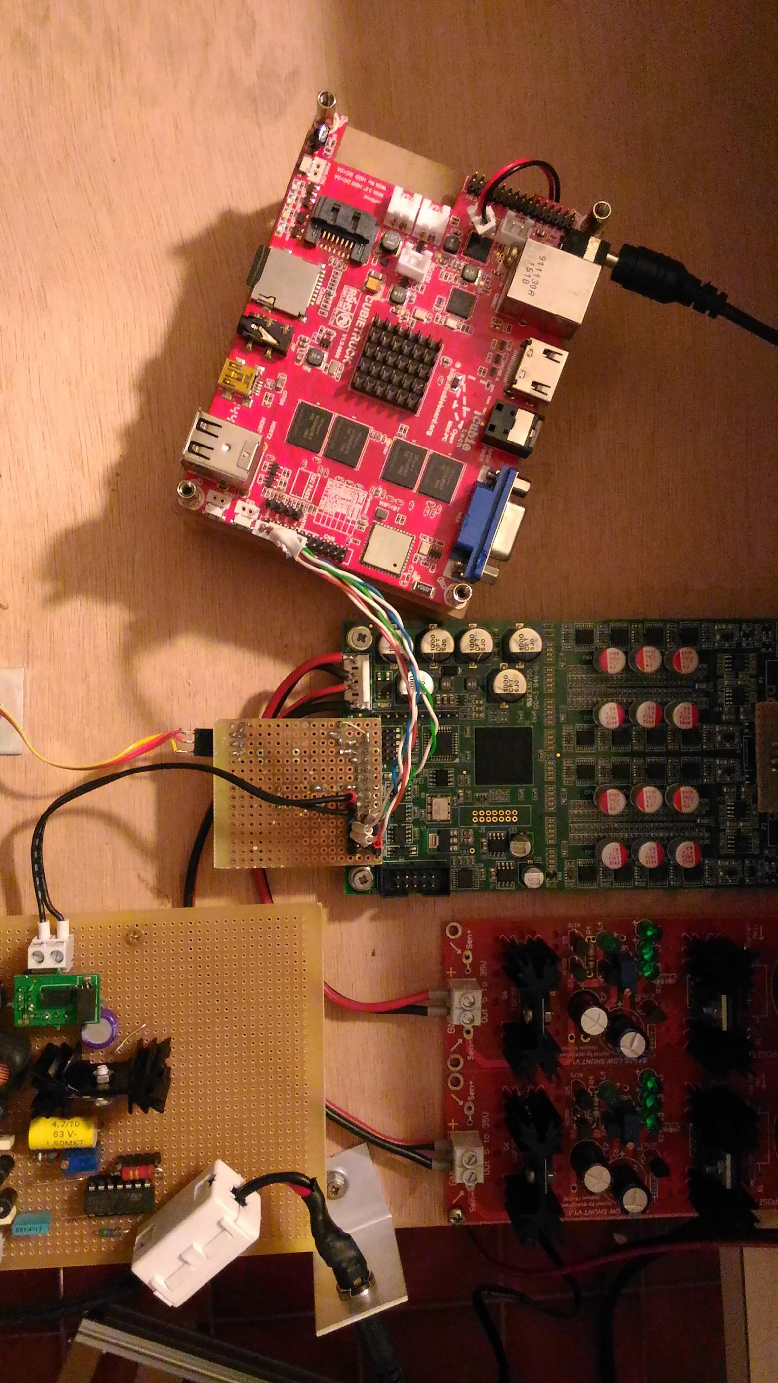

My usual front end is composed by :
Cubietruck + Runeaudio => I2S => DAM 1021 => biamped dipole speakers
1st test:
Raspberry Pi 2 + Runeaudio => Piano 2.1
works well like my ES9023 I2s Dac. Normal life and air. Correct for the money.
2nd test:
Raspberry Pi 2 + Runeaudio => Kali => Piano 2.1 Better life and air. It's easy to ear the difference. Very good value for money.
Raspberry is powered by linear LM1085 PSU
Kali and Piano 2.1 are powered by Salas shunt PSU clone
At the moment, Cubietruck + Runeaudio => I2S => DAM 1021 are at another level of life, air and space but my next step will be:
Raspberry Pi 2 + Runeaudio => Kali => Dam 1021
and may be:
Raspberry Pi 2 + Runeaudio => Kali => Diyinhk PCM1704 DAC
