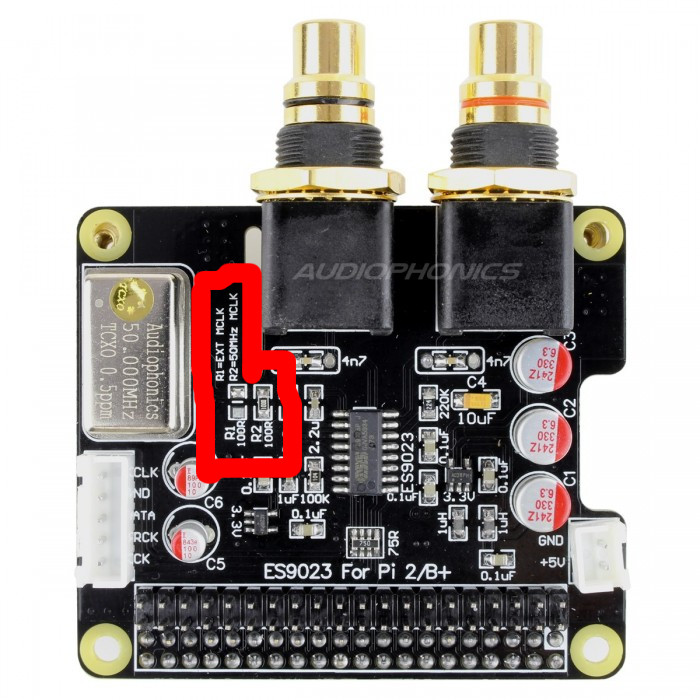

Further to what Greg said about the Mambo, with the Audiophonics.... you just move the 100R resistor from R2 (enable on-board OSC) to R1 (enable external MCLK) position if you want to use external MCLK.
