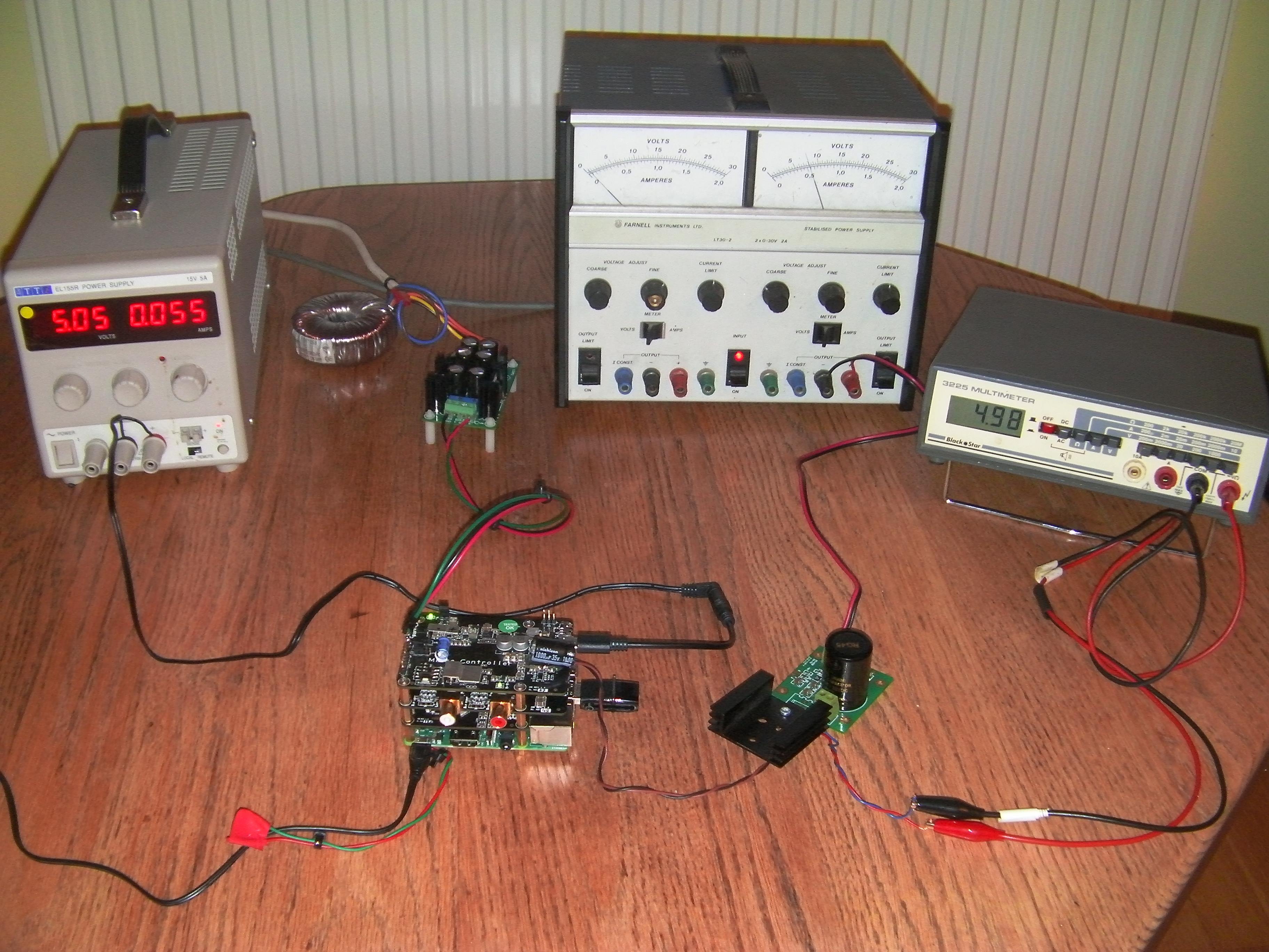

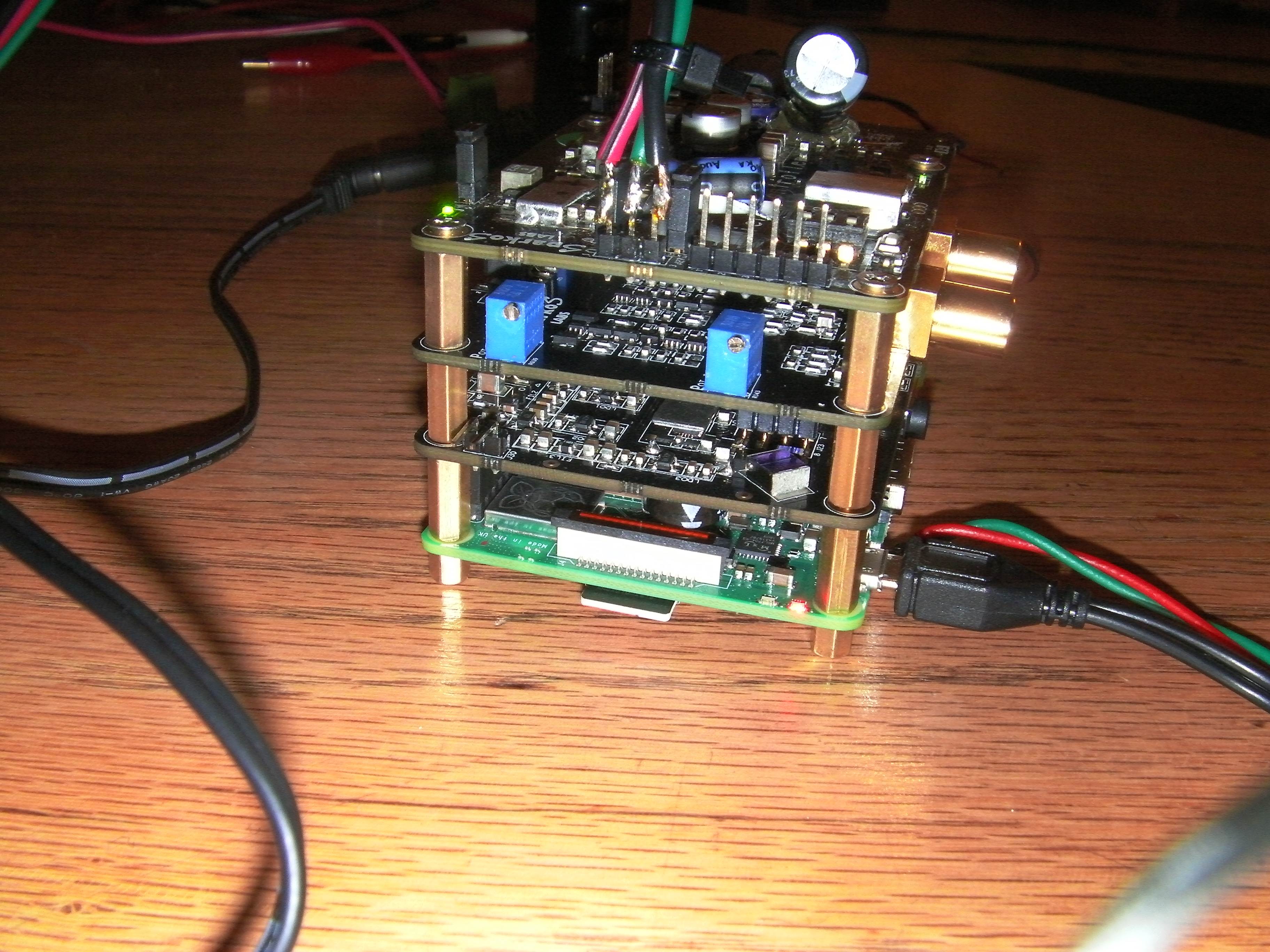

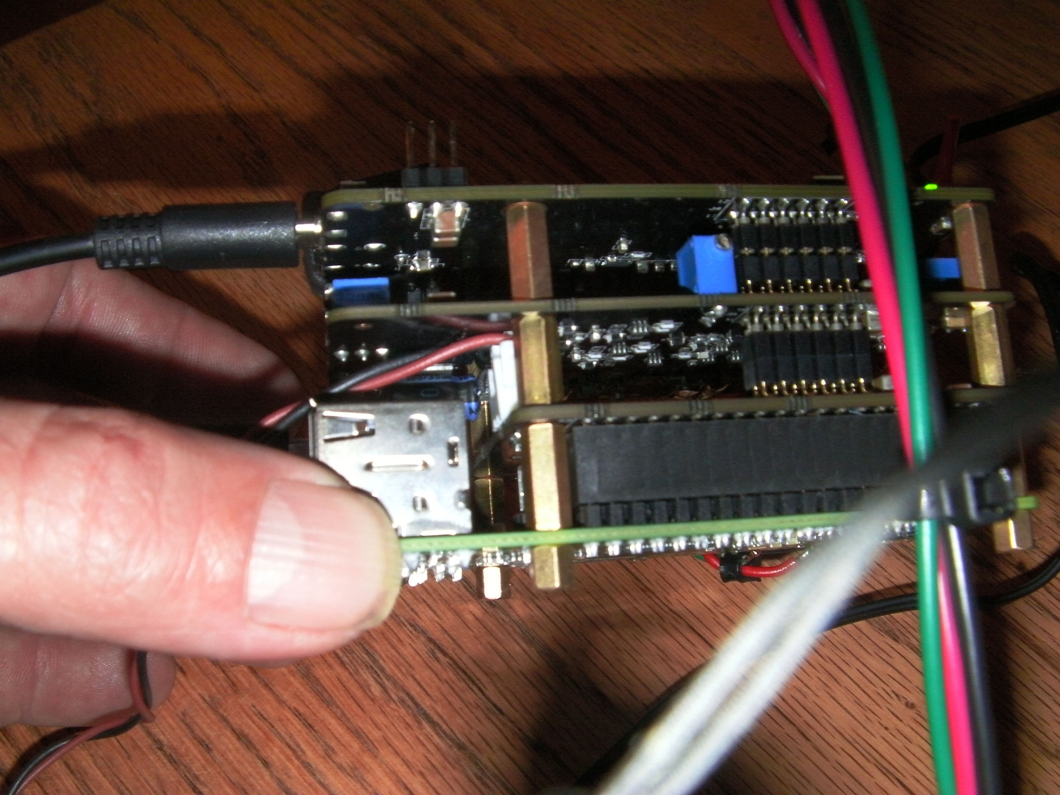

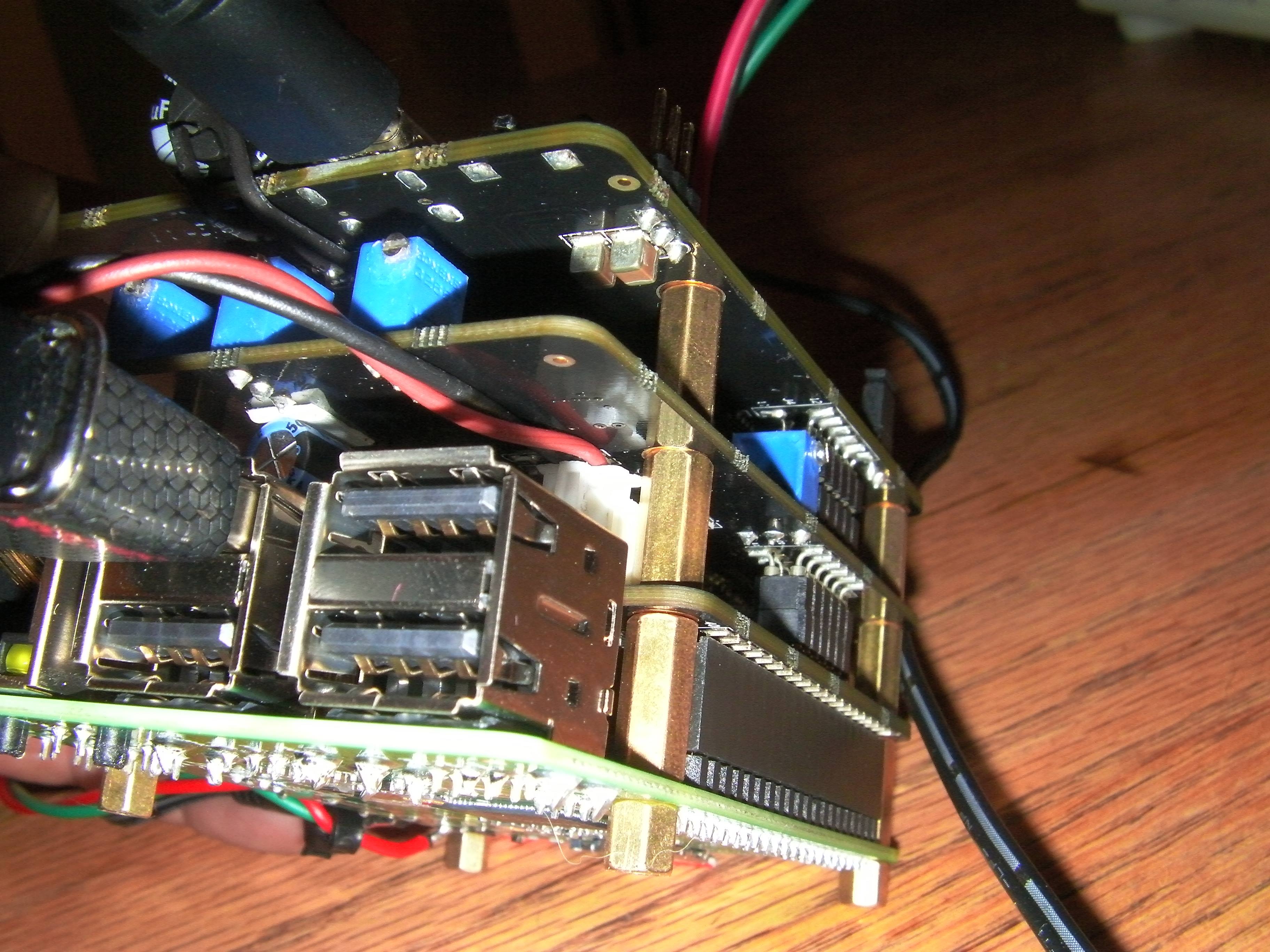

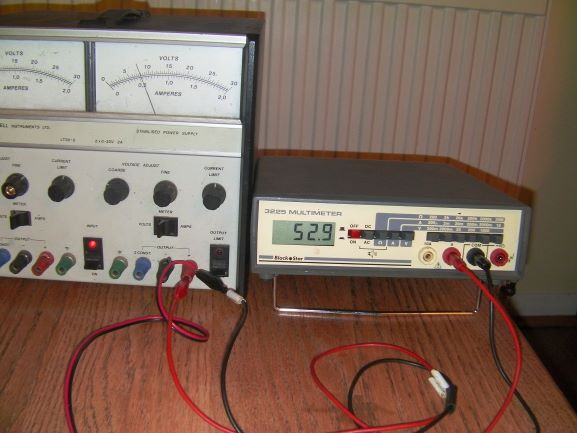

OK here's some pictures of the setup as it was when the Katana failed:
SANY0669.JPG)
From left to right, 5.05 volts feeding 55mA to the Microcontroller then a TP split rail +/- 15volt supply feeding 73mA per rail to the J27 feed to the Opamp board. The big Farnell PSU is supplying 8 volts at 59mA to a LT3042 regulator board with a 3 Amp capable pass transistor. This is fed to the two pin connector J31 on the Katan board.
The power LED is lit on the MC board but the status LED is blinking at speed. The power LED on the Katana never lights at any stage in spite of its board drawing 52.9mA.

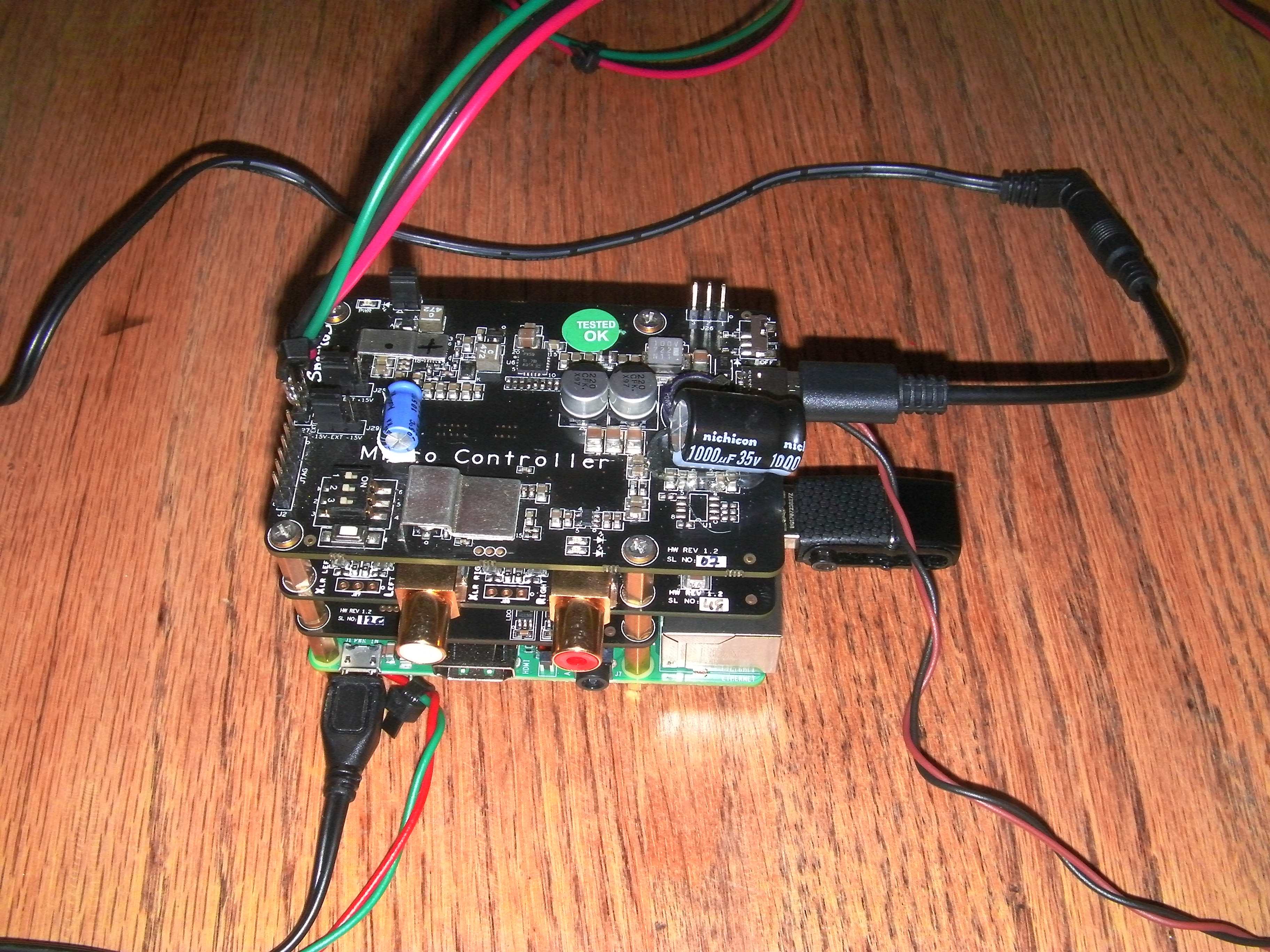

Here's a picture to show the jumpers on the MC.
J30 is open and the polarity of the feed to the Katana board has been double checked.
I now have two useless Katana stacks for repair and no understanding of how this can be done or how to prevent it from happening a third time.

@John Luckins
Clarification requested on J27 wiring on micro controller board for +/-15 V external op amp supply.
My actual measurements show a startup peak of about 98ma and then settling to 89ma on the 15V rail for an external supply.
For J27 Pins 1, 2 and 3 how is the external +/-15V sequence connected/soldered to these pins. Did you follow the board designations or the Katana manual?
I tried sorting this out by looking at the pictures but the required details/angles were unavailable. Thanks

Yes and Yes Mark. USB-C was unchanged from previous working config. After the first failure I triple checked the Katana feed polarity.

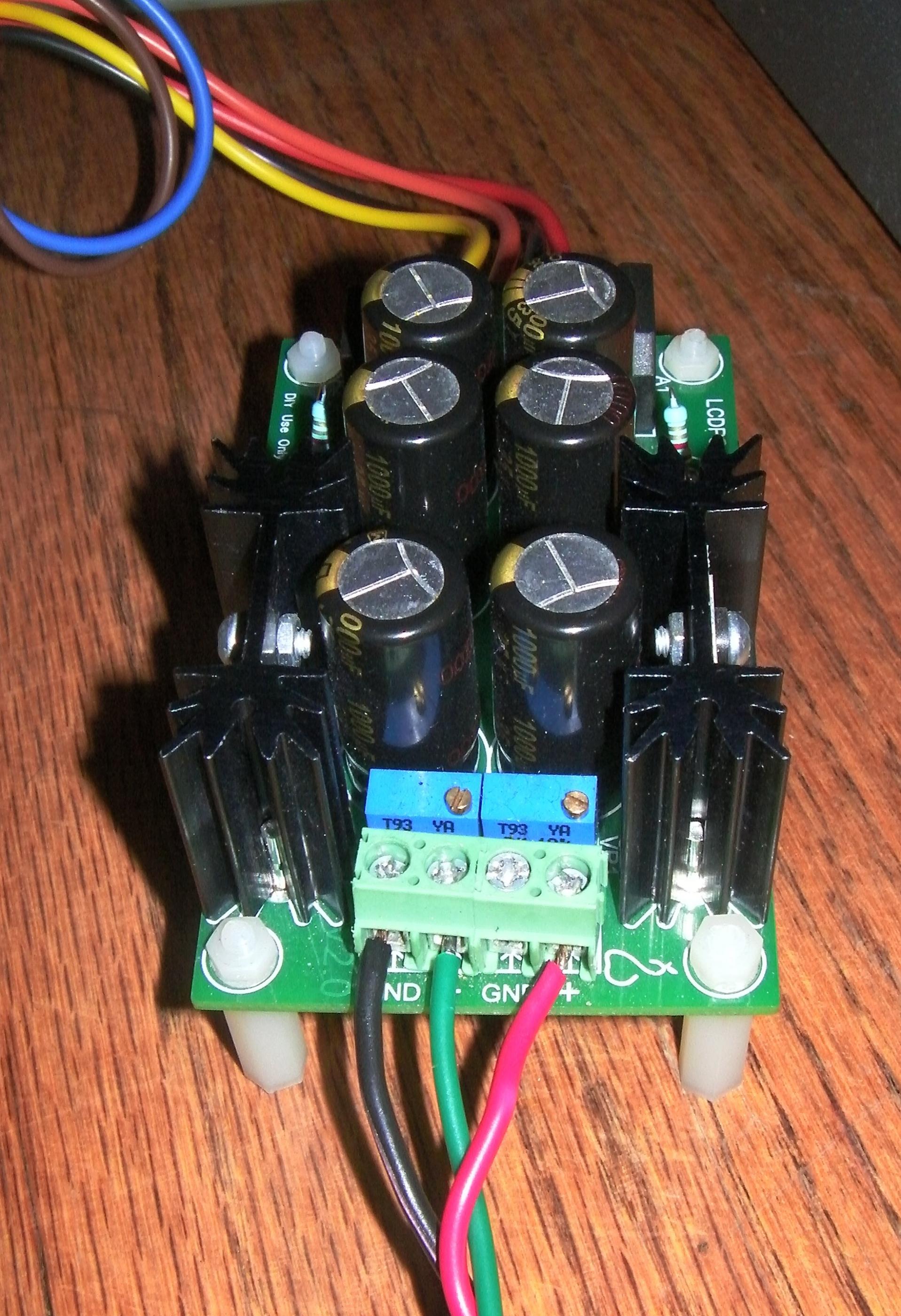

@John Luckins
Thank you for the clearer pics.
I am assuming that the pics represent the configuration at time of "failure".
The Twisted Pear LCBPS in the pic shows a 4 terminal strip with the following being used. Blk wire to neg GND, Grn wire to '-' ve and red wire to '+'ve. GND on the '+' ve terminal is spare.
On the micro controller J27 you show Red wire on Pin 1 which is +15V in. Grn wire goes to 0V which is Pin 2, Blk wire to Pin3 which is -15V.
Looks like the Grn and Blk wires on the LCBS are reversed. Have a look at the LCBS documentation for the layout as the current Twisted Pear documents do not show the version of board you have.

Hi ktham
All helpful questions to at least ensure that I'm not going potty here.
Yes that was the config at the time of the failure of the second unit.
The LCBPS is a dual LM317 regulator. From left to right its outputs are GND, +. GND, +. By connecting the two centre output terminals together and feeding it from two independent secondaries it then becomes a floating 15-0-15 volt supply. Not clear even from the better photos. The black wire is connected to the most negative rail of the left hand regulator, 15 volts below the centre green wire. Red cable is connected to the most positive rail of the device, +15volt. I have verified this is so when connected to the Katana and monitored its voltages at start up. The =/- 15 volts is maintained. The unit is unchanged from when it supplied +/-15 volts to a split rail headphone amp which drew a steady 130mA.
Good point about a raised supply voltage for the 5v rails perhaps 4.97v is a bit low for the Katana feed. 5.1 is probably OK for the Micro controller and worked well in the earlier and recommended dual supply setup.
