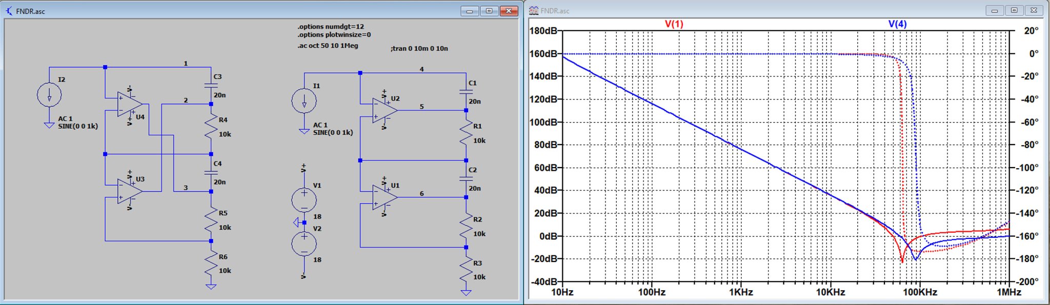

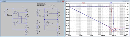

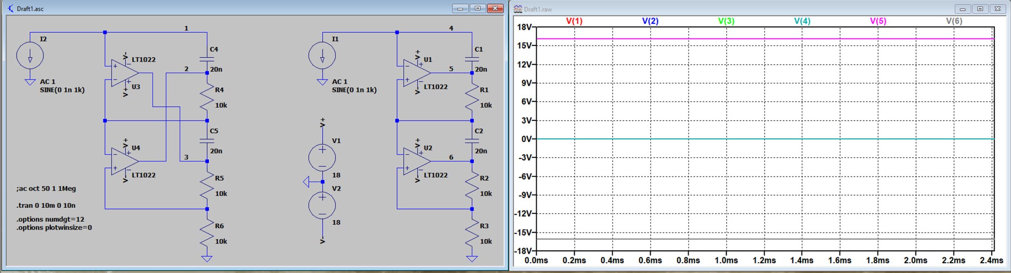

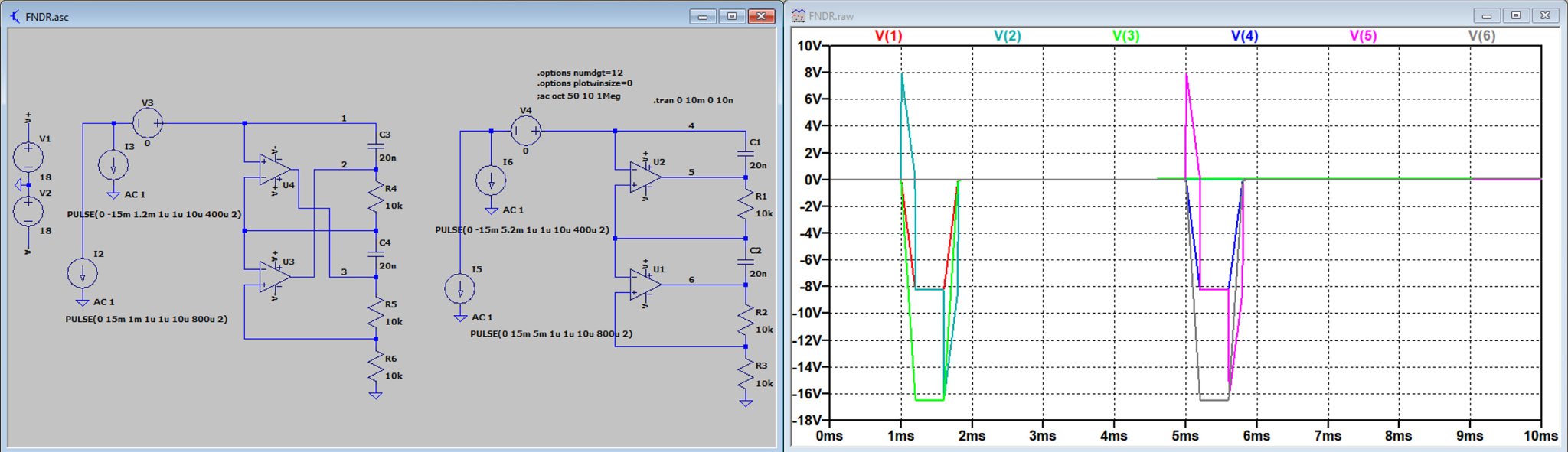

I've simulated the DC behavior in LTSpice for the circuits in #1 and #5, both drawn with the same opamp orientation just for easier visibility of the differences.
With the usual topology of #5 output is 0 Volt and both opamp outputs are at 0 Volt, resp point 1, 2 and 3.
However with the #1 topology, while the output is also 0 Volt, opamps are resp. latched up at +16Volt and -16Volt, resp points 4, 5 and 6.
So yes, #1 is stable in is latched up status, but completely unusable as a FNDR IMO.
Hans

Isn’t this single possible bias point with latched up opamps not enough to reject this circuit ?
Maybe It could be forced to latch up the opamps into one of four options like + + / + - / - - or - + where + and - are the latch up voltages, but that doesn’t make the topology more attractive, does it?

If you should want to mimic this in simulation, you could put ic=0 statements on all capacitors and run a transient analysis with a small excitation. The circuit theoretically requires a resistor and a damping capacitor from Mark's node5 (your node 4) to ground.

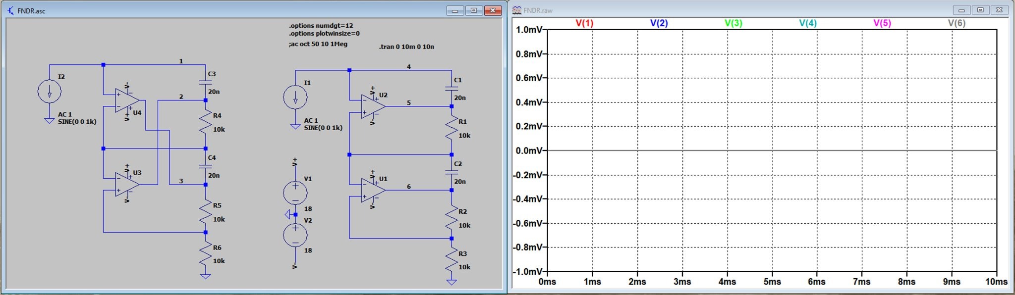

When I change the LT1022 for the single pole UniversalOpAmp2, with a 10Mhz GBW, everything changes and the FNDR becomes stable with both op-amps output's now at 0 Volt.
This 0 Volt stability stays when I add 50nV/rtHz voltage noise and 10pA/rtHz current noise and 1mV offset, worse as the LT1022 specs.
There is no way I can get it into a latched situation.
Very weird.
Hans

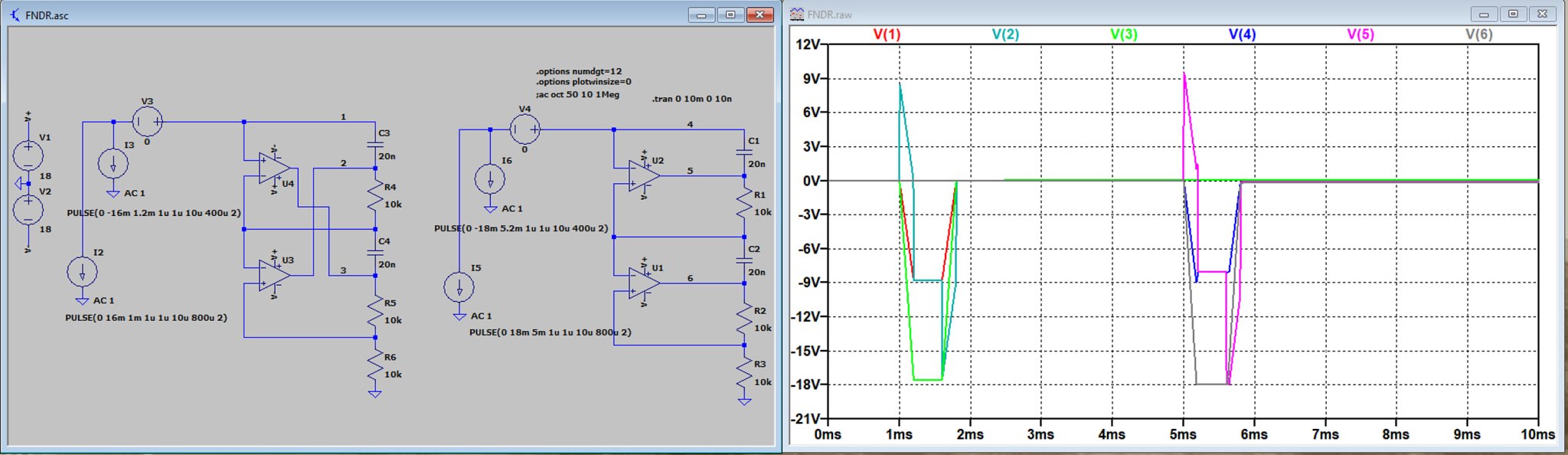

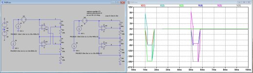

Here you are, first at 1msec the usual FNDR and at 5msec the special FNDR both short before clipping at -18Volt.
Second image is again with somewhat larger transients for the special version only, that now hard clips at -18 Volt.
Hans

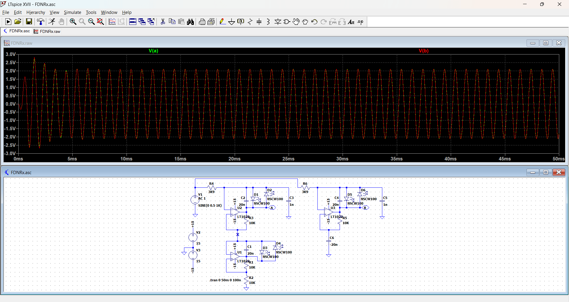

Due to the missing resistor at your node 4, Mark's node5, there is complete negative feedback through your C1, Mark's C3, around the upper op-amp at any frequency. Does that make any difference?
Placing a 3k9 resistor turns both versions into perfect oscillators.
I didn’t have the time to further investigate, will have to wait until tonight.
@mark, what exactly was the circuit you used to stimulate the FNDR ?
Hans
3k9 from a low impedance oscillator. As I've already stated the Q was limited by the opamp performance, though I didn't measure it. A working FDNR in the standard circuits shouldn't be able to oscillate anyway as its emulating something passive. It can certainly resonate though.

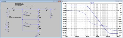

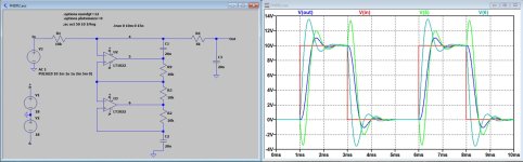

It was a rather fruitless exercise simulating the FNDR as a separate unit because results were totally unpredictable.
That's why I made a third order 1Khz T filter, think of two Coils with a Cap in between terminated by a Resistance.
Since the FNDR represents 1/s²C, when used instead of the Cap, the two Coils can be replaced by Resistors and the termination resistance has to become a Cap.
I used the original LT1022 that Mark suggested, I only interchanged the FNDR's 20n cap in the middle and the 10K at the bottom, resulting in a smoother frequency response above 100Khz.
Now with this third order filter, I can relatively simple stimulate the circuit with a voltage source and watch the response.

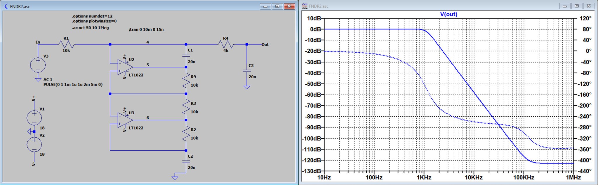

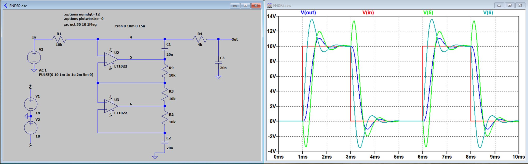

When applying a 10V input pulse the various signals are shown in the first image below.
The FR is shown in the second image.
Even when at start up one of the LT1022 was latched up, directly after applying the first pulse it came out of latch up and performed further as shown in the image.
So it is still a FNDR version with a handicap, but when it finally works it keeps working, at least in my simulation.
Hans
