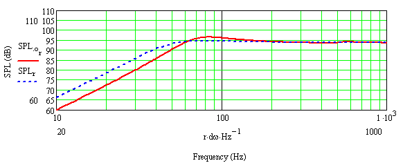

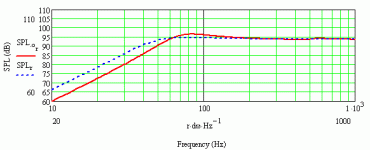

OK you could try an aperiodic standmount. 24in x 12in x 15in (HxWxD). Driver 12in down from the top, and either two of those Scan Speak aperiodic vents on the back if you're feeling lazy or make your own. Dimensions are internal. Box is damped 0.6lbs ft^3 of material. There's a slight lift below 100Hz to add a touch of richness.
Thanks!
Aperiodic vent sounds hot!
http://diyaudioprojects.com/Technical/Aperiodic/
Question: what tool do you use for that graph? I used to have an online one but I lost the link.
