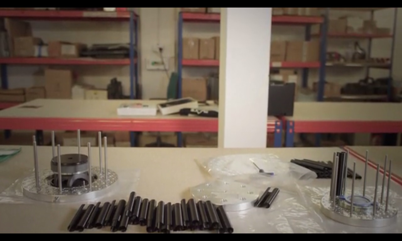

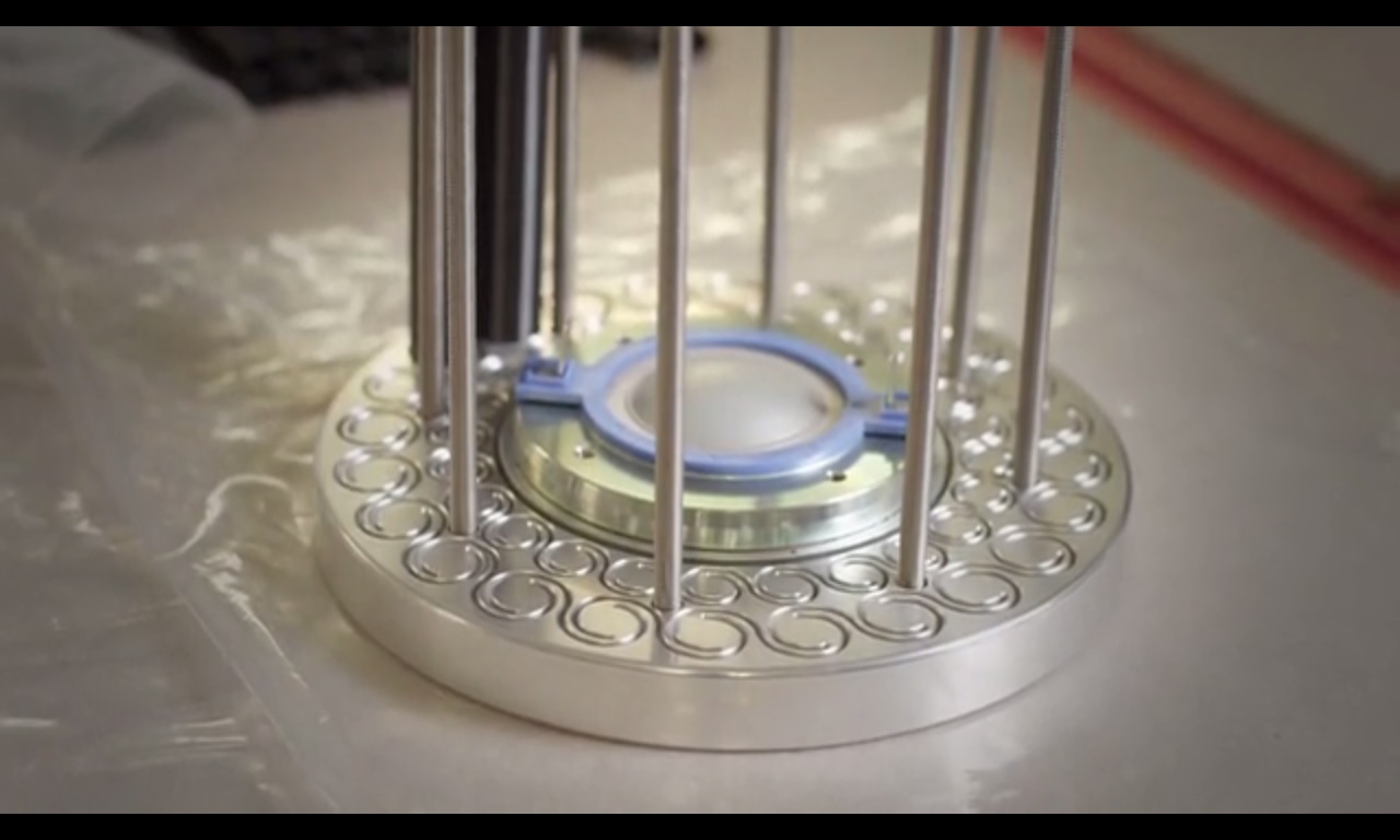

Here is the compression driver's housing for that model, as grabbed from one of Flare Audio's videos (the link I posted up before). The grooves in the metal plate show the shape of the 3-D printed cavities, the type that are detailed in one of the patents I linked to (first on I think).
The shape looks like a circular space which opens up into a gap into another, larger circular space..

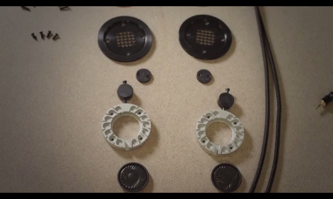

This looks like their headphone design as screen-grabbed below - would explain the wire or whatever it is in the diagram, part 171.
I would like to design something like that to 3D print and modify a pair of headphones by creating new back enclosures to directly replace the originals, perhaps on my Denon D5000s.
