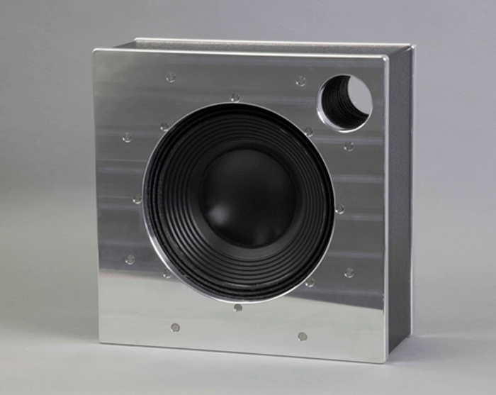

If I were to try something like this out, I'd create a layered box (but with the layers going front to back rather than bottom to top) CNC'd with the sprials cut into these layers.
It doesn't seem like BS to me - I can't see a reason to disbeleive that creating vorteces with the air flow will break up and ruin the compression waves in the air so as to make them so diffuse and mixed up, nothing remains in phase any longer. That would be my instictive take on what is going on.
Perhaps one could think of it as many small transmission lines radiating out from the sides of the driver? but instead of linear flow, the air is encouraged to spiral.
Thinking of it in that perspective, first as multiple linear TLs and then the vortex aspect, could one better imagine this working?

Imagining for moment a compression wave being forced into a space which then creates a vortex, I can imagine that a compression will eventually go around the circular apperture and meet an expansion and cancel each other out - lots of phase interference.
Depending on the circumference of the circular space and the speed of the compression wave, different ranges of frequencies could be cancelled.
The movement of air wouldn't be that restricted either so I guess closer to movement in free air?

SB12A 12 inch speaker 900 watts max - 423mmx423mmx180mm 134dB max. 18Hz-2KHz
Hoffman's Iron Law vaporized - what's in the magic box ? there can't be much space behind the woofer.
its in the patent. Someone with patience or machine to cut a few layers of MDF, etc. could get a rough idea - there's hardly a cubic foot of active airspace. Can horresp make a rough estimate? Is there "chuffing" at high cone excursions due to the tunnel cross-section dropping to around 6 square inches of area ? The maker must have adequate simulation tools.
Those small chambers would have acted like expansion chambers and slow down the airspeed quite a lot.

Looking at it in a very basic way, those "vortex" chambers probably act like expansion chambers which are acoustic low pass filters.
wonder what type woofer Flare is using ? - a 12 with maybe with 6mm xmax? maybe 9mm? Low qts ? does Flare use 18sound? B&C?, custom? - An Akabak model should tell which parameters best fit the enclosure shown. Which fullranges might make use?
If one sums up the volumes of all the "vortex chambers" as well as the volumes of the tapers leading into and out of the "vortex chambers," might the box be modeled reasonably well as a double-bass reflex?
I crashed hornresp somehow some time ago and forgot how to use DBR - akabak would be better I think for this type with a strong motor BMS C262 woofer.
xrk971 should be able to model this case easy.
here's a long vent, low-tuned, small chamber reflex in hornresp - indicates 6dB/octave LF rolloff (?)
would the good impulse response of such an alignment be part of why Flare's approach is getting good reviews?

AFAIK, its Beyma units. The one in the model shown in the previous page is likely the 12P1000Nd, since its in-line with Flare's claimed power handling.
Looks to me like the cabinet is acting as a simple bass-reflex, but maybe the little chambers are acting as an acoustic low-pass as someone mentioned previously.
Anyway, I'd expect serious port chuffing problems from such a narrow area. I don't think they'll maintain the low end at higher levels.
Try this out: https://flareaudio.com/products/sb-series/sb18c/
Claimed 135dB maximum output from a box that'll go around the driver, just, and apparently it'll go down to 25Hz with no EQ needed. Hmmm...

I believe you've nailed the woofer - 100g mms 12 class with low-ish qts https://www.beyma.com/products/lowmidfrequency/112P10ND8
regarding their 18" sub-woofer, nice to see 105dB sensitivity, 25Hz low end from an 18" and cabinet less in size than some "H" baffles with 27kg carrying weight. I have a little horn ~198 l in external bulk, maybe 105dB 2pi that might do 70Hz half power (?)

Remember the chambers aren't straight through - air enters at the edge of a circular chamber, forcing the air to create a spinning vortex - hence the name. Not sure if that kind of thing can be set up for calculation in the usual simulators?
The exits of the chambers seem to be such that movements of air flowing back and forth will create the same direction of spin in the chamber.
I will try to model this. I doubt the vortex swirling in the small chambers do anything significant - other than to serve as small resonance chambers to attenuate peaks in response. To first order - the bulk flow through the chamber, irrespective of vortex will be primary effect.
I will speculate that at low frequencies "vortex flare" design is equal to a small volume vented box, or short TL, maybe with less resonance problems due to chambers.
