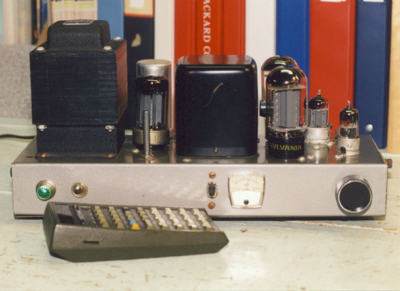

You may ask, has jhstewart9 ever built an amplifier such as this. The answer is 'of course, here are a pair of monoblocks'.

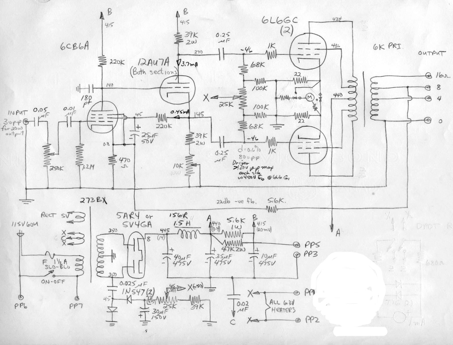

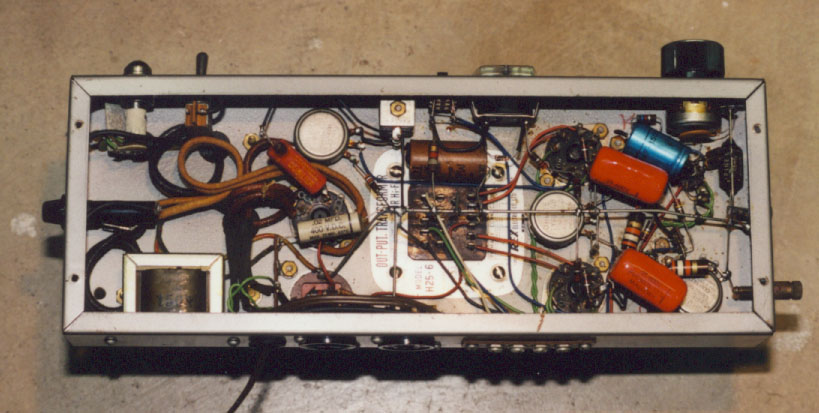

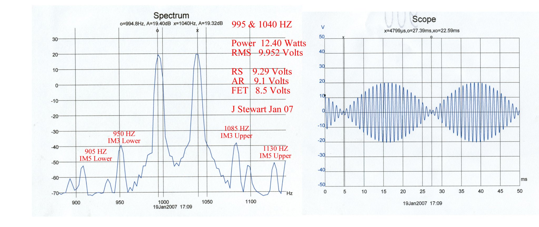

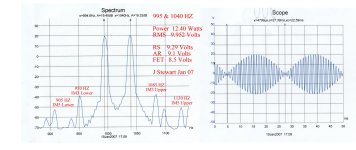

I built these around 1960, I was interning & didn't have a lot of money. They have a DF of better than 10. And 3rd order intermods down 60 db.
These were my daily drivers at home for 17 yrs. Ohmite pots are use to set Bias, AC balance & DC balance. They are still here on the shelf.

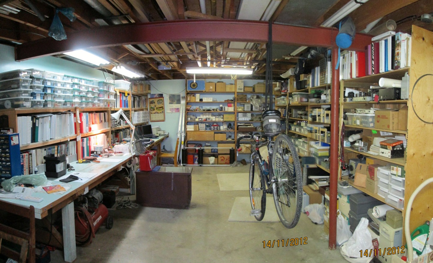

The workbench here 18 feet long, built of 2x12 construction grade spruce. And plenty of shelf space on both sides. I retired the bike a while after 85.
During that period we had a lot of parties, no one ever came & asked what Rs or Cs I used. And after a couple of beers no one cared.

Very nice. I love the vintage calculator in the first picture.

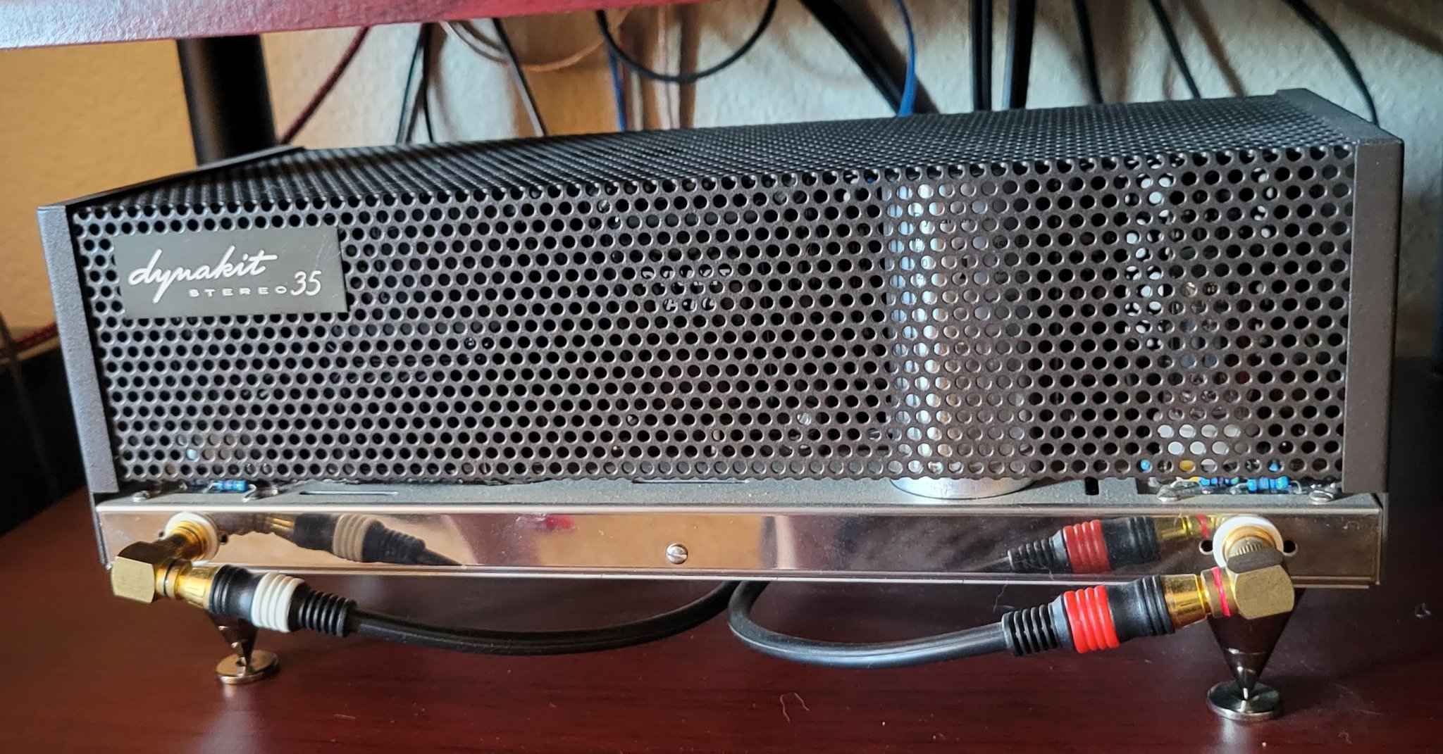

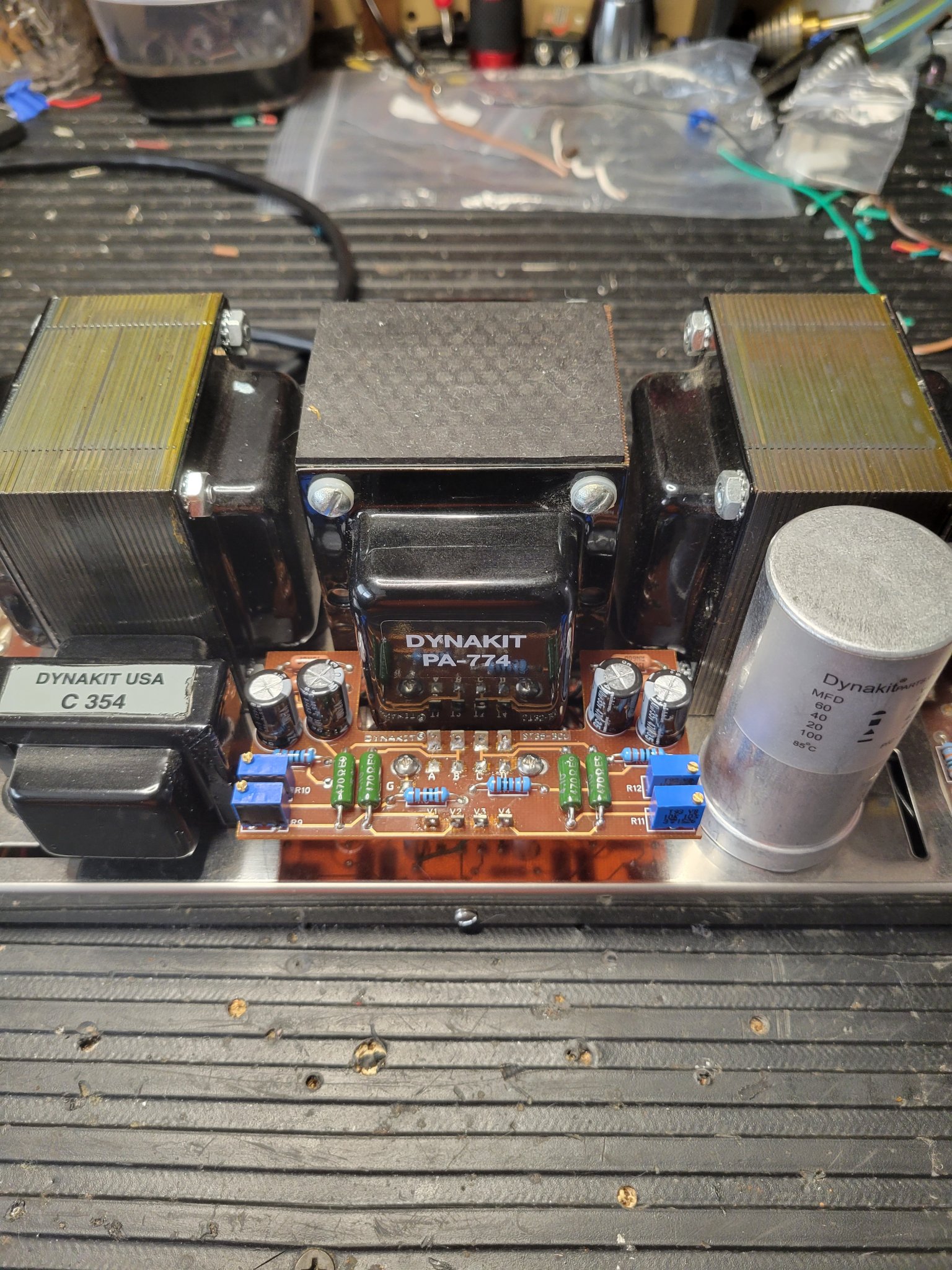

I built my ST-35 adding the choke, CL-90 thermistor and better RCA jacks.
I also added taller feet for better air circulation. Later I added a bias board kit someone sold me at a discounted price. I also used Sovtek EL84M's and JJ driver tubes. I have a lot of other amplifiers, but this one is one of my favorites.
