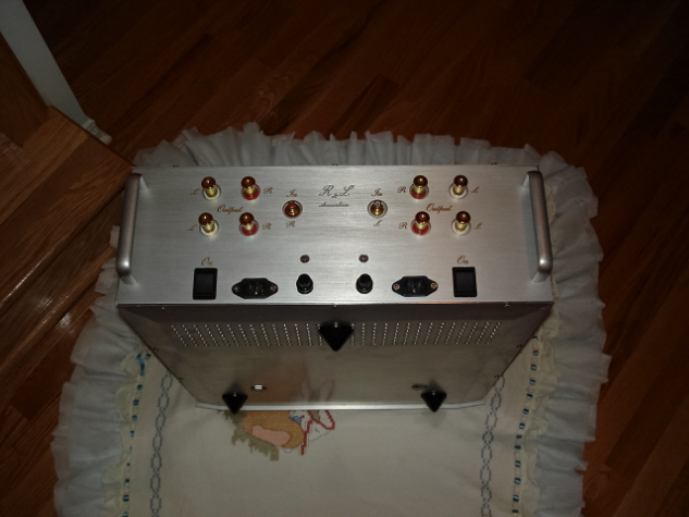

Beautifully made and a staggering weight to prove it 😱 . I really appreciate the accuracy and planning that goes into these projects, the metalwork is exceptional!

Real nice construction job. At 140 lbs, I’m guessing that you don’t take it around to audition at friends houses too often. 😉
With only two outputs per rail and 64 volt rails, you’re probably pushing the SOA limits of the outputs at 2 ohms. I’m guessing that a full power test into 1 ohm might be a bad idea.
Are you using bootstraps, or a CFP output stage?? Looks like it pulls close to the rails (with power figures like that at 64V).

QUOTE...[With only two outputs per rail and 64 volt rails, you’re probably pushing the SOA limits of the outputs at 2 ohms. I’m guessing that a full power test into 1 ohm might be a bad idea.]
I know Kaos and that's why I intend to double up the output transistors (+ heatsink) on this project or on the next one...as I might eventually make another one and go biamping.
Still, I don't listen to my music very loud and I am not pushing the amp too hard. Still, believe me it has so much reserve than music stays rock solid and composed even in some very demanding orchestral music. Music doesn't get confused at all even when I crank up the volume to almost discomfort level (so says the wife ;-) ). Every instruments stays where it should be i.e. in its own space with a lot of air/space between them.

Does it have any fusing at all?
As for removing junctions: I assume it has a power switch? Plugged into a wall outlet? Connected to the grid?
Edit: Now that I've logged in and the pictures have loaded I see power switches, IEC sockets and presumably standard power outlets.
Don't get me wrong, I'm sure it sounds great, I just don't think getting rid of that particular safety feature will do anything but make your amp a small fire hazzard.
[QUOTE: Edit: Now that I've logged in and the pictures have loaded I see power switches, IEC sockets and presumably standard power outlets.
Don't get me wrong, I'm sure it sounds great, I just don't think getting rid of that particular safety feature will do anything but make your amp a small fire hazzard.]
Hi Tim_X,
The amp does have a power switch + IEC inlet (both rated at 20 amps if I remember correctly) + a fuse on the AC + 2 fuses on the boards......per channel.
Before having the thermistor/thermal switch removed from my customized Plitron LONO, I talked with an engineer at Plitron to see wheter it would represent a fire hazard or not. I gave him the specs of my power amp (power supply wise) and I was told that since the LONO are made in such a way that you have very low inrush current (safety measur- ??), I wouldn't need the thermal switch and would remain on the safe side.
I forgot to say that the transfos were custom made for exactly 120 V (not the usual 115-117V) and I usually have 121-122V coming into my wall outlets.
Since I have NO relays (hate the sound of them), I decided to put a ON/ON switch with a heavy-duty-heatsinked resistors in ''safety mode'' on one side. So the amp is basically always ON .
When it's on ''safety mode'' current has to go through the big resistors. So should there be a blackout (no electricity for a while) and the big power supply capacitors get emptied, and then let's say, the electricity would return, signal would then have to go trough the resistors and there would be a delay of 7-8 secondes before reaching peak values therefore avoiding big surges. AMP IS ALWAYS ON ''SAFETY MODE'' WHEN I AM NOT LISTENNING.
When I do listen, I then turn the amp ON---bypassing the heavy duty resistor in the process--so I got nothing in the signal but the AC fuse, power switch and IEC inlet. NO relays, PCB boards, chips in the signal as safeties.
