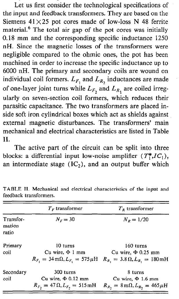

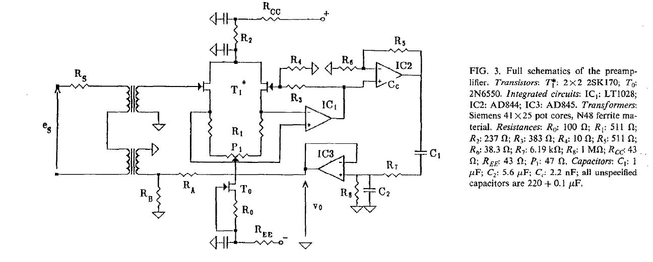

Transformer feedback can get .065nV but needs to be tuned to the cartridge series R at low frequencies.
Could you show a conceptual schematic? Is it just transforming up the feedback impedance so as not to load down the output as much with a low R feedback resistor or is there more subtlety?
Rev. Sci. Inst. Vol 63 No 3 1992
I don't know how to tune this thing, as presented more that 1 Ohm real part of input Z had problems at the low end. Those are hand wound pot cores at the input.

True, with transformer you can get down to the Johnson noise of the input winding.
The best ones go down to 0.5 Ohm so putting a 5 Ohm cartridge on the input makes the S/N 20dB worse !

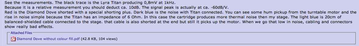

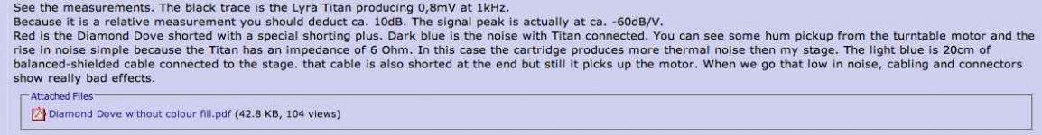

I build a stage with the Sowter transformer ( 0.75 Ohm primary ) that i fed back differentially into an OPA1632 where i got an extremely low and straight baseline at
-160dBV ( referenced to 1V ). I could extend the frequency response to 360kHz, the zero in my passive Anti RIIA so the high frequency limit of the transformer was more or less eroded. Another problem is the saturation distortion in the bass of the transformer and i do admit that i did not measure that. I published the measurement on the High Resolution Forum. I hope i can find it and publish it here.
