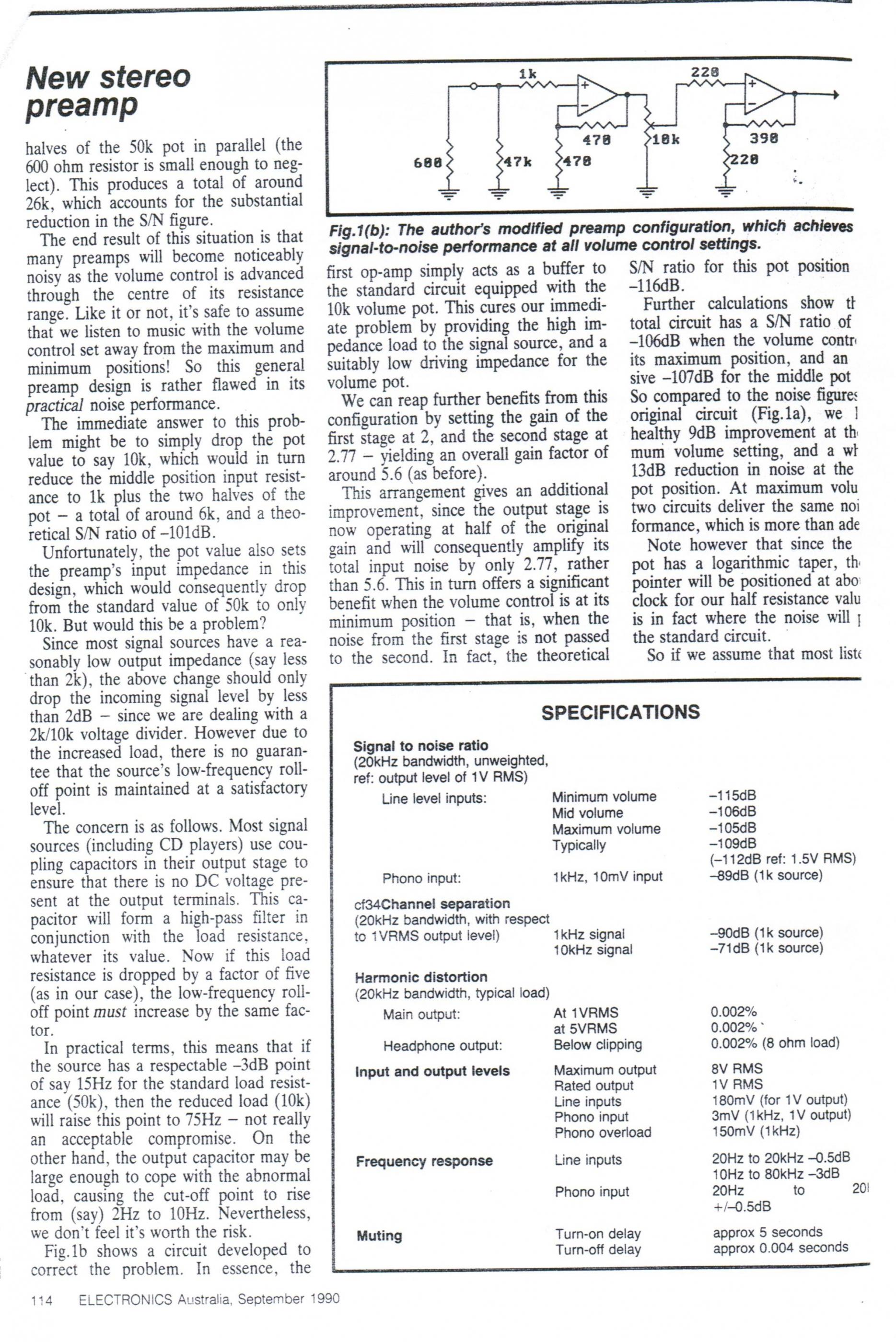

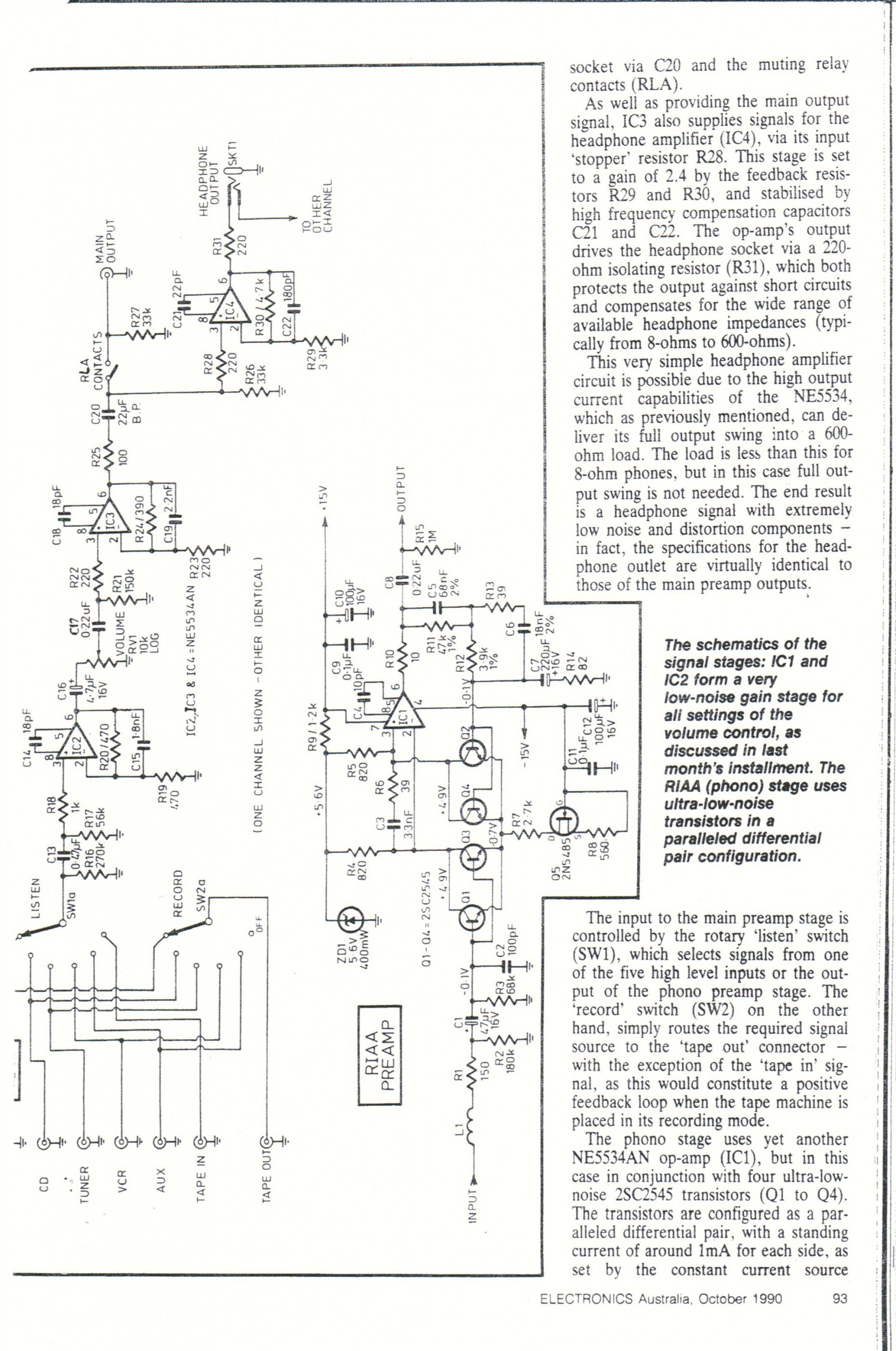

Interesting. I was just looking over some old opamp based preamp designs that I recall as sounding good from the long-defunct Electronics Australia magazine. I see in the power supply to the main opamps they have used 68R + 100uF, about the same corner freq.... I wonder if this is coincidence and how deliberate the choice was on their part...I would probably set the RC at around 120Hz, working from the datasheet which gives you an R of about 5.6 ohms. Since that's miles away from the 100+ohms needed to stop the amp working you have plenty of scope for playing around. Take it up to 27 ohms which is the equivalent of a 120 + 47uF that I once used years ago and which worked reasonably well.
Here are the schematics and specs for their flagship no-frills preamp from 1990, designed by Rob Evans. There are a couple of other interesting things about this design of relevance to this discussion that prompted me to post them:
1) The strong emphasis on "Low Impedance Design" to achieve best noise performance - 22 years ago. Note the feedback Rs, right at the limits and probably lower than they should be so causing extra distortion?
2) Value of compensation caps and feedback caps around the 5534s - the feedback caps are quite large, presumably to define the upper rolloff. Is this perhaps a bad idea?
Would be interested to hear what all you very knowledgable chaps think...
