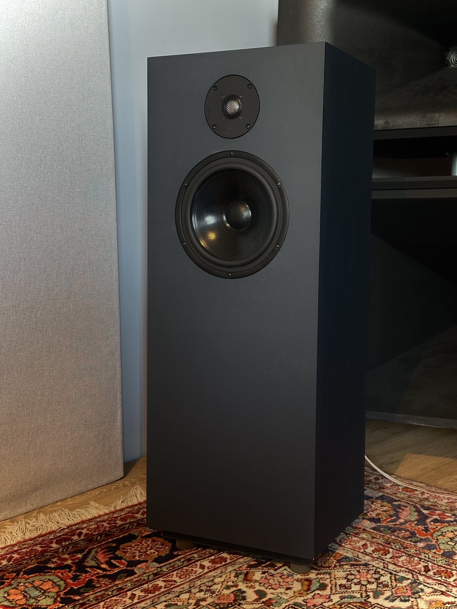

Seas A25 old timey speakers. https://www.madisoundspeakerstore.c...6-10-2-way-kit-pair-based-on-the-classic-a25/
Old is new again. Istanbul is Constantinople now.

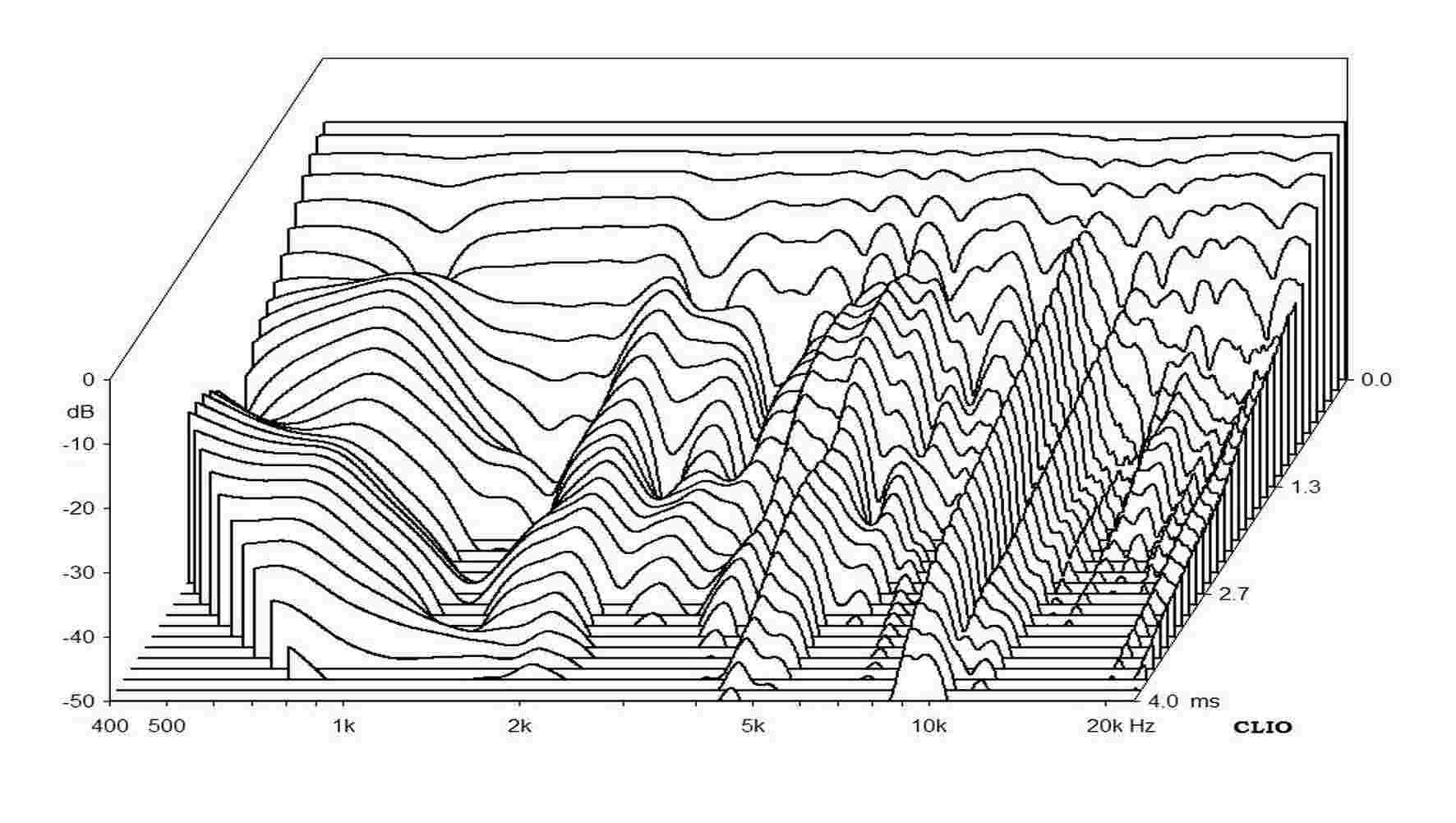

I'am living now with a 3way active. All drivers is clear sounding, detail. But really want to try CA22RNY in 2 way. I'm watching this driver some +5 years. This is unicue sounding driver. I'm sure.

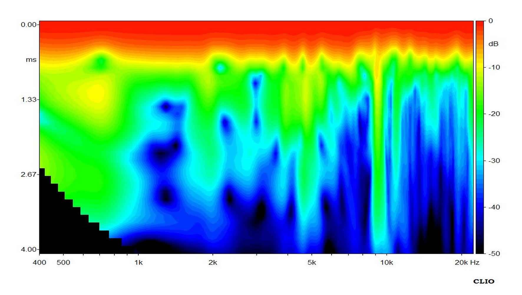

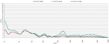

It is very interesting how all these resonances sounds. My current speakers have less than half of that.

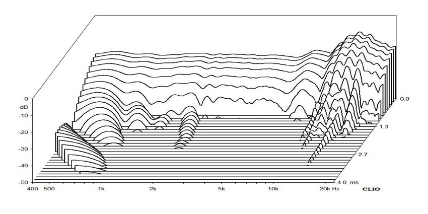

My future plans use it with MONACOR DT-352NF. It looks like this is also an interesting but not so popular driver. But of course I will do active filtering again.

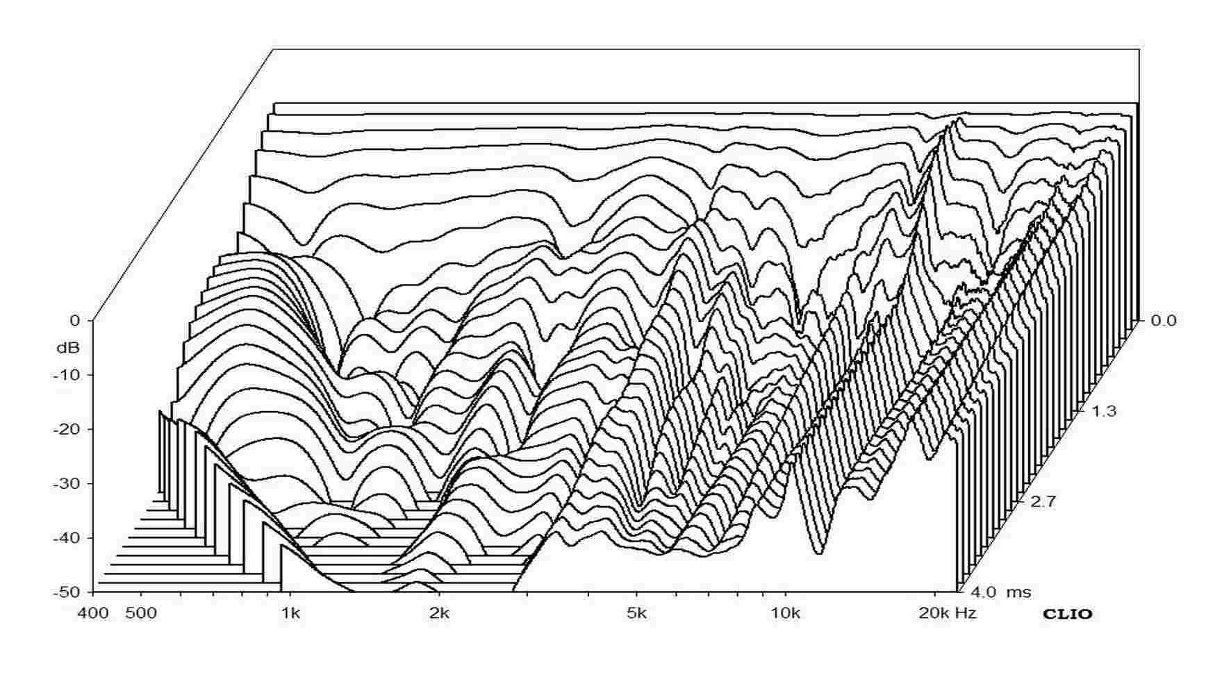

I have some CA22RNX lying around from an old project. I need to figure out if I can make them work for this project. I have a lingering love for old two ways.
How CA22RNX sounds, what do you think?I have some CA22RNX lying around from an old project. I need to figure out if I can make them work for this project. I have a lingering love for old two ways.
CA22RNX. A lot of energy everywhere.

Yes you can use the CA22RNX. I worked in the past with this woofer. Not really the same crossover, it is a new project.I have some CA22RNX lying around from an old project. I need to figure out if I can make them work for this project. I have a lingering love for old two ways.
Keep the crossover frequency around 2kHz LR4. The crossover of the ZaphAudio ZR71 could be a starting point.
The sensitivity will be 2db lower but you will have a better bass extension.
- New DIY kit: SEAS Aphel 2 way old school floorstander
