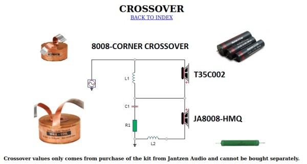

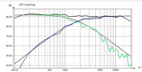

The estimable Mr. Troels Gravesen had some luck with his Seas Based 8" plus 1.5" 8008 Corner design:
http://www.troelsgravesen.dk/8008-CORNER.htm
Actually looks rather good for a simple series crossover:
An almost perfect 12dB per octave negative polarity LR2 curve! Which is supposed to be a good thing.
No idea if it sounds any good... you need exceptional drivers to pull this sort of thing off! But many ways to skin a cat.
It is worth bearing in mind that passive filters only present impedance problems around the crossover point, so only a couple of octaves are impacted in some filter source impedance sims I have done.

I think it is not working for the Aphel in this configuration, I try a similar solution. You have a big hole in the high frequency. The cone of the CA has a nasty break up, not seen because there are no peak but it is present.

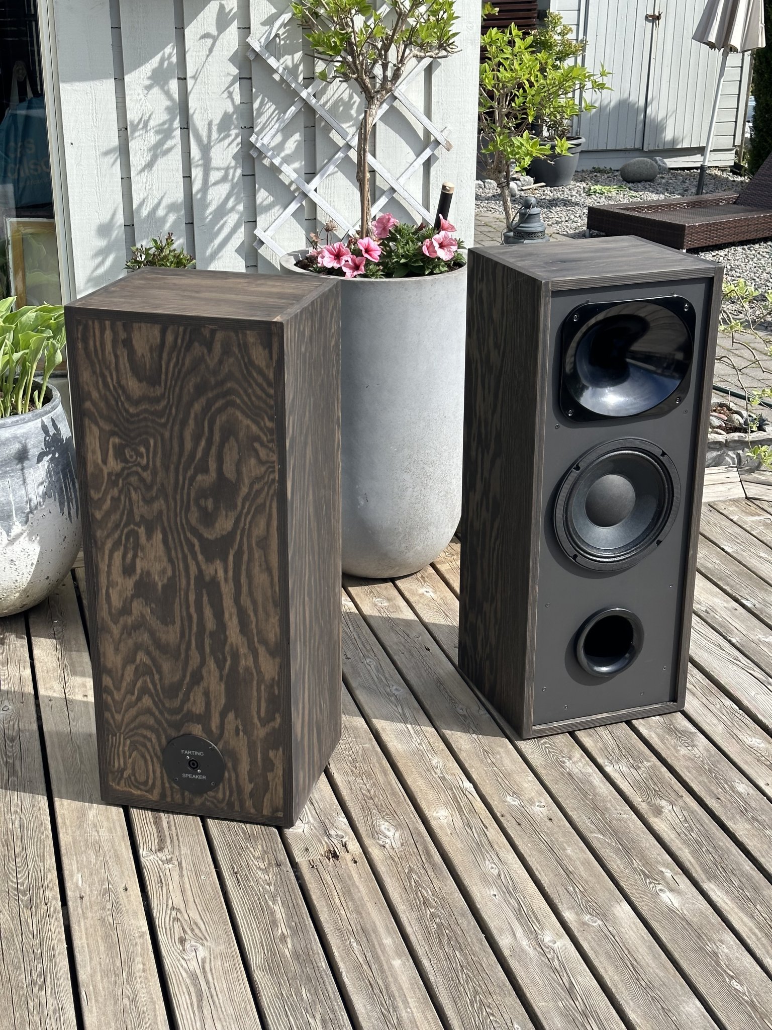

I made the enclosure and had the idea.

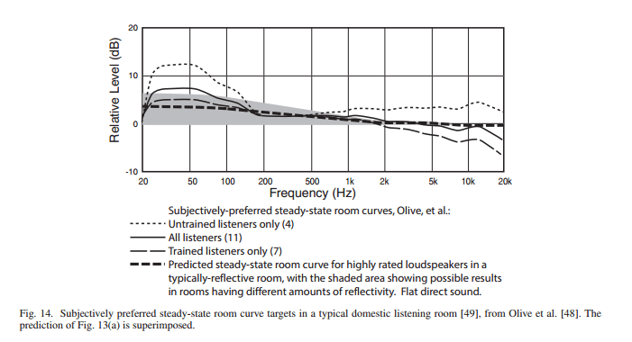

@superlian's above preference graph just proves that casual listeners prefer tiresome "boom and tizz" in their loudspeakers!
Some commercial models are voiced to cater to that cloth-eared brigade... 🙂

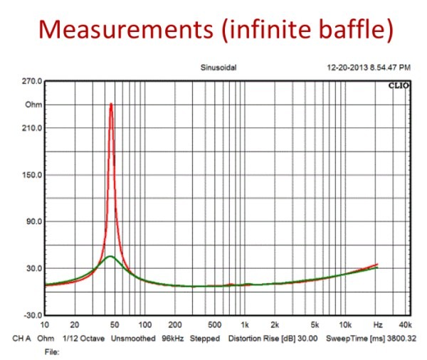

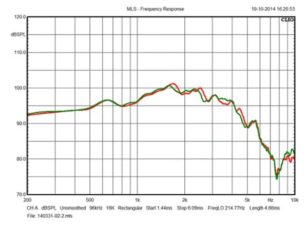

You can look this up, but Troels Gravesen's JA8008 HMQ driver, SEAS based, has some tricks up its sleeve.
http://www.jantzen-audio.com/
High QMS, around 10, with a foam surround and fibreglass former and even phase plug making for low loss. You see this in the high Fs peak which compares fibreglass with aluminium former.
Extended frequency response too:
You can disregard the range below 1kHz as a 22cm baffle effect.

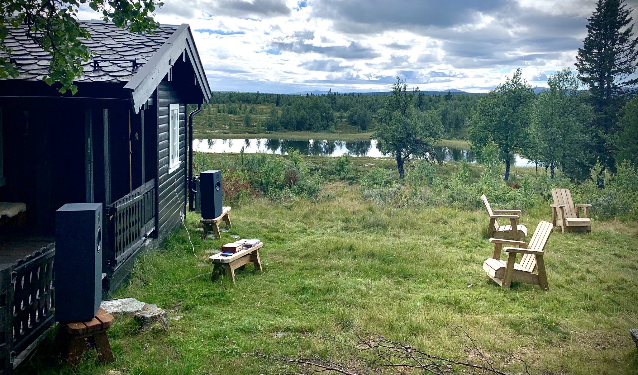

And my cabin is in the middle of the Peer Gynt (Henrik Ibsen) area in the mountains in Gudbrandsdalen. I have in fact testet this speaker in my peaceful anechoic chamber. The cabin is off grid so i used TPA3255 amp with solar powered battery and 12-30V buck converter.
