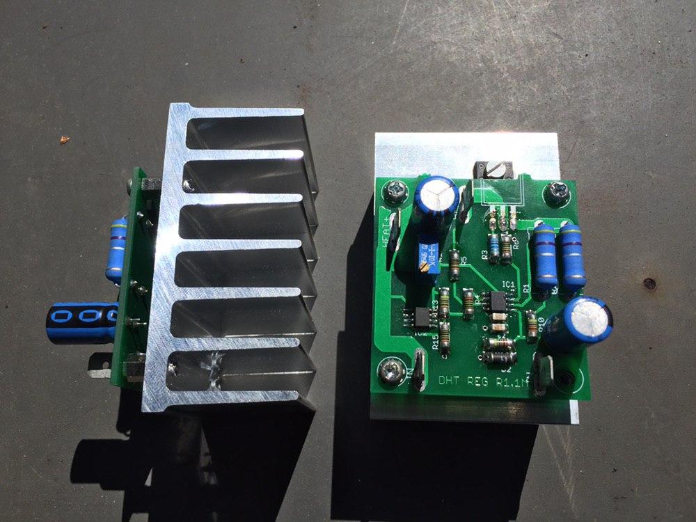

This leaves me with the initial offer, i have two pcb's left of the supply from post #1 those i can supply for postage to anyone who is willing to put in the effort for a stability analysis on the supply. Particularly the CCS part as driving a mosfet with significant miller is challenging. If you read my previous posts i have "fixed" this by putting a small value cap between source and gate, but this cap need to be dimensioned properly. An alternative i have thought about is putting this cap between the output and the non inverting input, in this way the gate voltage dV/dT is still limited by how much the opamp can slew with a capacitive load.

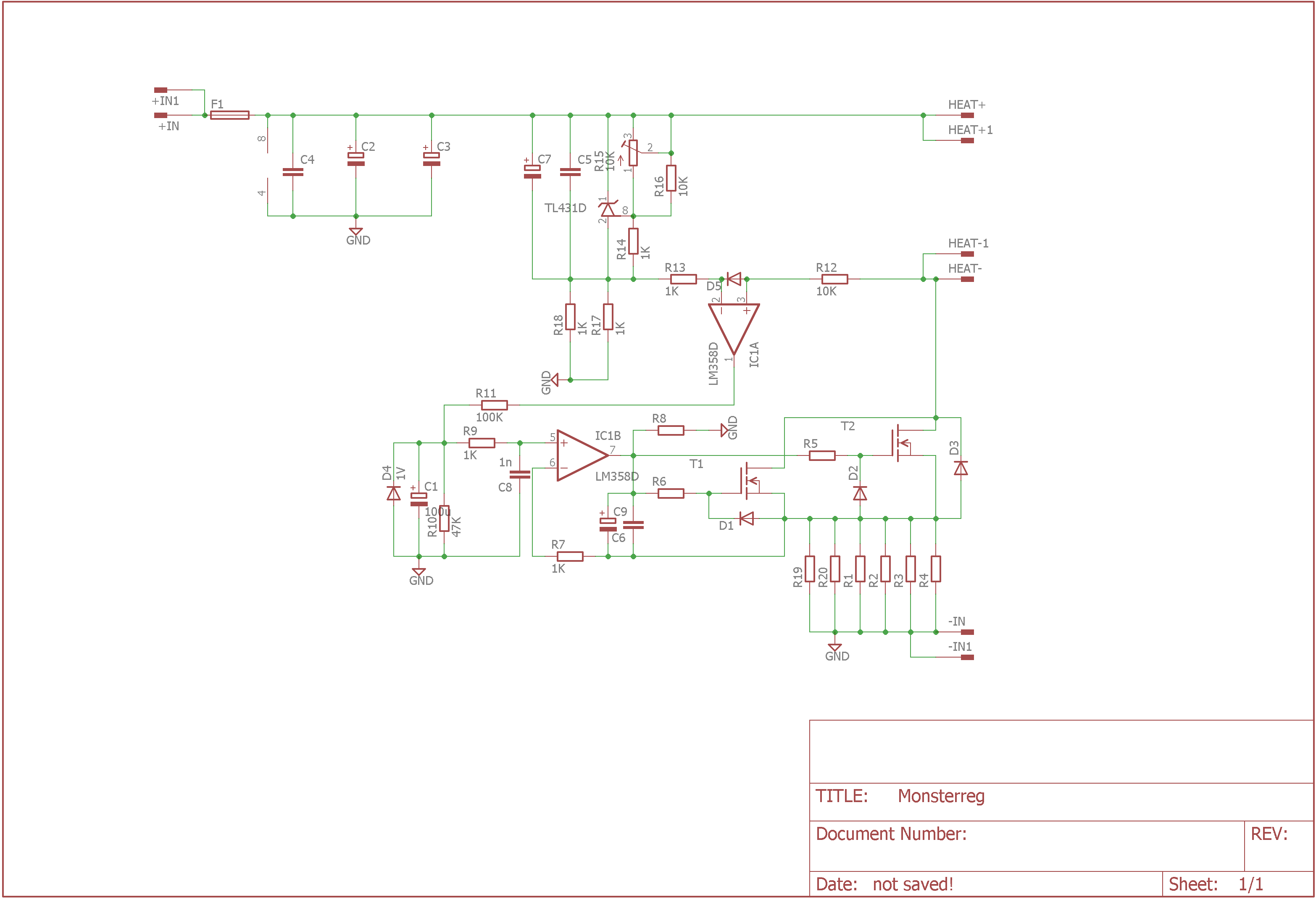

Attached the schematic for reference purposes. and a plot of the board as it stands.

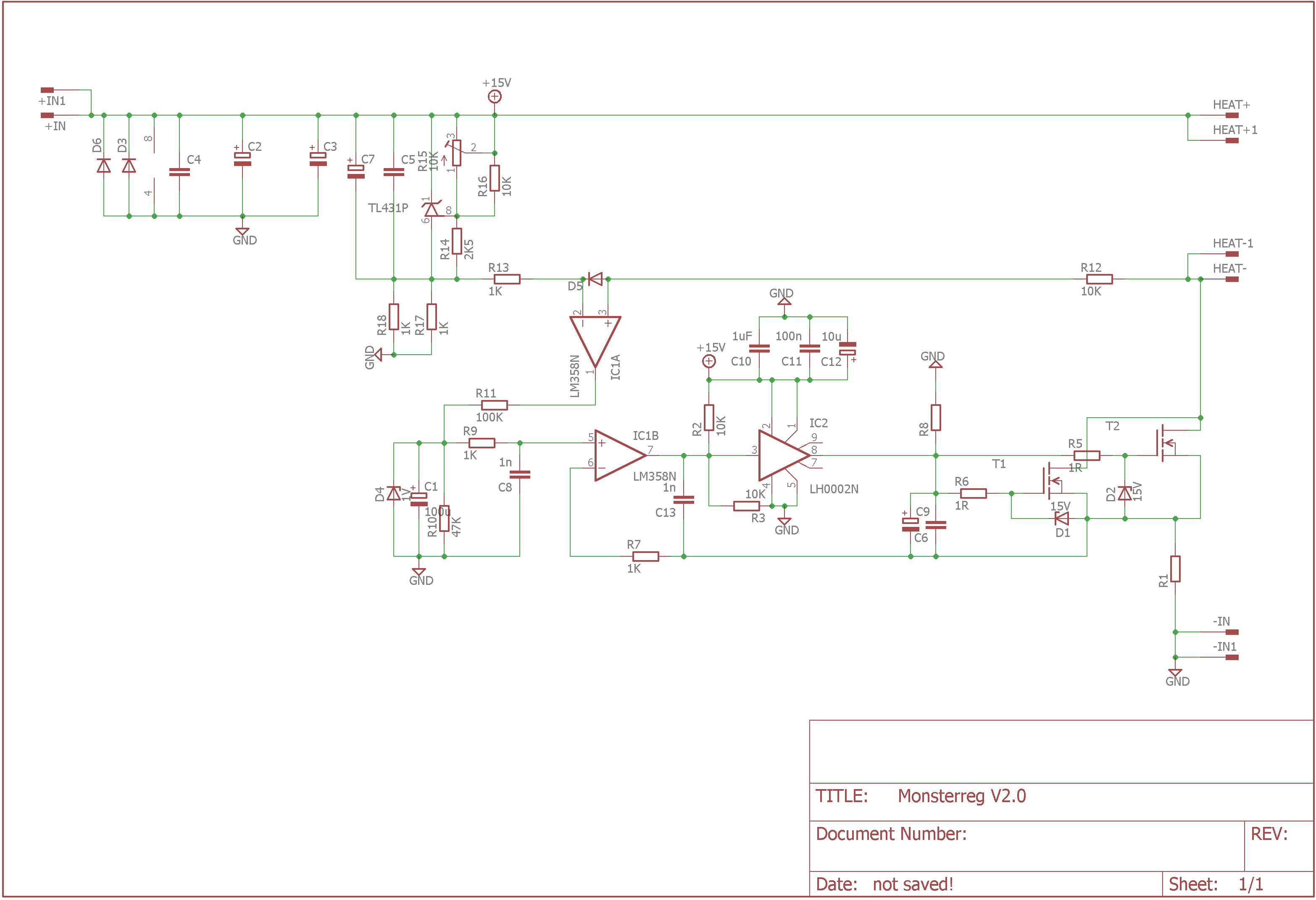

V2.0
Ive implemented the last changes into a semi complete schematic.
The board will be through hole, so any possible builders dont have to stock up on expensive MELF resistors. Allthrough i like those a lot and they solder faster than their normal 0207 through hole counterparts.
I added a LH0002 buffer because i know from testing this has a good square wave response in a dynamic load setting, hence its expected to be stable, whereas for the LM7322 i can never be sure, because the spice model doesn't seem to exist. Furthermore the 358 is easy to model in spice.
There are some open positions for different bootstrap capacitors. I retained the RC filter on the input of the CCS opamp because it cant hurt, dV/dt on that node is so low that it doesn't do anything but filter out potential HF noise.
I made a model for a TO220 resistor and added that, its likely going to be a 68mOhm part. Or a 100mOhm part with a 1.5V zener, whichever is cheaper. Those resistors are specced for 30W and the 0R1 part could potentially see 22.5W during start up of the regulator.
Normal dissipation with a 10A load = 10A*10A *0.1R = 10W Add about 2-4V over the Fet's and you are at 30-50W. All through the regulator should be capable of running at a dropout of approximately 2V. Leaving you with the option of running from rectified 12V.
Two parallel DO201 diodes where also added to the input, so any monkey mistake in polarity will blow out the fuses rather than take out the opamp.
Leaving those out would mean that if a load was connected, the load would see nearly the entire supply voltage, due to conduction through R1 and the body diodes of the FET's.

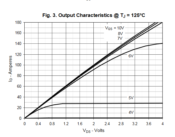

I dislike the parallel devices. using this device for the fet:
IXTN240N075L2 IXYS | Discrete Semiconductor Products | DigiKey
A version that is expandable to well over 15A could be built.
I'm gonna look for a cheap 227 package device with linear characteristics, as i know these are mostly ancient devices that have good DC handling characteristics anyway. EDIT this one looks interesting : IXFN180N25T IXYS - Module | enkele transistor; 250V; 168A; SOT227B; Ugs: +-30V; Idm: 500A | TME - Elektronische Componenten
It has lower miller and drive requirements then the TO247 device ive specified earlier. PN for reference : IXTH80N075L2
Ive added both the SOA curves and the transfer characteristics, note that the characteristics at 10-20A are flat from VDS=1V onwards.

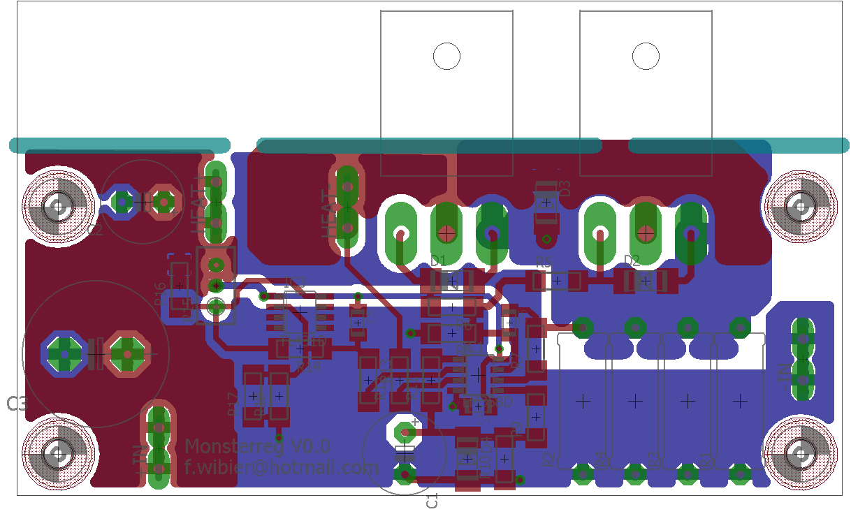

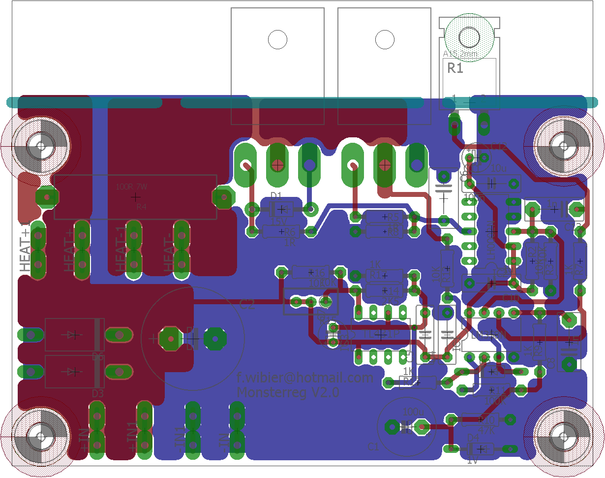

Layout V2.0 nearly finished
Heres the layout of V2.0 in Through hole, its nearly finished. I do have some space left over.
I havent drawn the planes for the high current paths yet.
Any thoughts?
If anyone wants the EDA files onces completed send me your dropbox email through a PM and i will add you to the map.

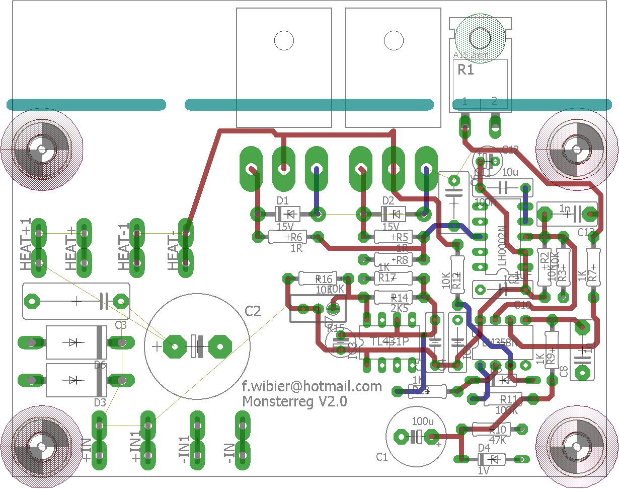

Layout Finished
Heres the final layout for V2.0 This is the version i'm going to order, as i prefer this one over the V1.0
Theres a little error regarding the resistor on the top left corner, but i dont have space to move it out of the way, or increase the board over 80x100mm
These boards run about €9 each, anyone want to take a chance on this design? I will have two spares after one proto and two complete boards for someone else. I expect the design to work.

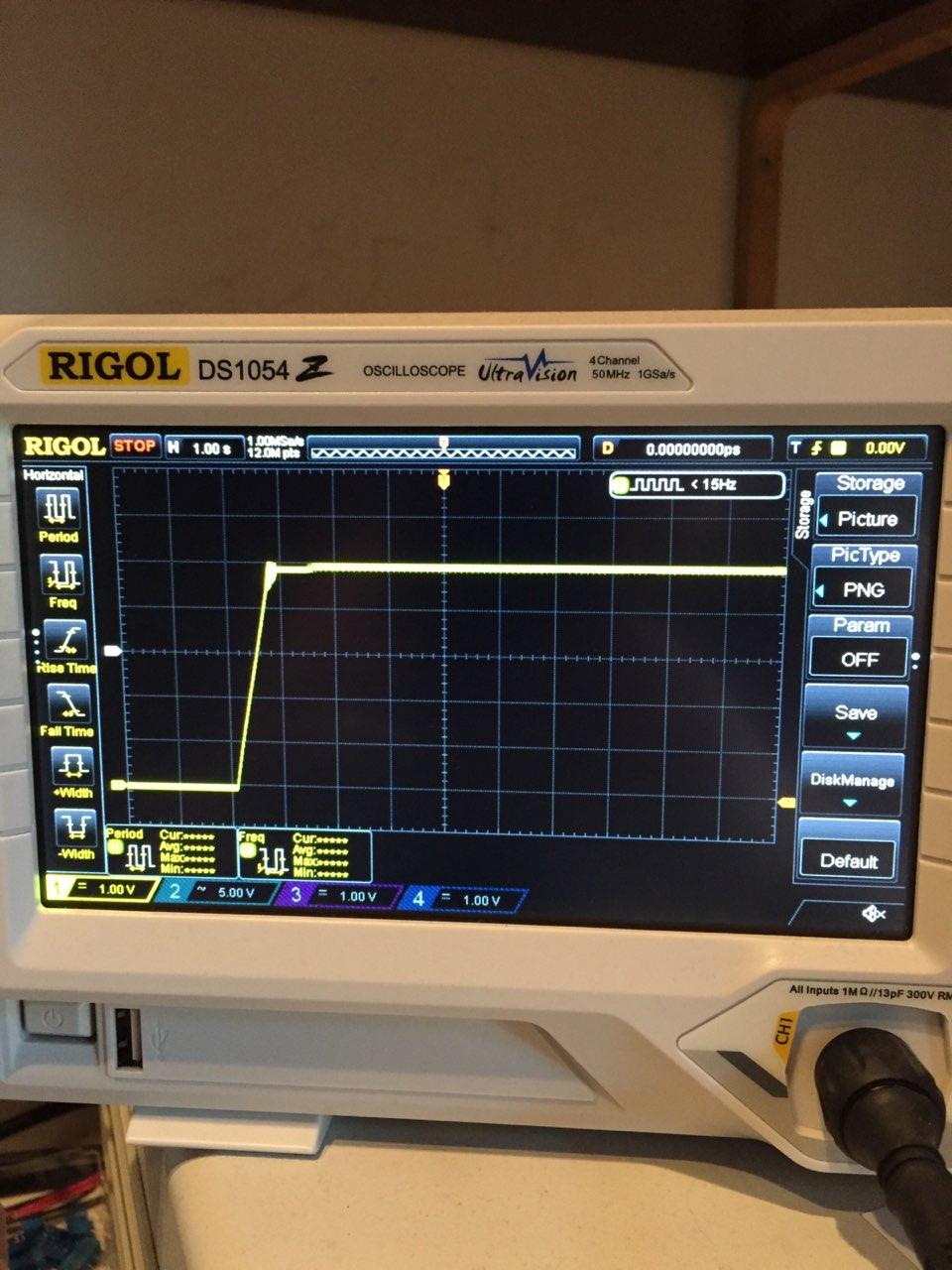

Some measurements on the little 2.5A version
I got some feedback on the little 2.5A version i built, one of the points was that during startup the voltage could rise beyond the set voltage by a volt or so depending on the tube used. This was due to the RC time being in the vicinity of 5s for that version. This was due to the fact that the loop upregulates the current at startup to provide quicker heat up time. 4.2A for the 2.5A version. However the tube warms up quicker then the time needed to down regulate the current again, hence the voltage spikes about a volt or more depending on tube thermodynamics. I suspected this might be an issue, but i didnt have any DHT's to test with so i did my initial test with an EL34. I took a 5R4 as substitute for this test.
Decreasing the RC time to 2s flat fixed the overshoot issue during startup, this version needs some component values changed. The two RC resistors are now 47K and the timing capacitor 100uF. I will upload a changed schematic later.
Edit out of caution i will use 47uF and two 47K instead. that brings the -3db point for the low pass filter down to about 1Hz
See attached a photo of my RIGOL 1054Z in one shot at 1V/DIV and 1s/DIV. VIN on the regulator is 10V Vout set at 5.0V and loop current limit is 4.2A (1V/.235R)
PS: I can make the gerbers available if you PM me. you should be able to get about 10 boards for under 25 US shipped from China with most board houses. for standard 35um copper boards. 70um seems to carry a hefty premium and the MK1 eyeball says that 35 should be enough to carry the current(10A)
I can also make the single FET version available to anyone that wants it.
And the little version of this regulator.

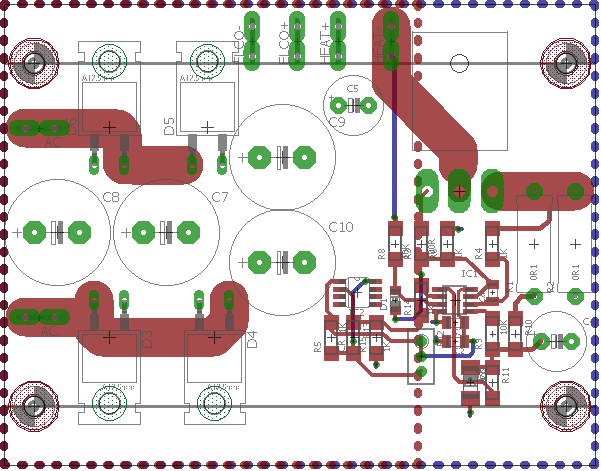

I crunched the numbers on the 833A version once again, and came to the conclusion it can be done with a 12.5V 15+Ampere transformer. And my number crunching also indicates its possible for this supply to use a single Fet as opposed to a double FET version. Provided you use low VF Schottky diodes.
if we assume a mean voltage of 12VDC plus 1.5VRMS ripple, and 10.0V output. the nominal dissipation is: 35W and the +10% Line dissipation is. 48.5W, which is within the limits for a single mosfet. especially given that about 5W is dissipated in the 50mOhm sense resistor.
If you're smart about it you just buy some 12VDC switchmode supplies that can be set to 13V output, and wont mind a 15A surge during heat up.
A suitable heatsink would be around 1K/W. There is a heatsink im eyeing for this purpose.
Possibly more to follow.

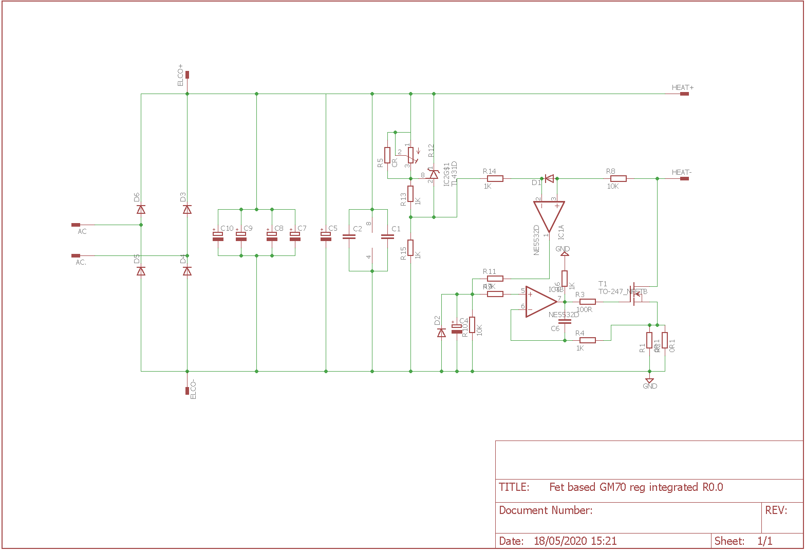

This is what i came up with, i reverted back to through hole resistors for the sense resistors, because 100mOhm 3W MOX types exist, those will however need stand-offs around the legs for better cooling.
I made this design for a 78x100x40mm 1K/W heatsink sold by TME.
Its my tried and tested GM70 regulator on a 1K/W heatsink with on board rectification. The needed capacitors, around 10000uF 16V for 10A are available in the form of 7.5RM. There are connections for using an external capacitor can as well.
I'm gonna order this board in 70uM copper.
