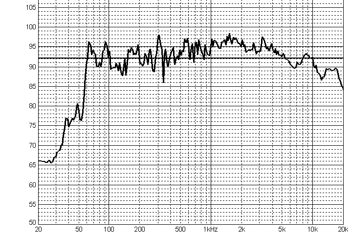

Now I have it calibrated with a THX-DVD and I must say the phase adjustement brought these speaker beyond my expectations !!
A friend built me a stand for the right speaker, putting it at ear level.
I did dozens measurements to optimize the listening position, and I got a good surprise : the front satellites had to reach 70Hz with a peak, and they reach 60Hz with ease and with linearity ! (see graph)

I found these enclosures good as soon as I heard them, and with the new DVD player and the phase adjustment I find them awesome :bigeyes: : the details level is very good, the reproduction is perfectly natural and the stereo image wonderfully precise. Highs are airy, not to say fairy, and they don't lack at all (the graphs where taken at 4m with non-synchronized pink noise, and I have a bad soundcard : it explains the decreasing high end).
I really enjoy music on them now, without any sub, these speakers sound magic.
