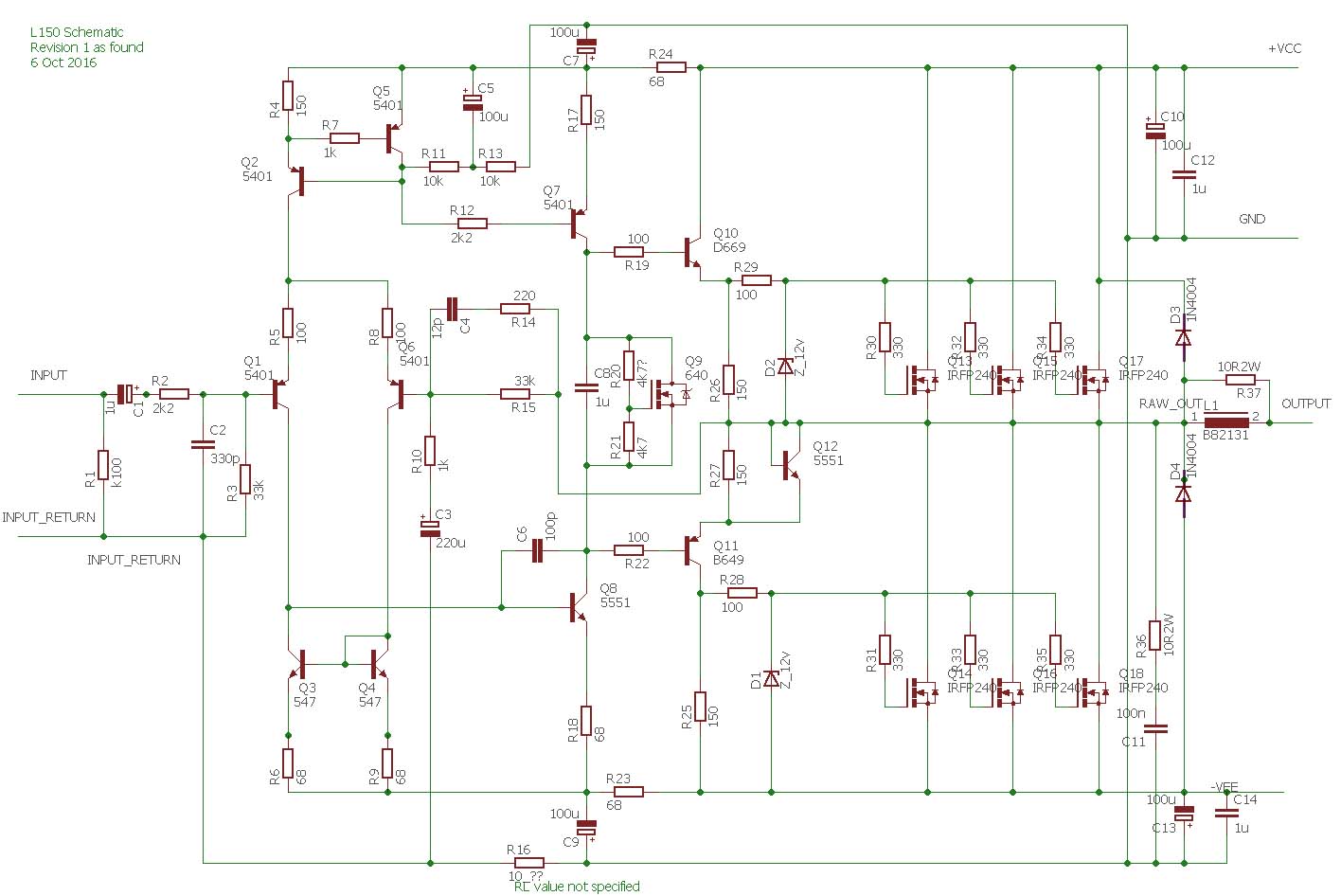

Your photos are so funny. You took out your anger on those parts. I think this board has a lot of potential, and it's a bargain so it's worth analysis. Apparently there are many happy users of the board, so I'm thinking bad parts. The die you showed varied in area, and I think the smaller ones are fakes. The larger ones seem typical. Buy a real pair of IRFP240s and crack them open to compare. I have bought fakes from China, and they had tiny die inside power packages, to my loss.
Looking at the design, I don't see anything obvious which might cause failure. I would prefer an adjustment for bias voltage, but since this design does not have convenient source resistors to measure, you would have to use an ammeter on power leads. Easily done. But again, there is no adjustment. Add one.
The reason that matters is that MOSFETs can have large differences in threshold voltage from one to another. The spec is 2 to 4 volts, and most parts are about 3 volts, but you don't know. So the bias generator could be too low, or too high, and you can't control it. You need a trimmer to set this initially.
The next concern is the MOSFET as a bias generator. Does it really vary the bias properly? It is thermally coupled to the outputs, but it's running very low current. The thermal behavior of a power mosfet is not well specified at low currents. My inclination is to swap in a standard bipolar transistor Vbe multiplier, add a trimmer and see if that works better.
A subtle problem with mosfets is they like to oscillate at high frequencies due to stray coupling to the gate. It's random, depending on layout and lead dress. It can cause failure. I have seen 60-100 mHz oscillations in amps before, and they were difficult to quench. Often people give up and put big caps on the VAS output, which works but does not satisfy me. I like to put ferrite beads on the gate leads in all cases, since this goes a long way toward choking out the problem. I'll poke around on this board with a scope and see what's going on. Gotta buy some to investigate.
I mentioned there are no source resistors. MOSFETs can differ a lot in threshold voltage and on resistance. So there is no guarantee that 3 random parts in parallel will share evenly. Source resistors partly equalize the currents, but matching would be good too. I know they waste power, I know they cost money, but as it is you can have one MOSFET carrying all the current, until it blows, then the next carries all the current and blows, and finally number three blows. That's one scenario. They need to be matched and forced to share load.
So I'd add a trimmer and match the output devices. Verify the outputs are actual IRF240s by crushing one and comparing with a known good. Good luck.

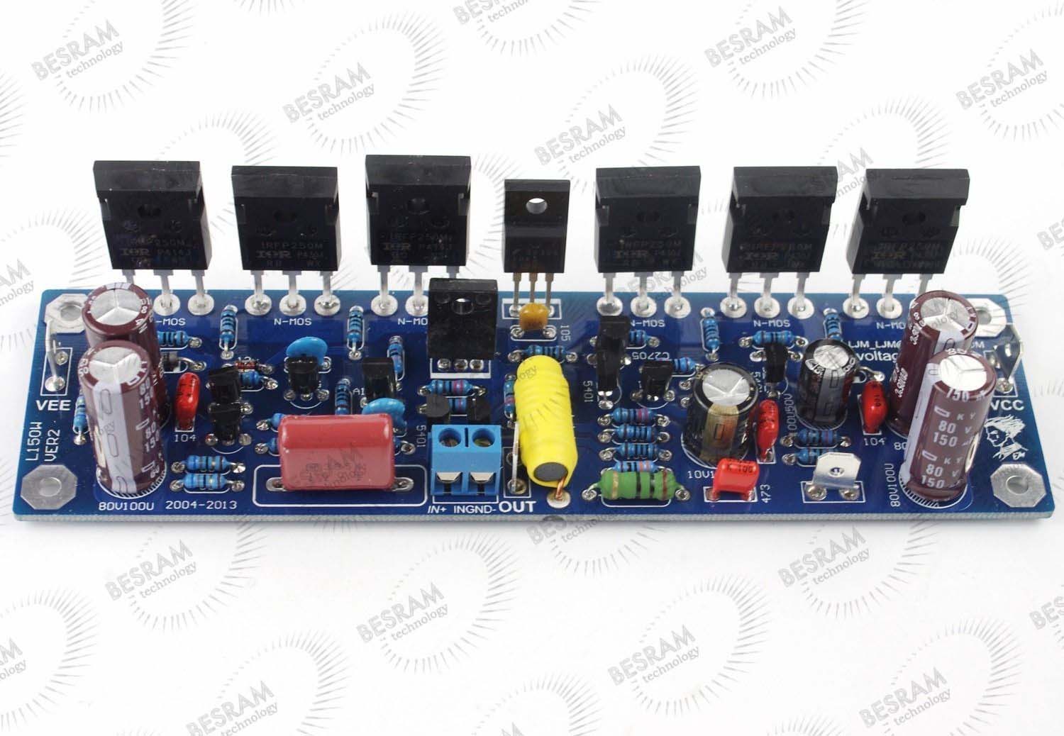

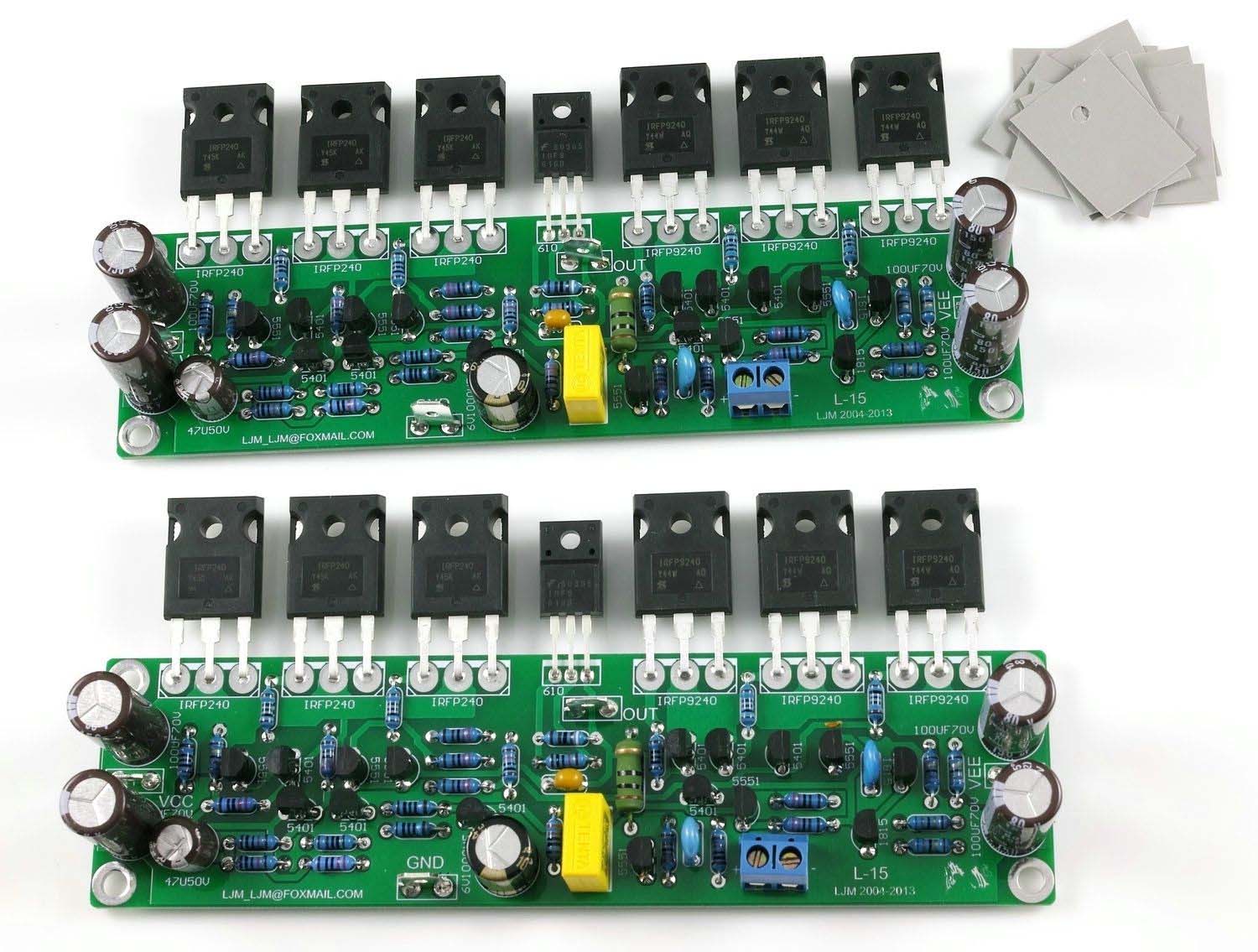

The designer, LJM, mentioned in an earlier post that there is a similar version of this L150W amp with complementary output MOSFETS that sounds better. It is called L150. I am posting pictures below of the L150W and the L150. (I am ignoring the similarly named digital amps L150D and L150SMD).
Neither the L150W nor the L150 has source resistors to balance currents in the MOSFETs. Neither has zeners to protect the MOSFET gates from excessive voltage. The L150W has about 9 small signal transistors, while the L150 has 16. The circuits must be quite different. We have an approximate schematic for the L150W, but none yet for the L150. I will try to get one.
Though flawed, these amps are cheap and small. They are a good starting point for mods.
Some corrections, and a possible schematic of the L150W V2. First, the complementary output version is called L15. Second, there are zeners on the gates in the L150W.
I will be looking in detail at the L150W V2 as soon as I receive boards. I post below an approximate schematic, which is merely a transcription of what LJM posted earlier into Eagle schematic capture program. This has not been checked against an actual board so will have discrepancies. Best I have now. This appears very similar to Quasi's quasi, except for parts values.

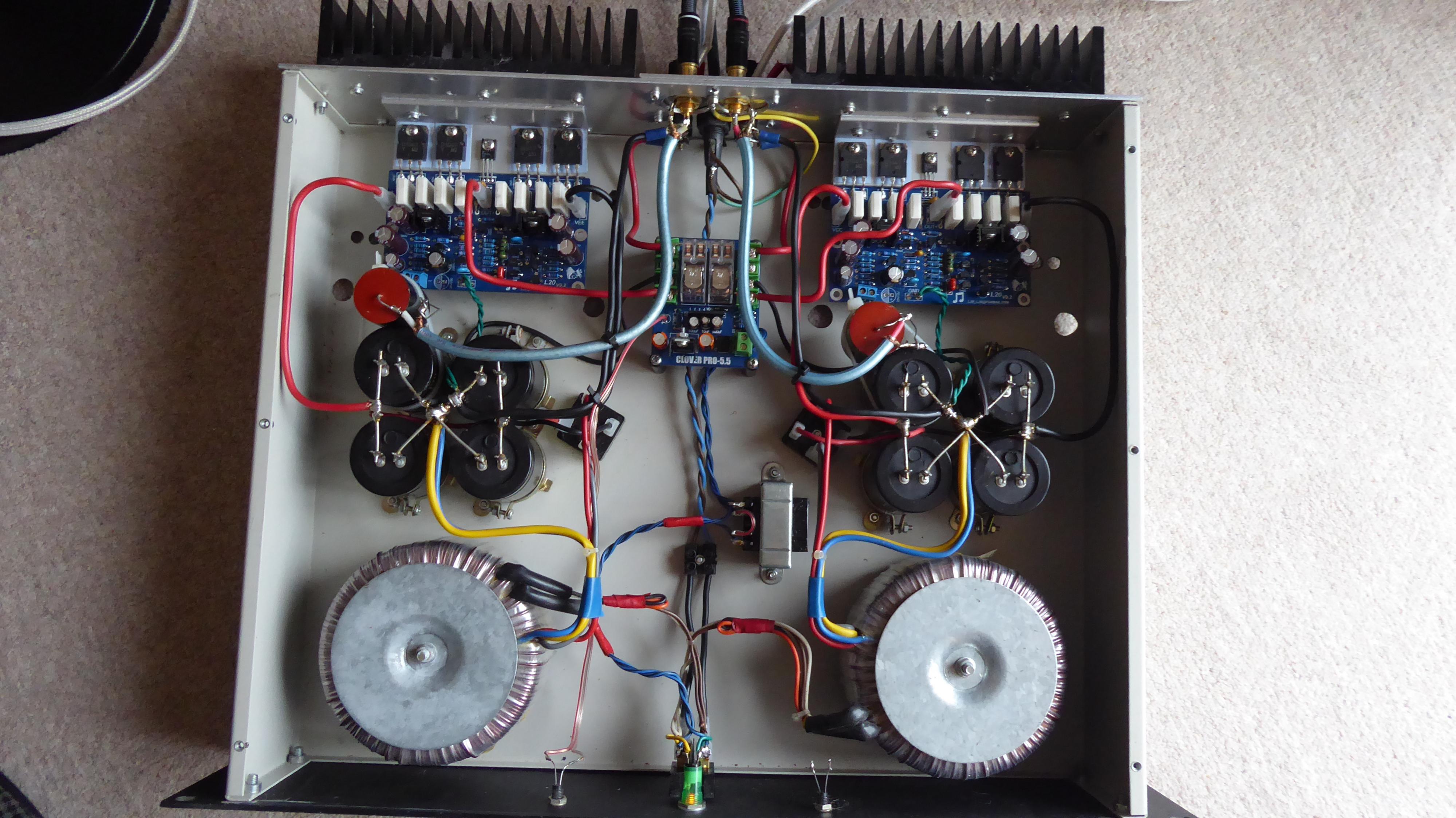

Hello LJM....I am about to make another of your excellent amplifiers (L20 v9.2 shown in photo) and wish to buy a MOSFET design. I would like to buy either the L150W or the L15....so I was wondering WHY is the L15 better than the L150W please?...Very much obliged if you could take the time to help me here...Thanks.
