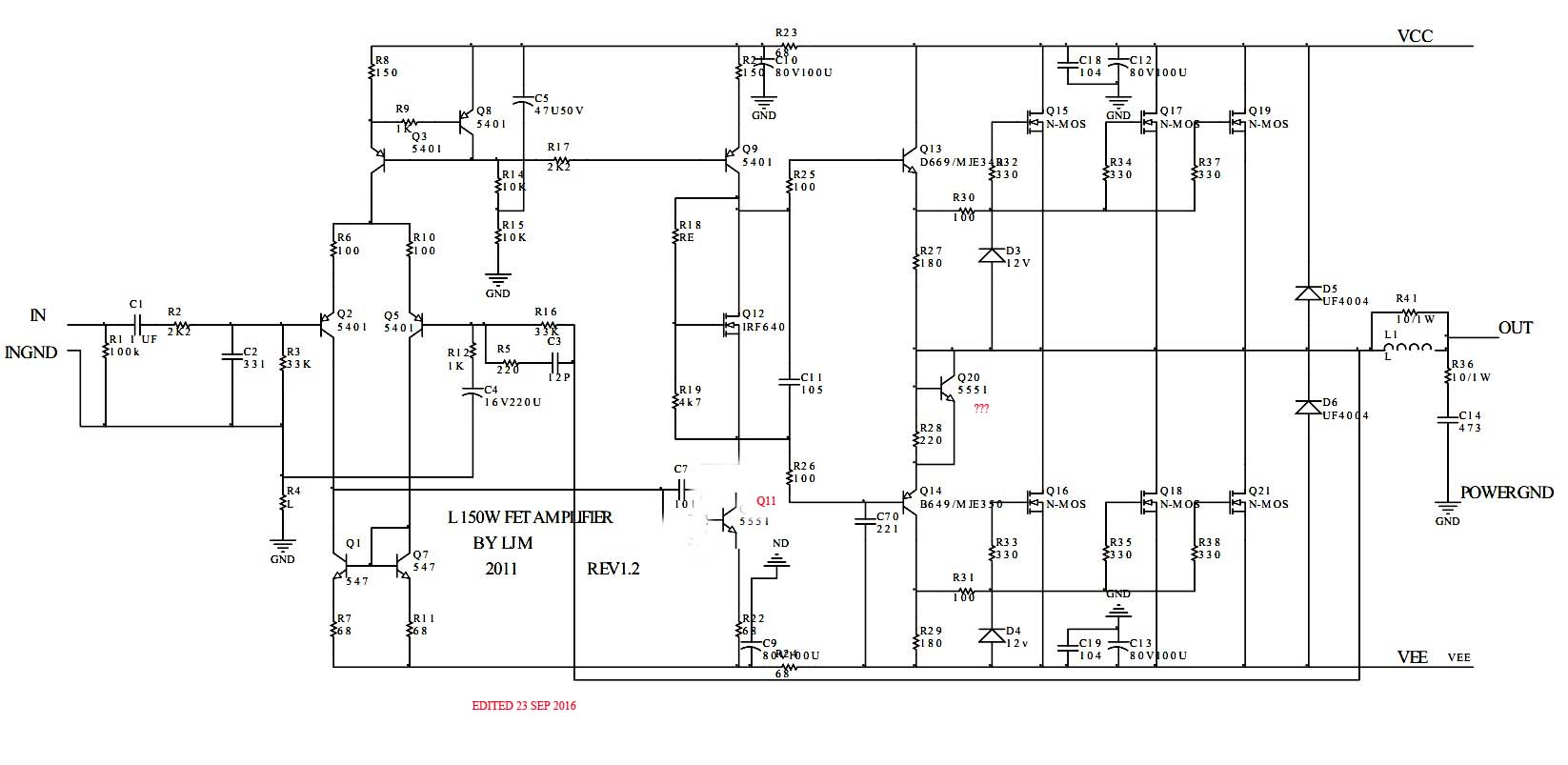

LJM 150 VERSIONS?
I have ordered a pair of these from Sep Store.China via Ebay. They arrived and appear to be a similair to the circuit BUT different set of resistor values. ie NO 100k at input .Their is ONLY one pair of 330R resistor on the board? and a 22R close to the input signal. The 68R and 100R are correct plus 1 x 150-R..seem the same however 10 x 100r and 8 x 2k2 ?
Did you revise this circuit or is this sep stores revised version.
I ask because the output devices x 6 one one amp have blown in 2 hours....

Giving up on Chinese kit amplifiers
Well The second amplifier has now gone the way of the first. I belive All the output devices have failed.ie Both Boards.
Looking at numerous postings on this site I am beginning to think now that the significant posting bt Andrew about the L20 design using 4 x 2 plastic drivers is probably the most relevant.
These amps only worked for me at low levels into a pair of easy to drive speakers.
Once connected to the Volt speakers (less efficient) They ran for a short while and when I turned up the volume they blew the 3.15 amp fuse after about 10 seconds..
Initially only one amp seemed to have dead outputs and I ran the other amp for less than 30 minutes befiore that failed and now the amp is an instant fuse blow.Dead accross each of the pins on all the drivers with NO other apparant failings on the board.?
I had considered that an increase from L120 to L150 may have been enough for me but NO. My previous metal outputs did 105 watt for many years untill the removal men damagaed them.
It looks like the L20s could be the minimum size amp even with the huge amount of heatsinking that I use. Over 1 kilos per channel at 53v DC poss/neg.
I also came to the conclusion that LJM has revised the L150 board as its similair in R values to the Later L15. If not then I have been sold two duds.however They are both Blue boards...Perhaps some one could revise or update this information somehowe?
As a standby I am using a 90 watt Toshiba which can go into shutdown when driven loud for and length of time so that establishes the speakers are a bit power hungry.The new room is at least 50 per cent larger than previously.
Not sure if I want to proceed to another LJM design as I think the Chines output devices MUST be pretty poor. (sonic change when warmed up and driven).

Cheap amps are never cheap...
I have no idea what caused failure. It could be poor quality or fake parts. The design has some risk areas too. It looks like a prototype that has not been stress tested. It needs harsh testing. I suspect you may find the resistor in the Zobel network is running hot, indicating parasitic oscillation.
About fake parts: I have bought fake parts from China, some A1302s as I recall. Out of curiosity, I crushed a few with vise grips to see the die, and it was definitely a small signal transistor die. Should have been about 1cm square, was much smaller. I scrapped the lot of 100 with a cheap lesson learned: Buy only from known trusted suppliers and manufacturers. Cheap Chinese transistors are too often counterfeits. For this kit I would suspect the MOSFETS may be fake, so crush some to check die size. I'd be tempted to look at all the small transistors on a curve tracer to see if they are close to spec, which I rather doubt.
About the design: Where do I start? A possible schematic was posted earlier. Q11 was obviously connected wrong, base collector swapped. I edited that and added some comments below. The Baxandall diode seems pointless with MOSFETS, it's for bipolar EF. Resistors R7 and R11 should be about 680 ohm, not 68 ohm. There are more errors, but I think they are intentional to mislead copy cats in China. LJM has a sense of humor.
People are reporting that these amps self destruct, for unknown reason. It could be caused by fake parts, but design and physical layout are critical too. I have some thoughts about possible reasons, but without boards in hand I'm guessing a bit. Here we go.
Issue #1: Parallel MOSFETs have a tendency to ring oscillate with each other due to parasitic coupling to the gate. This can be destructive. ALL manufacturers recommend a ferrite bead on the gate lead to stomp this. I have seen oscillations in the 50-100 MHz range. I edited the schematic to add beads on the gate leads as a suggestion. (The beads look strange, not IEEE symbols, because I did this in Photoshop, not a schematic capture program. You get the idea anyway.)
However, that's a guess and may not do anything, but I suspect you would see self oscillation with a scope. Other thoughts: most working designs of this type have a huge capacitor (say 330 pF) from VAS to ground too, which is a desperate measure to quench oscillations. It usually works but seems totally wrong. The root cause needs to be discovered. Unless these are perfectly matched parts, they need non-inductive source resistors to encourage equal current sharing.
CFP?: I am concerned about the use of a complementary follower using PNP bipolar driver and N channel MOSFET. This topology has a high risk for possible instability and oscillation. I would use P channel MOSFETS here and keep to a known reliable topology. A small cost savings by using N channel parts means nothing if the amp blows up, or worse takes out an expensive speaker.
Physical Placement: Do you see how the output inductor and connector are right next to the input connector? That is a big error in physical placement. The high current output wiring can easily couple to the input wiring. Keep them far apart, and use shielded or twisted pairs for them. As a minor point, the Power Connectors have a similar issue. Power leads need to be twisted with Power Return leads all the way from the supply to the board, and connected at both ends. This is basic stuff, twisting power leads and always using a return, but if you want low noise it is a must.
Those are some thoughts. Firstly, I do suspect fake MOSFETS. But sometimes just bad physical layout can kill. The front end of this amp is pretty standard stuff, and well understood. I suspect the VAS and its current source may need different Miller compensation, but I'd wait. I'm pretty sure the problems people have are caused by the output stage, either bad parts, bad layout, poor soldering, or poor wiring practice.

Hi and many many thanks for your thoughts which cover a lot more than my initial misgivings.
Firstly having built and modded numerous amps etc 50 years I had already applied some thoughts to the kit amps and in all cases l120s and L150 I have fed 53v dc power as a twisted pair with ground to the amplifier boards. They are fairly short and E is longer , the 2 x 10k caps are bypassed with 100nf PP.
The first pair of L120s had two x 100nf for bypass . Later just singles .
I discovered the initial may be fake boards as they are green.
My previous Dr White amp had 100nf accross each 4 legs of the bridges but no resistors , which I thought defeated the objective ? so gave up for these last 2 kits.
Didnt have time to check on any heat in inductor.
I have saved all the failed output devices and will check them as you described and report back.
The output connection seems close to the input and I actually desoldered it and put it on the underside of the board so as to keep the cables from output to speaker a lot further away from the input.
I had considering the signal input + connection should be a soldered joint at the DC blocking cap input .
I did find the 1 x 68OR physically on the L150 board but the rest of the circuit seems distinctly different vales in some places.
It does seem strange that SOME people posting on this site have not had any problems but maybe they are not trying anything difficult?. I had no probs with a simple 2 way crossover design.Nightmare began with the big speakers.
However since posting I am now awaiting the L20 V9.2 .That is a lot closer to the printed design of the L15 (not the one I received) I am hoping this has not got a problem and inputs/outputs are well away from each other.
Will respond when I have made some progress with redesigned Cabinet layout for new amp boards.#
You will notice I try to use Vishay Bulk foil resistors despite comments that they wont make a difference.? Non inductive ,none microfonic and Non capacitive. But very expensive, if they havent been pulled from other used boards.
I have used only these and other high quality parts since 1984 when Ben Duncan convinced me.
Lastly I am using more than enough heatsinking and the units ran very cool
didnt have much temp when they failed..
????? If this is a fake situation I wonder what Ebays stance will be. ?
Maybe something should be done.
