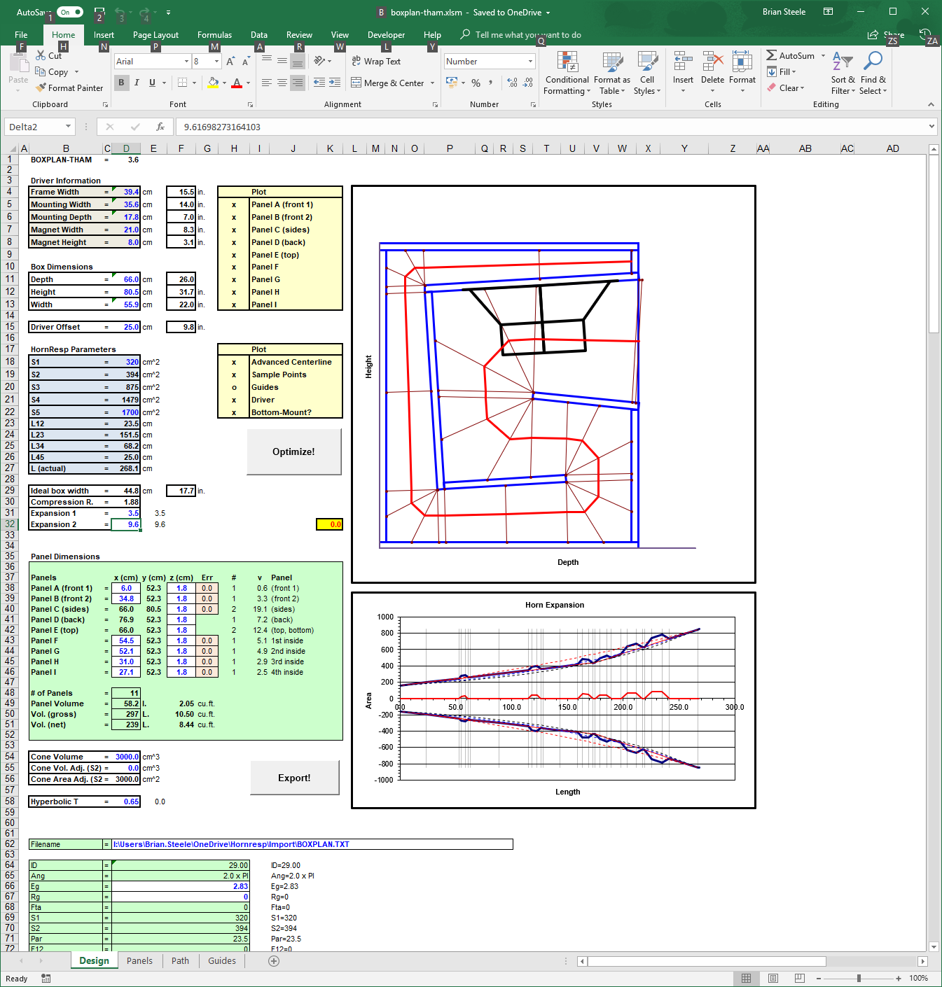

My biggest concern with the sim is the "compression ratio" (CR), which stands at 2.65 when cone compensation is included (it will be larger without). I've seen online recommendations to keep the CR to 2:1 or lower, but no objective basis is given for this recommendation, and there designs online that show much higher CRs, but no real measurements to indicate whether or not the high CR is causing any issues.
If I was going to build this thing (anyone want to send my a free Dayton ND driver? LOL), I'd build it and do distortion testing at different input levels, to see if it looks much different than I'd expect before published Xmax is reached. I'd also try different methods of loading the front of the driver to see if unequal pressures across the cone can be reduced. Methods like what CV used for their bass bins for example (see attached image).
Objective data really seems to be missing (or not easily accessible) about the CR issue.

Adding in "cone compensation" should increase the CR though, as basically Vtc is being reduced in the process. In the current version of my THAM workbook (3.6), I'm calculating the CR as Atc/(S2+Vtc/W), where "W" is the width of the horn, in order to take into consideration the impact of Vtc on the CR. Interestingly enough, once you look at it that way, the CR of the Danley designs looks pretty high, but I haven't seen any complaints about "cone fatigue" with those designs. OTOH, Danleysound does use some pretty strong drivers in them!

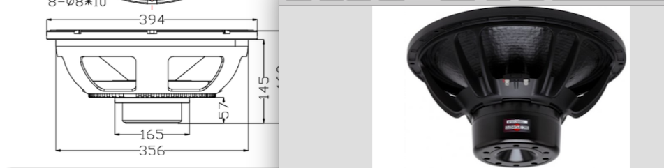

Shipping weight might be 25lbs, though it appears net weight is 20.75lbs.
For comparison, the neo B&C 15SW115 with 13.5mm Xmax and 30Bl is 26.5lbs, 5.75lbs heavier, when you compare the depth of the magnet structures, easy to see where the weight and increased Xmax come from.
Regarding compression ratios, the PN395-8 Mms of 150g appears to be in line with drivers of similar Xmax used in horns.
Mechanical limits and Xmax are separate ratings, doubtful that Dayton would be more "conservative" in rating this driver's 6.5mm Xmax than any others.
The Dayton PN395 has a 6.5mm Xmax and basically a 24mm Xmech, for a ratio of 0.27
The B&C 15SW115 has a 13.5mm Xmax and 30mm Xmech, for a ratio of 0.45

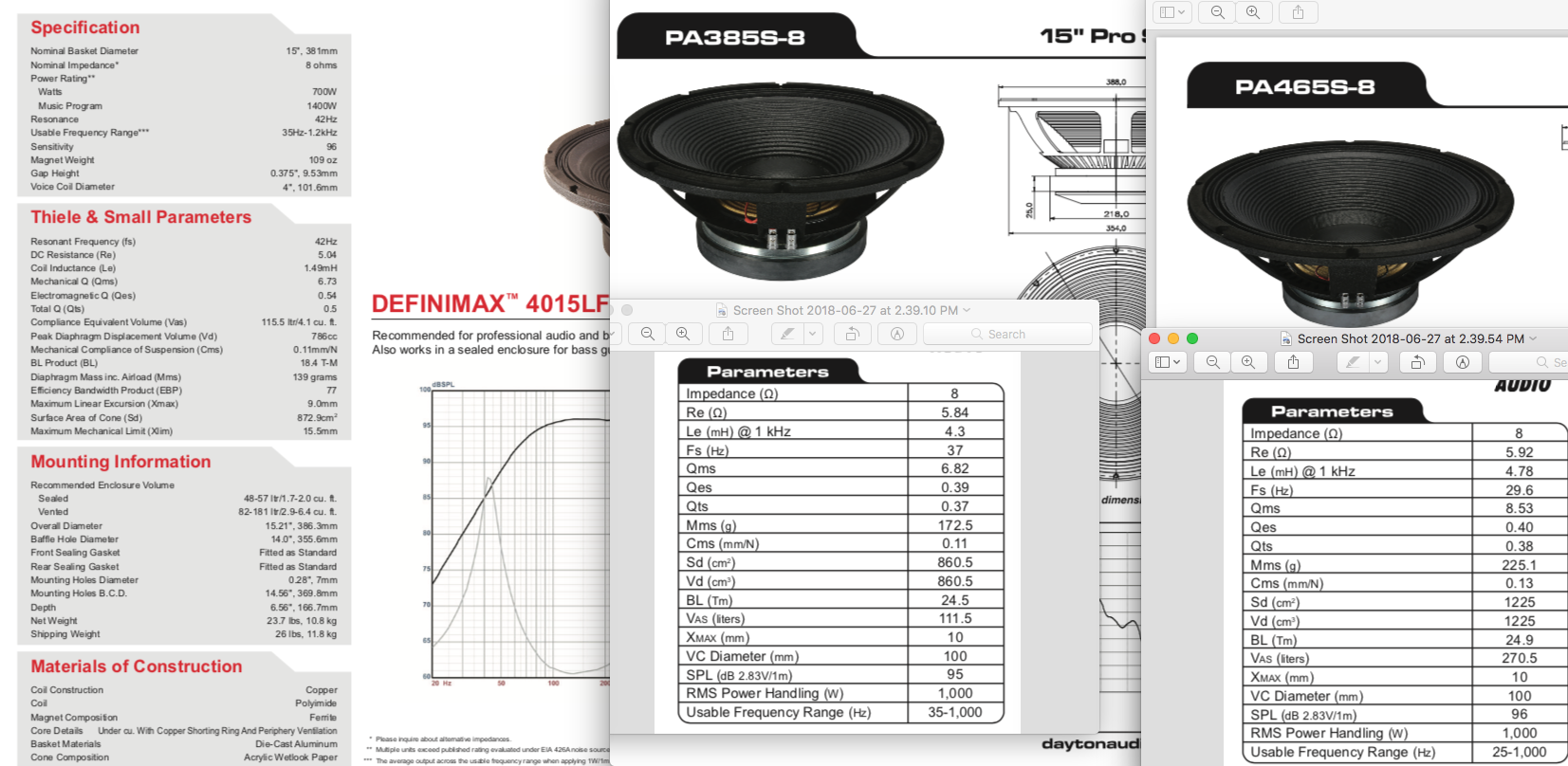

The PE website quotes the PN395's Mms as 150g, and the PA385's Mms as 230g. They both feature 4" coils.
The PA385 however has a longer Xmax, 10mm compared to 6.5mm, and a higher power rating (1kW compared to 800W), so a good chunk of that extra weight might be caused by the longer and perhaps sturdier voice coil.
PE boasts about the stiffness of both cones (the PA385 uses a kevlar/paper mix and the PN395 uses a fiberglass/paper mix), so I've left a question on their site, asking which of the two is stiffer :).
The Definimax 4015LF driver has a publishes Mms of 137g, a 4" coil and a 9mm Xmax, and a rating of 1.2kW. The cone is just "coated paper", according to the PE website. The specs suggest a much lighter cone than the PA385, as the Xmax is pretty close, and the power rating is actually high, suggesting that there might not be much difference between the weight that their coils are contributing to the Mms.
1)The PE website quotes the PN395's Mms as 150g, and the PA385's Mms as 230g. They both feature 4" coils.
2)PE boasts about the stiffness of both cones (the PA385 uses a kevlar/paper mix and the PN395 uses a fiberglass/paper mix), so I've left a question on their site, asking which of the two is stiffer :).
3)The Definimax 4015LF driver has a publishes Mms of 137g, a 4" coil and a 9mm Xmax, and a rating of 1.2kW. The cone is just "coated paper", according to the PE website. The specs suggest a much lighter cone than the PA385, as the Xmax is pretty close, and the power rating is actually high, suggesting that there might not be much difference between the weight that their coils are contributing to the Mms.
1) The PE website gets some details wrong. According to the spec sheets, the 15" PA385 has 172.5Mms, the 18" PA465 225.1Mms, still less than 230g.
2) The PA385 is pretty stiff compared to the Definimax 4015LF.
3) The spec sheet I have lists the 4015LF Mms at 137g, and Pe at 700 watts.
Though the higher power inside-outside wound PA385 coil may be heavier than the 4015LF, the cone is also.
The PA385s were record-breakers for the amount of stink the adhesives put out in the initial high power testing ;^).

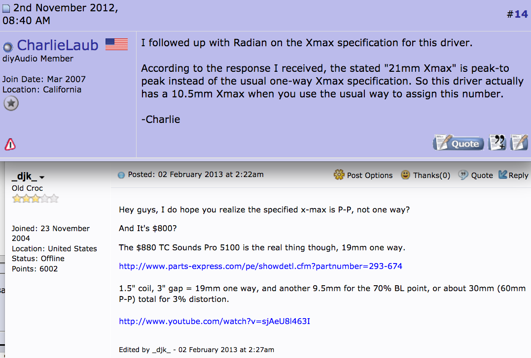

Something about the Radian neo drivers had been bugging me- after a little research from around 6 years ago the reason they seemed too good to be true is because they listed the Xmax incorrectly, it's 21.3 MM peak to peak, not one way.
Hence the short magnet structure and a surround befitting a 10.65mm Xmax.
Radian 2218 NEO? 21mm x-max
Oh well, let's return to the regularly scheduled New Dayton Neo driver discussion...
According to the spec sheet at the PE link below, it's 230g. Also, if you plug the parameters as published on the PE website into Hornresp, Mmd calculates to 220g, which is higher than the 172.5 Mms that you're quoting (Mmd should always be lower than Mms).
Link: https://www.parts-express.com/pedocs/specs/295-040s.pdf
I believe that there were some "issues" with the PA385 when it came out. One forum member purchased one and measured it, and the t/s params were quite a bit off published. Fs was right, everything else was way off, so it wasn't a matter of "break-in". With a bit of digging, it should be possible to find the thread in question.
If the PA385's Mms is actually 172.5g instead of 230g, this suggests even more that the cone of the PN395 might be pretty stiff, as stiff as that of the PA385, as that 22.5g difference between the Mms of the two of them could mostly be as a result of the PA385's longer, heavier coil.
Brian,
I like your design from post #16, but I have a depth restriction of 22”. How could I modify that design to accommodate?
I was unable to find a solution that's 22" deep. You might have to look at a single-fold solution, or something like the Keystone. If anything, this driver wants a larger box, like this example - 26" deep and 22" wide
