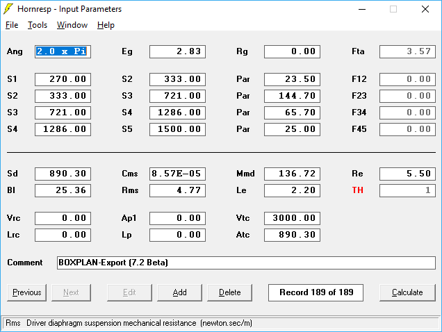

Also the Hornresp input screen would be helpful so I can sim the driver.

^ There isn't one! I also near lost my mind trying to find dimensions for the 15" and dual 12" versions that Art spoke of.

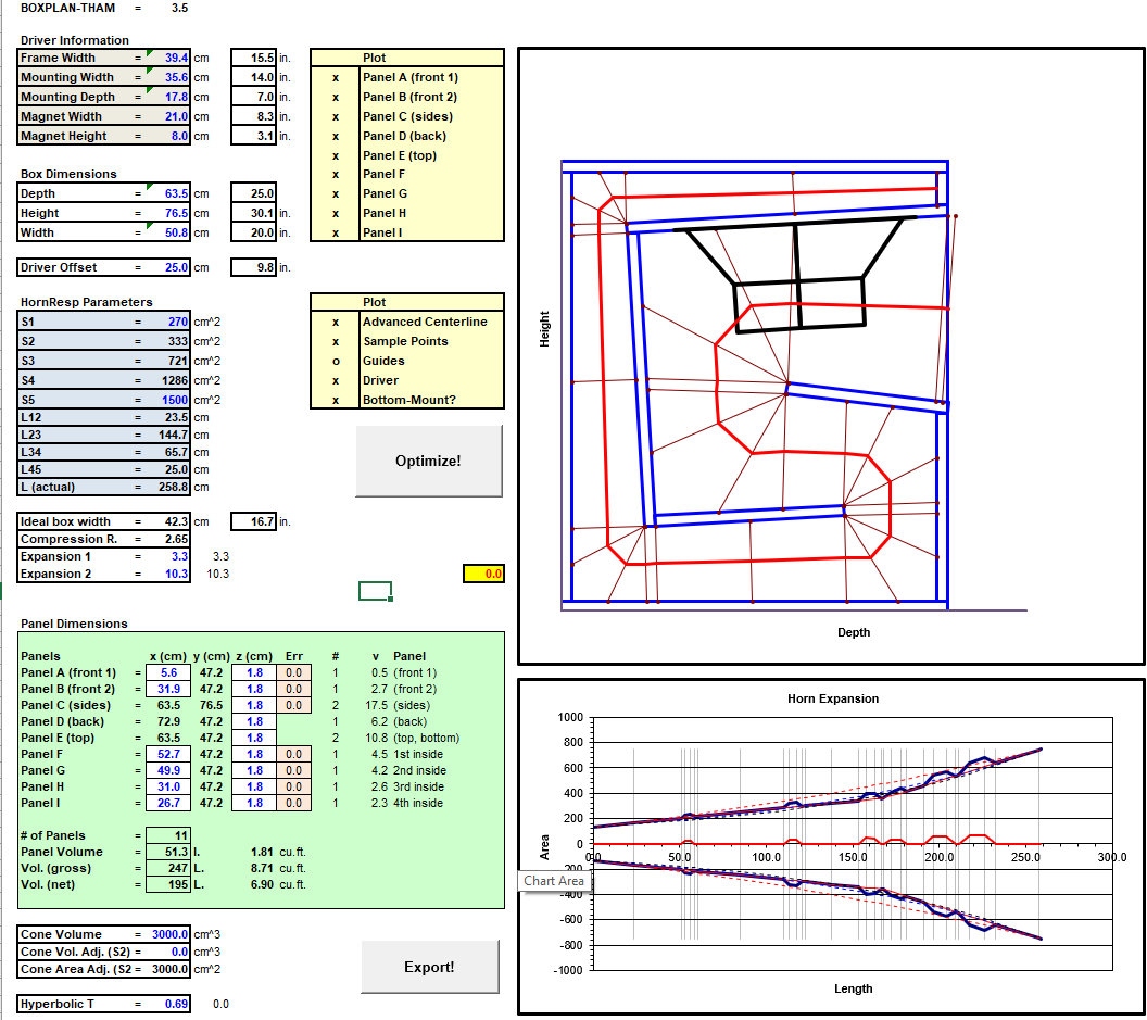

I was unable to find a solution that's 22" deep. You might have to look at a single-fold solution, or something like the Keystone. If anything, this driver wants a larger box, like this example - 26" deep and 22" wide
There is this possible option - make part of the side of the TH removable, like illustrated in the attached diagram. If you then turn the TH around and then rotate the TH so its mouth is facing down (and therefore blocked by the floor), and finally remove the side panel as shown, that will affectively move the mouth to the side, and the box's "depth" will now be 22". Stack two of these side-by side and you'll also get some midbass gain towards the front.
The removable panel should have the same area as the TH's horn for this to work without having a significant negative impact on the TH's performance.

Thinking about it again, I wouldn't extend the side-mouth to the end that way, because the box will likely flex because the edges of the mouth will not be braced. I'd brace around the mouth and cut the removable side panel as shown, so the mouth (whether it be on the front or the side) remains properly braced.
