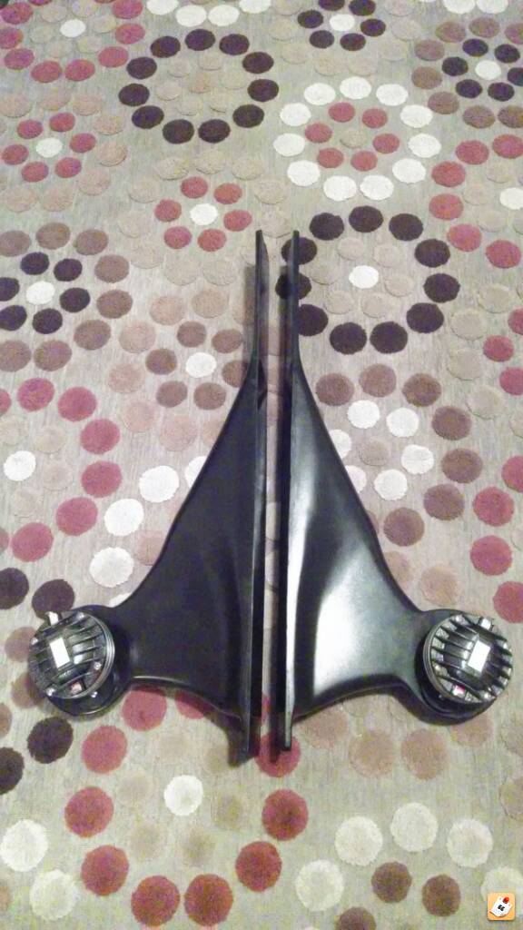

This is an Image Dynamics horn. As I understand it, it was designed by Eric Stevens with consulting by Bruce Edgar. (Edgarhorn was literally next door to Image Dynamics, in California.)
These horns were designed to be placed under the dash of a car. One of the odd things about the Image Dynamics horns was that the vertical height is very VERY short. In the horn body, you can see that the height actually drops down to a fraction of an inch.
So...
What the heck is going on here?
What's going on here is that the horn is designed to be mounted at kneecap level in your car. By constraining the vertical height, something happens which is probably the OPPOSITE of what you would expect. You would think that it would create a very narrow beam, but it actually does the exact opposite. By constraining the height, it basically makes the vertical directivity VERY broad.
So, "The Shark Fin" is doing the same thing, but it's flipped 90 degrees, so that the *horizontal* directivity is broad, and the vertical directivity is defined by the walls of the shark fin.
Again, this is basically an Image Dynamics HLCD that's been flipped on it's side.

Next up, why is the horn mouth triangular?
That's for shading. Here's how this works:
If you are standing in the back of the room, the beamwidth of the Shark Fin will be *narrower* for you. Because, remember that the *narrower* the slot, the *wider* the beam. The way that a constant directivity horn works is that it takes energy and it spreads it out into a beam. If the beam is narrow, the SPL will be high. If the beam is wide, the SPL will be lower.
So the net effect of the triangular slot is that the horizontal beamwidth of the shark fin will be narrower and narrower as you go further and further backwards in the room. By narrowing the beam, you raise the SPL, which counteracts the reduction in SPL caused by distance. Conversely, the *bottom* of The Shark Fin will have broad horizontal directivity, lessening the SPL closer to the speaker.
The Shark Fin is basically a speaker with a wide beamwidth at the front of the room, and a narrow beamwidth at the back of the room.
