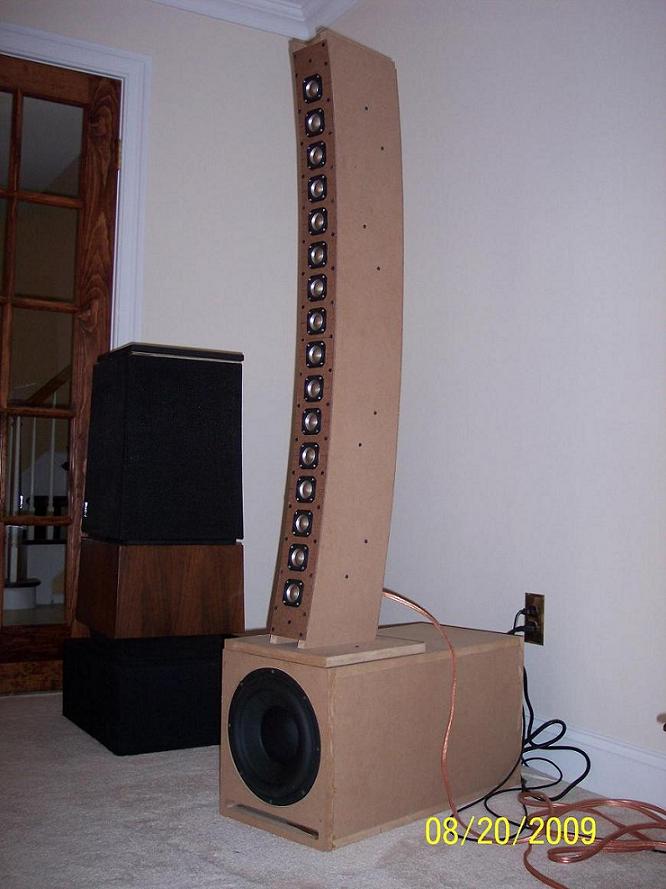

With a focused array you can cross to a point forward of the diaphragm where the acoustic centers match almost perfectly with a theoretical +3db for each doubling of sources (and +3db for halving of impedance depending on amplifier). Of course before and beyond this point you will incur combing (assuming the offset is vertical in nature, so will the combing be), with a sufficient waveguide though it's moot. (..as opposed to a relativly "free-field" condition as seen below.)
As for waveguides, remember that as you "squash" the directivity pattern from the driver's output at any given freq. - that you obtain gain. In particular you can squash the horizontal to achieve vertically improved dispersion at the exit (to a point) - so what was once perhaps a 3/4 of an inch vertically around 18 kHz, could be 1/4" horizontally (squeezed) with the vertical expanding to MORE than 3/4 of an inch vertically at that freq.. Of course most waveguides that are designed to turn point-source compression drivers into line sources are "focused" more on a vertical that has little pressure BEYOND it's vertical exit - so that in combination with the same drivers: there is little combing interference when properly combined in a large vertical array.
This picture shows a speaker where the fullrange drivers are focused in order to achieve treble gain comparable to the gain of the drivers at lower freq.s without significant combing at a certain distance and over a much more narrow vertical window than the midrange.
