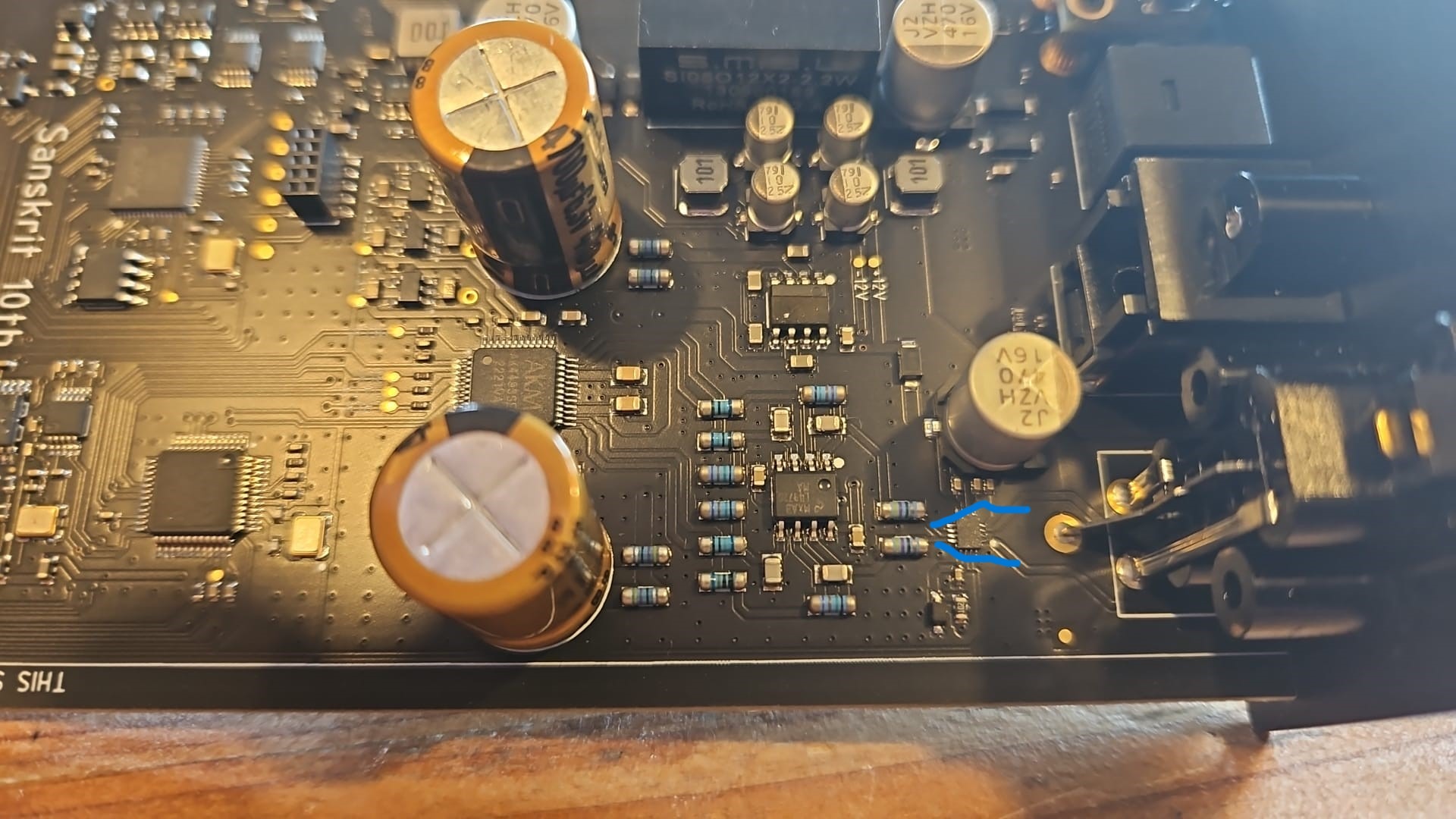

Hello Gents,...been a while as I was moving to a new home. Recently my DAC, a SMSL sanskrit 10-th edition MK-III, has broke down. Everything works but no output at the RCA's. Installed my old MK-II and it works for now. I'm looking for a new DAC in the range of € 200,-, maybe a bit more when it's worth it.

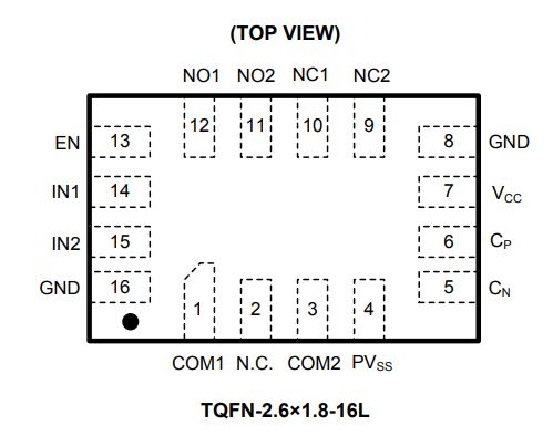

Hi Willem, chances are likely that the (serial!) muting IC at the outputs has failed. Be careful as the construction is made so that it is very hard to put together if you pull all the cables off the front cover so please do not slide the mainboard fully out of the casing. Don't say I did not warn you 🙂
If you have signal at either side of those resistors it is OK apart from the muting IC. Replacing the muting IC can only be done by experienced people with the right equipment. You can bridge the IC and then have no muting but that is up to you.
For some reason these ICs like to fail contrary to muting relays. I suspect ESD via the RCA cables. All I know is is they are semiconductor based and no comparison to muting to GND with relays plus they fail. Be assured the device performs sonically better without the SGM3710.

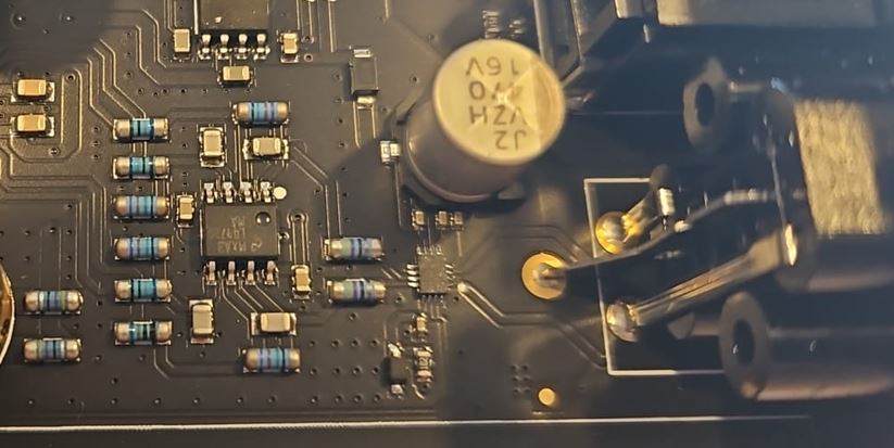

Just look at the picture and see the connections. You will need to connect a wire in each channel from the resistors upper pins (so muting/switch IC side) to the output pins of the RCA.

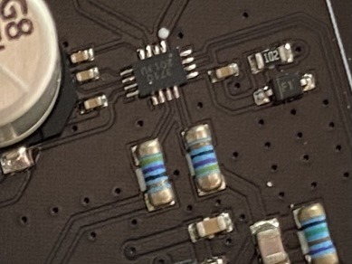

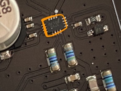

Or technically better: just with very thin tinned copper (solid) wires over the PCB tracks of the muting IC. Removing the IC with normal DIY tools is a no no. Maybe you can cut the pins with a fresh/sharp scalpel but please no mechanical force as the PCB material is brittle. Where are you located in NL?
Or install a NAIS AGN series micro relay shorting RCA L + R to Audio GND at power on and releasing after 3 seconds. Thinking in solutions. It is a simple circuit out of the signal path and therefor both effective and non intrusive.
Anyway you have been informed. Good luck with the repair.
And eh... if you read here again that relays are unreliable just think a second of SGM3710 🙂
Added a picture before where you can clearly see the IC is “in between”. Also on your picture it is clear as glass what the signal paths of L and R are. Do the math. If this is too hard just leave it.

Or make a square out of a bit of thicker single ore copper wire, fitting over the traces, and add some solder. But before heating it up, add something to lift the IC upwards using some glue or tejp. The heat the copper wire until it lifts off applying som lifting force at the same time as heating with an iron...!?
