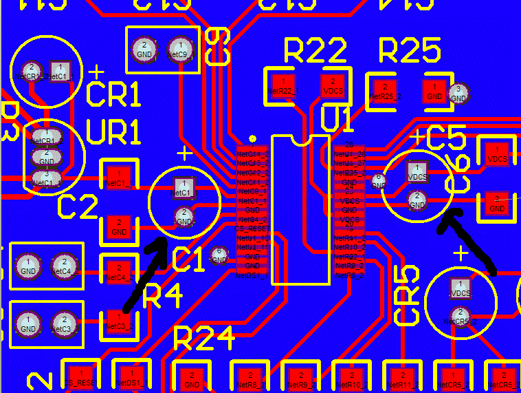

Cobra2 said:you could moove the small caps (C2,....C6) closer to the CS84xx pins, IMO.
Arne K
Could you be more specific about this? I do not understand what is your wish. If you mean placement on the PCB, that will be done later, these are only schematics for the moment and do not relate to the PCB .
Pred

pcb question
I have started to work on a pcb. I did some of it but have a principal qustion on grounding. I have red recomendations of Guido on grounds and that he connect the ground of a chip right at the pin, then he has a connection to the capacitor (or two) but does not connect them to the ground (if they are leaded components).
I have included part of the layout. Blue is bottom ground plane and red is top copper. If you look at two decoupling capacitors (there is a rather ugly black arrow pointing at them ) in my opinion they are quite close to the chip it self. I can put the via to the ground plane near the chip pad and it will be closer 2.3mm then if I use capacitor lead for the grounding. Is these 2mm so important. I ask this since it is also helping my layout in a huge way. If I use separate connection then I would have to make the ground plane and then connect by hand every other component to it. A lot of work and rather prone to errors.
Do you hace any sugestions on this subject?
Ulas said:Pred,
Before you waste more time on a PCB layout and before you waste any money getting PCBs made, you should read and understand the datasheet of every part used in your design. Pay careful attention to input requirements and output specifications.
Thank you, I'll might just do that.
Pred
