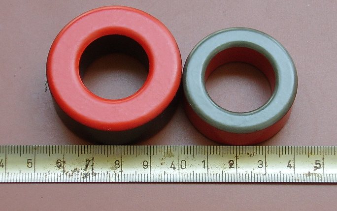

I can trade 8 pcs of micrometal T184-14 (OD=47, ID=24, H=18, Al=28) for 200*0.08 litz wire if you want (6 m litze = 1 core).
Deal done!
Put please some pictures of it with a centimeter near it,I want to see them!

Here are two iron powder core, on the left side the one I mentioned, on the right T157-2 (OD=40, ID=24, H=14.5, Al=14).
