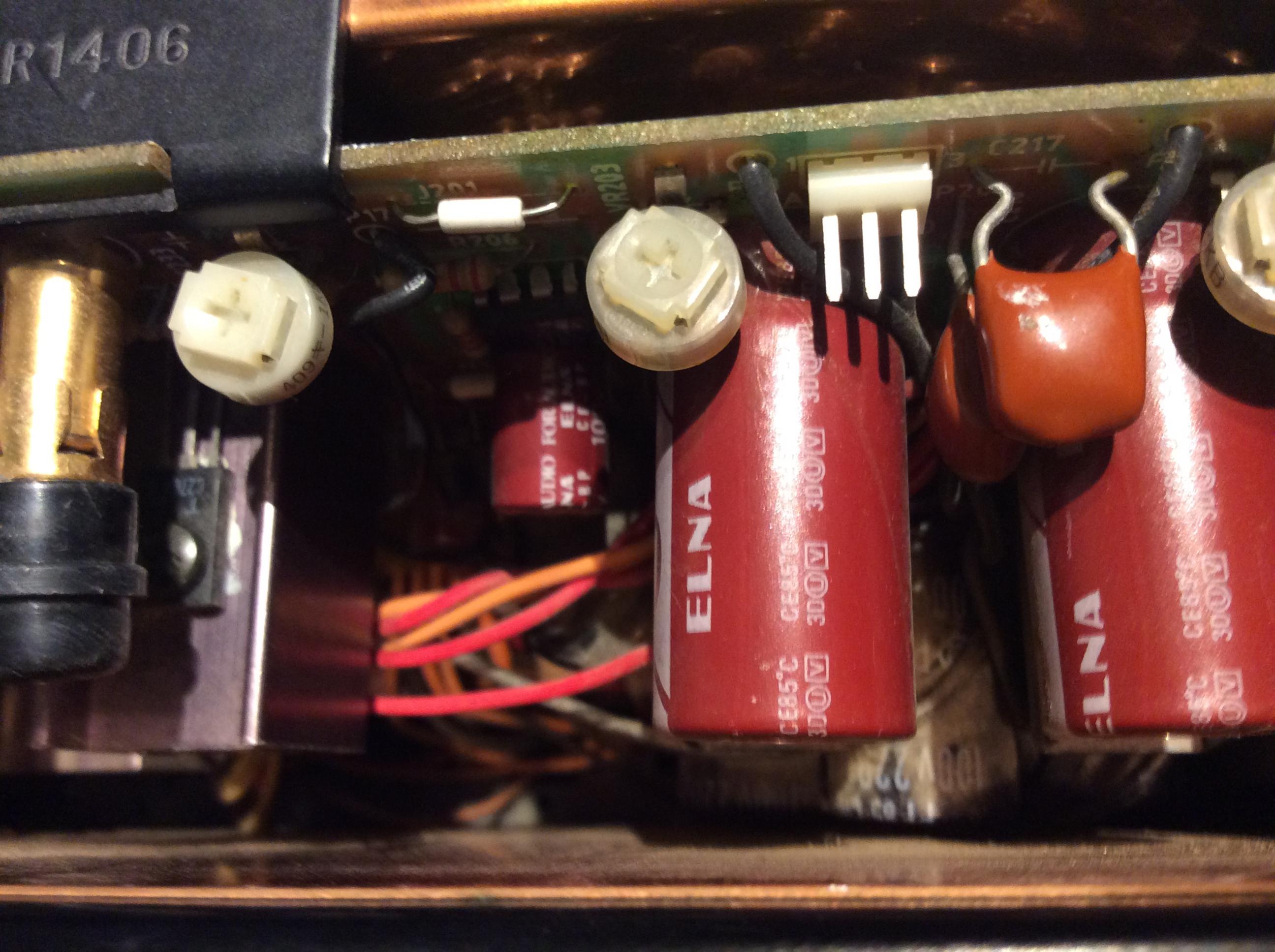

Jan.didden:
Every time you buy capacitors, they are always 10-15% beneath their statet value -> yes? No matter which value and voltage rating? Ignorant?
My #1 post were that i (eod -> precision of my LCR, thats not the colpit) found it incredible that all different values of capacitors shipped, came with the same lack of capacitance !!! (10-15%).
The issue isnt about the specified tolerance for each componet deliveret (+-20%), or how production batches is alike or specifications for the circuit etc etc.
Im in contact with Mouser, and return in original shipment bags etc isnt any problem. Of course i'm gonna pay shipment. But no shipment fee on "replacement" capacitors. Yeah it doesnt quite make sense, but no Panasonic parts are going inside any of my amplifieres. But Rubycon, vishay and Elna.. ( and yes, im gonna messure the parts before soldering! 🙂 )

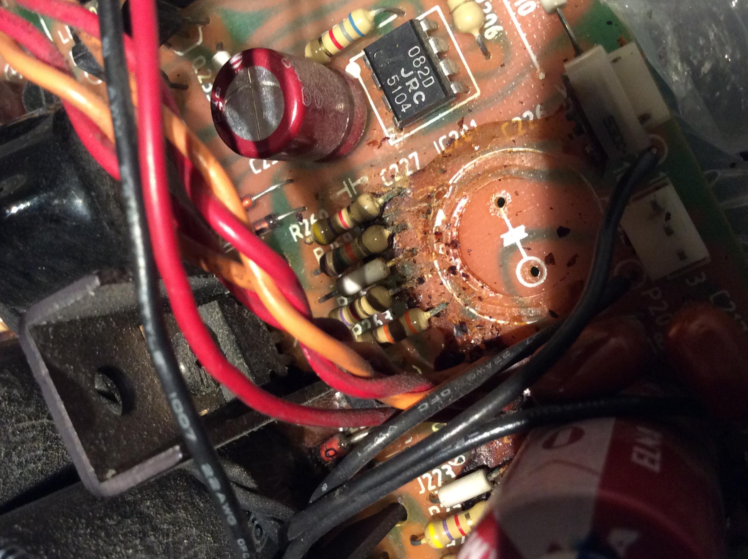

Rather than making hysterical accusations of a "scam" against a respected manufacturer of electronic components, you would have been better served by posting a polite question e.g something along the lines of: "The new
capacitors I ordered are all 10-15% below rated capacity, how can this be?".
In which case you would most likely have received the answer that a number of the posters here have already provided, and which you continue to ignore, and that is that you should "form" the capacitors at working voltage before attempting to measure the value.
As you don't seem to believe anyone here (which makes me wonder why you posted here) maybe you will believe this http://de.tdk.eu/blob/185386/download/5/pdf-generaltechnicalinformation.pdf instead.
In particular this paragraph:
3.7.7 Leakage current behavior after voltage-free storage
The oxide layer of aluminum electrolytic capacitors may deteriorate when they are stored without an externally applied voltage, especially at higher temperatures. Since there is no leakage current to transport oxygen ions to the anode in this case, the oxide layer is not regenerated. The result is that a higher than normal leakage current will flow when a voltage is applied after prolonged storage. As the oxide layer is regenerated in use, however, the leakage current will gradually decline to its normal level.
This will have a bearing on the value you are seeing on your capacitance meter.

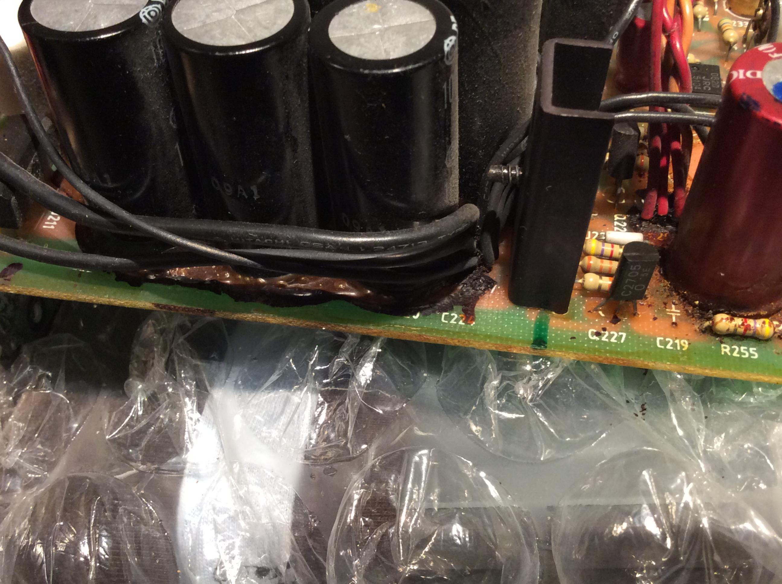

Please tell us this was a joke! Are you trying to fix it or break it?Jmlyd said:desoldering all capacitors/ and transistors for messurement etc.
Clive: You are absolutely right. I got carried a "little" away.. And no 2 chance on editing treadname..
DP96: Nice approach!

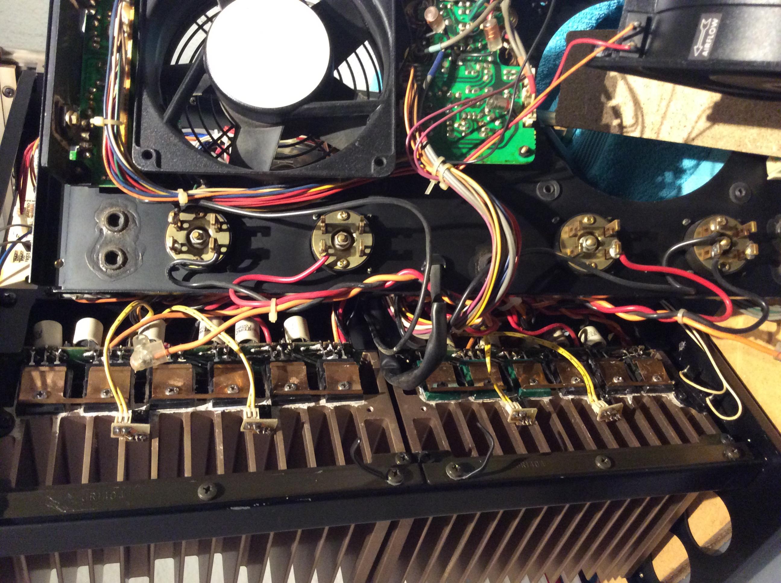

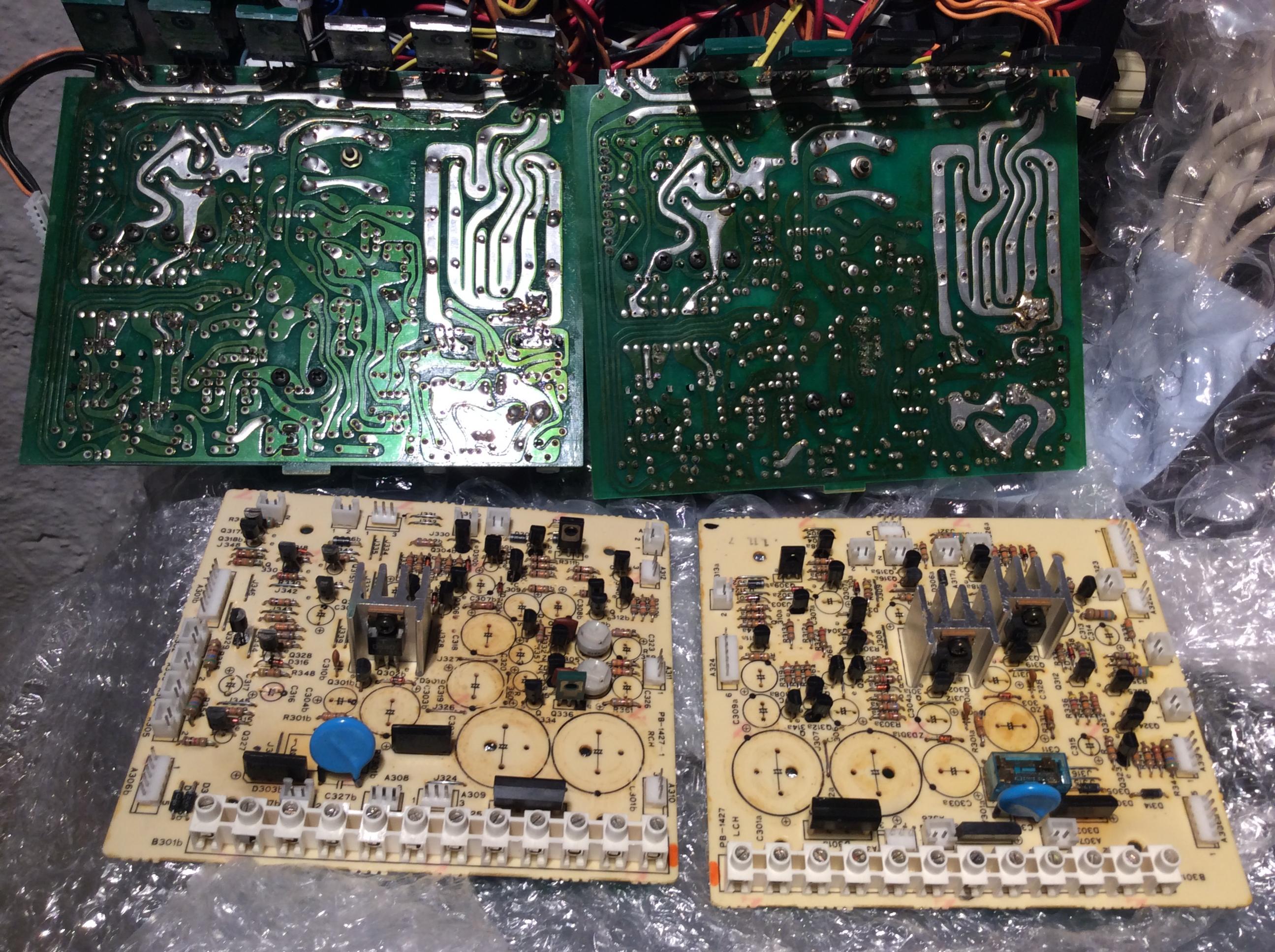

Removal of old capacitors, desoldering 1 leg of most transistors on main amp board for testing with an atlas dca55 to get an indication of Hfe, Vbe an Ic (leakage). As statet before, there is no access to main amp boards when installed. Resoldering most of the circuitry is standard procedure at that age. All is done at lowest possible temperature set at the soldering and desoldering station. Standard procedure when giving old eletronics new wings!
Probing main power boards etc, when amplifier is turned on, is standard procedure. You dont desolder componets just for sake of it!
