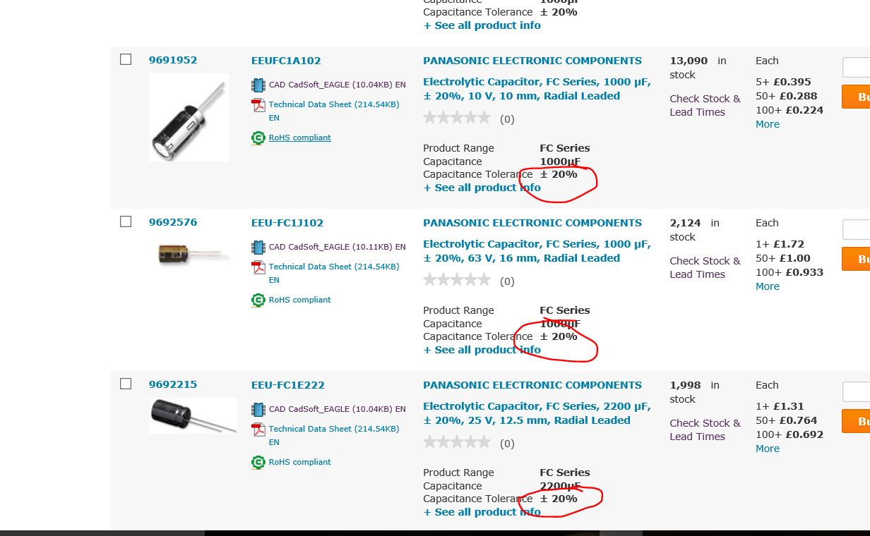

There's no 'trick'. Firstly all the FC series seem to have a -/+ 20% specification. Electrolytics of some years ago were +100% and -50% so things have improved 😉
No electrolytic can be considered a precision part.

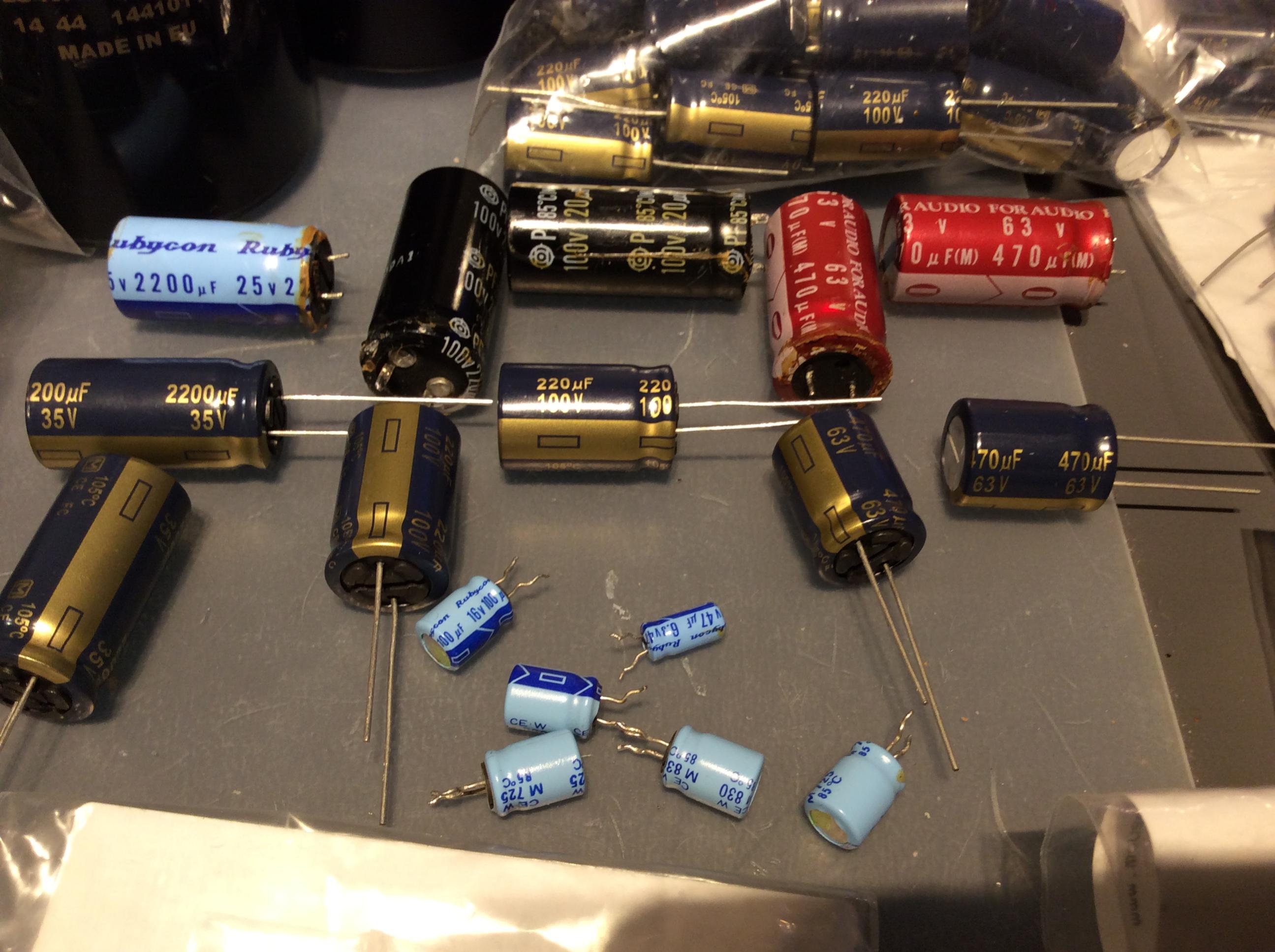

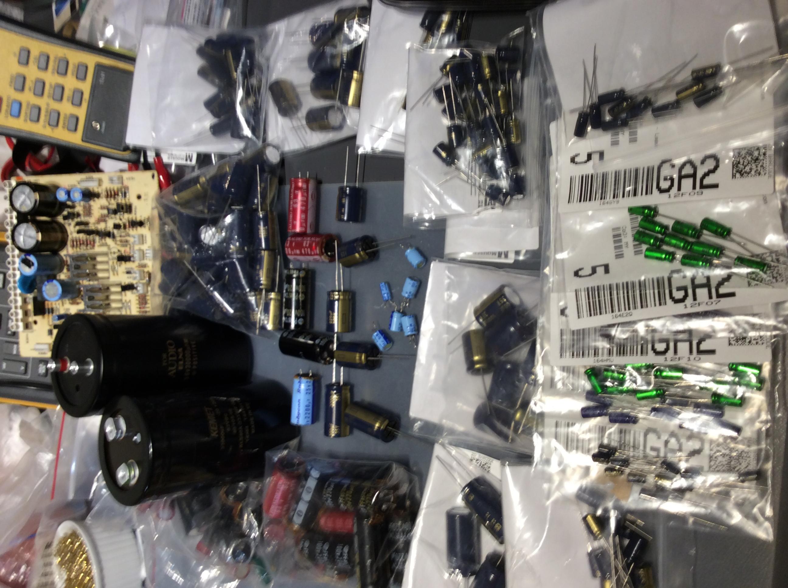

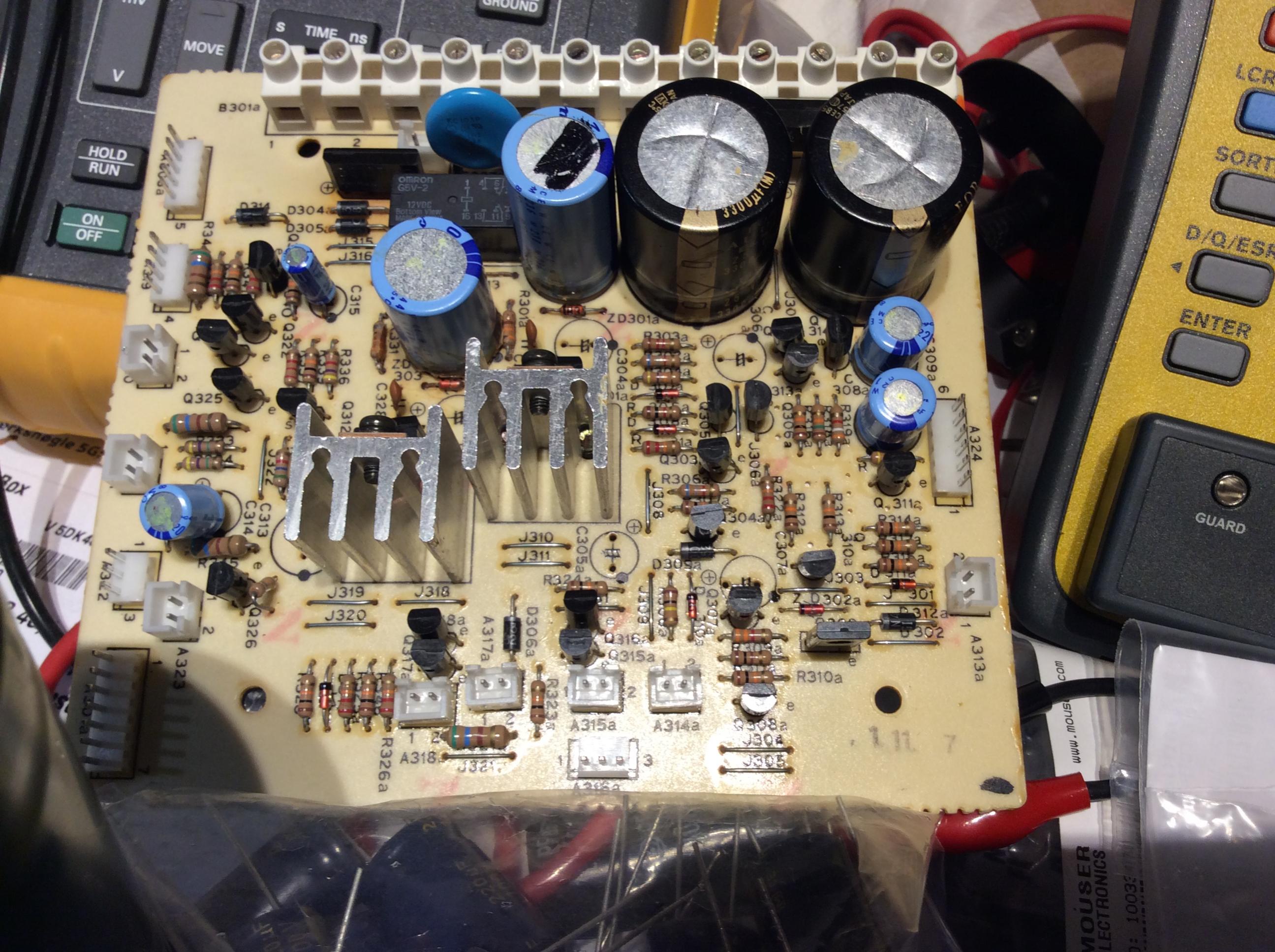

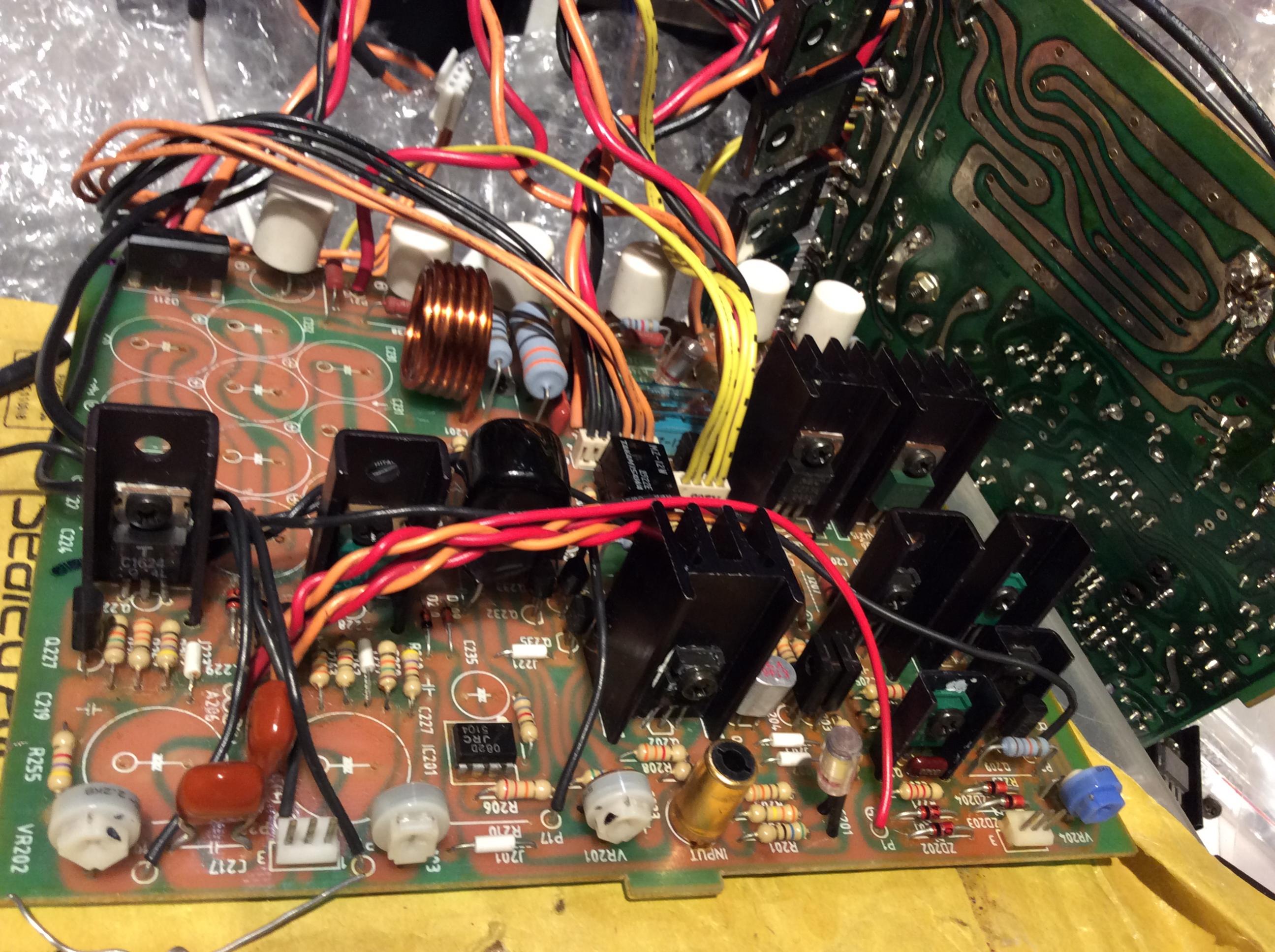

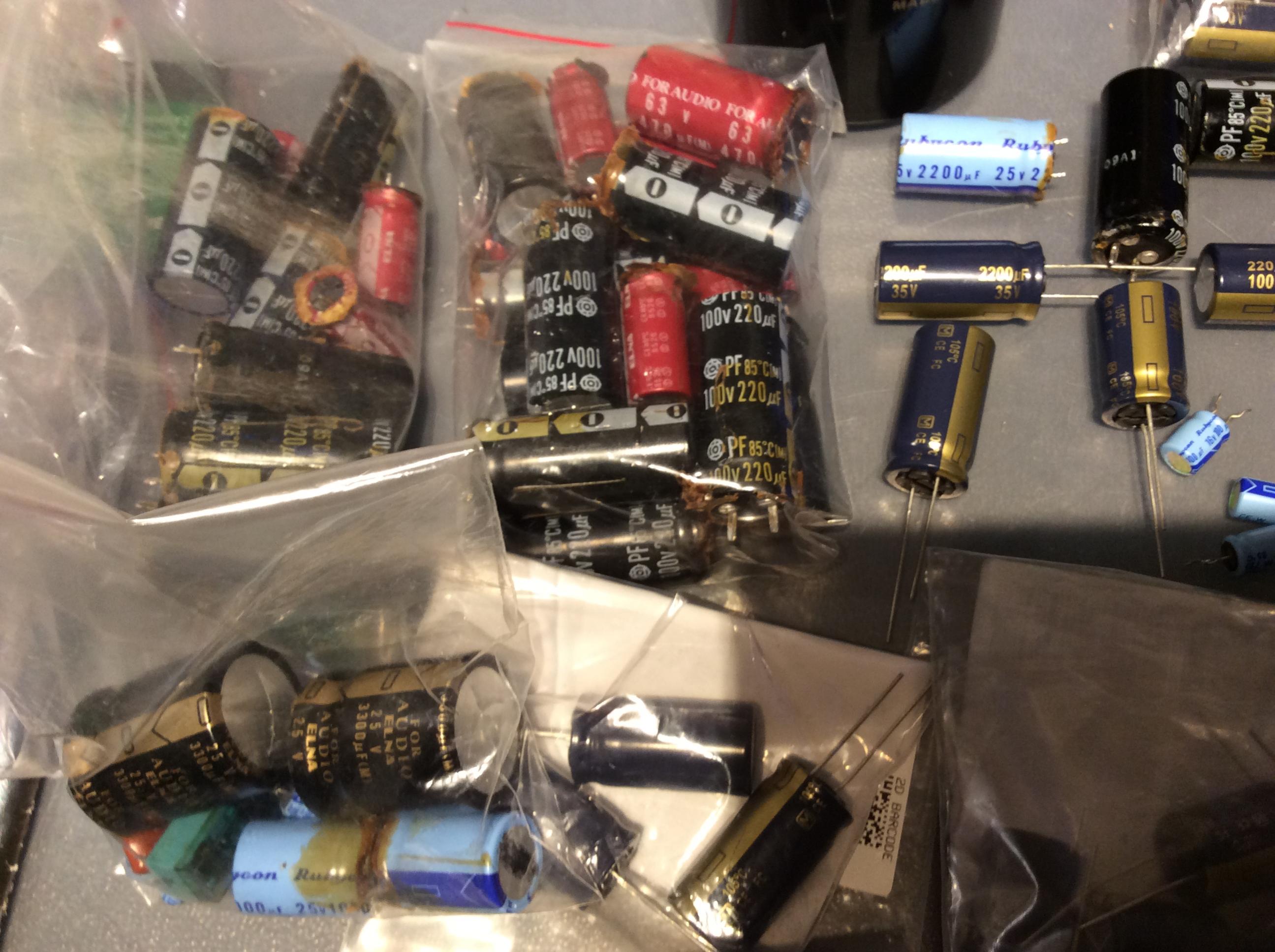

Here some picture to give an idea of size of old compared to new parts.
Lead space on replacement capasitors is same as original.

I cant retrieve the capasitors after installaion. The Amplifiers is constructet in a way, that main amp boards l/r is placed behind 2 huge heat sinks, with all driver fets mountet on each. Just to disassamble the amplifier (40kg) takes awile!
To do this for checkking the capasitance of newly installed capsitors would be quite time consuming.
