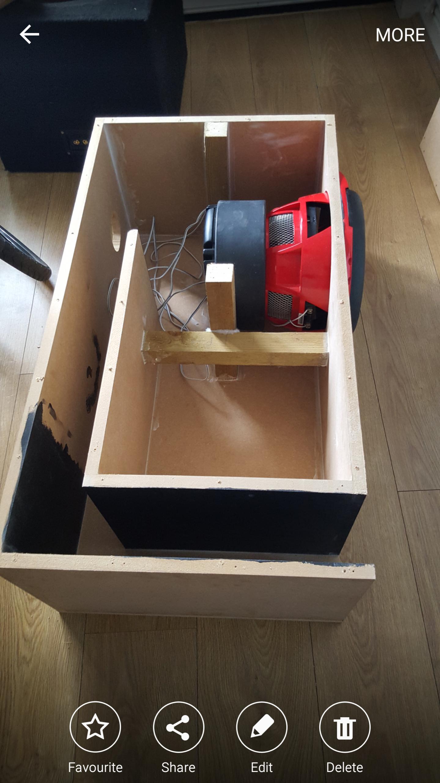

That's one of the pics mate with the top off for. ....

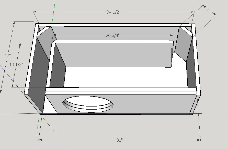

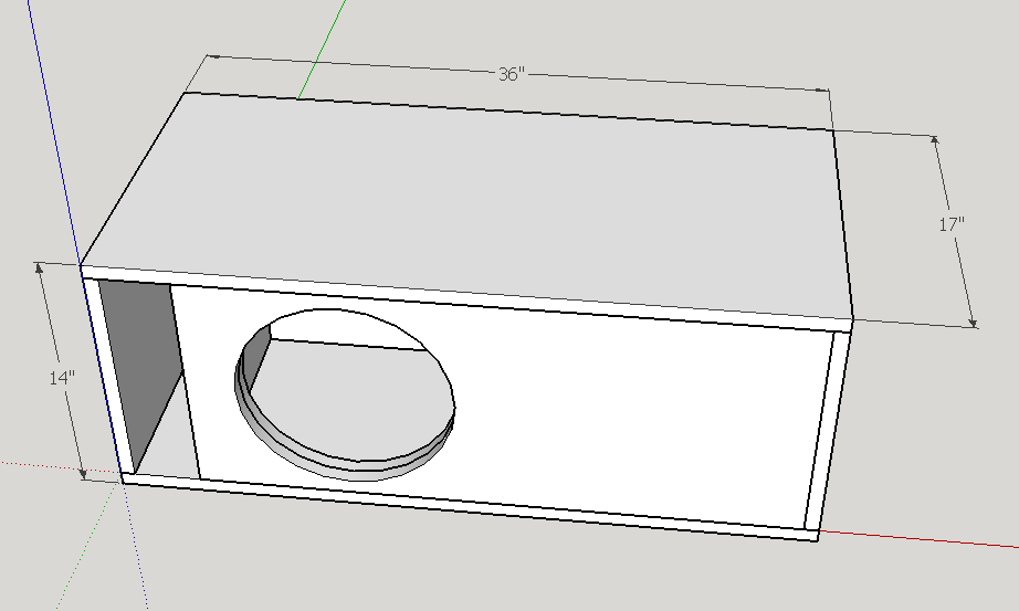

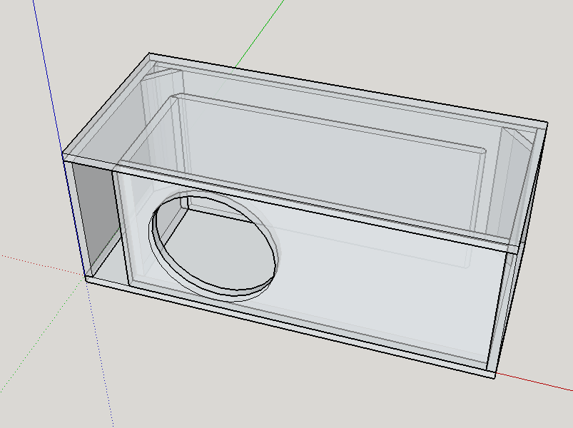

Ok, so here is the proper design with 2.0 cu ft of net volume. I just made it .75 deeper and adjusted the port length accordingly. This should also alleviate any potential concerns about the pole vent having enough room to breathe.
So do you think the problem with the enclosure I built was due to the port area being too small????
Losing the output at lower freq....
I think your port was too small for the size of box you had, and your net volume was too big. There could be other explanations for why your low frequency output suffered as well, but those two things jumped out at me.

Nope, I calculated it as 12.5 x 3.5".
If you are using WinISD, its going to give you a wrong number for port length because it doesn't properly compensate for end correction with 3 common wall slot ports, like what is in the design I gave you. What happens is the port interacts with the sides of the box and it performs like it is longer than it actually is. If you use the length WinISD gives you it will tune you lower than you intend.
The design I posted should be tuned to about 32 - 33 Hz. Tuning calculations aren't an exact science.

So here's my plan...
The box I already have I will add a extra piece of mdf inside it so it's 2 cuft net...
As the port opening is 12.5x3.5 already just need to extend it...
Can you give me the length of the port please...
Cheers

I've modified the same box to 2 cuft and I've extended the port to 45 inches rather than 44 inches as I miscalculated the length some how.. my bad...
It's all definitely air tight...
Thanks to all for your comments and suggestions...
BIG BIG thanks to 'thejessman' ....
The Orion has come alive and it really really pounds almost everything...
Bass around 40hz-55hz is pretty impressive which I thought would be lost due to lower tuning and below 40 I'd guess early 30s the Orion is a BEAST... its really slamming the those lows now...
