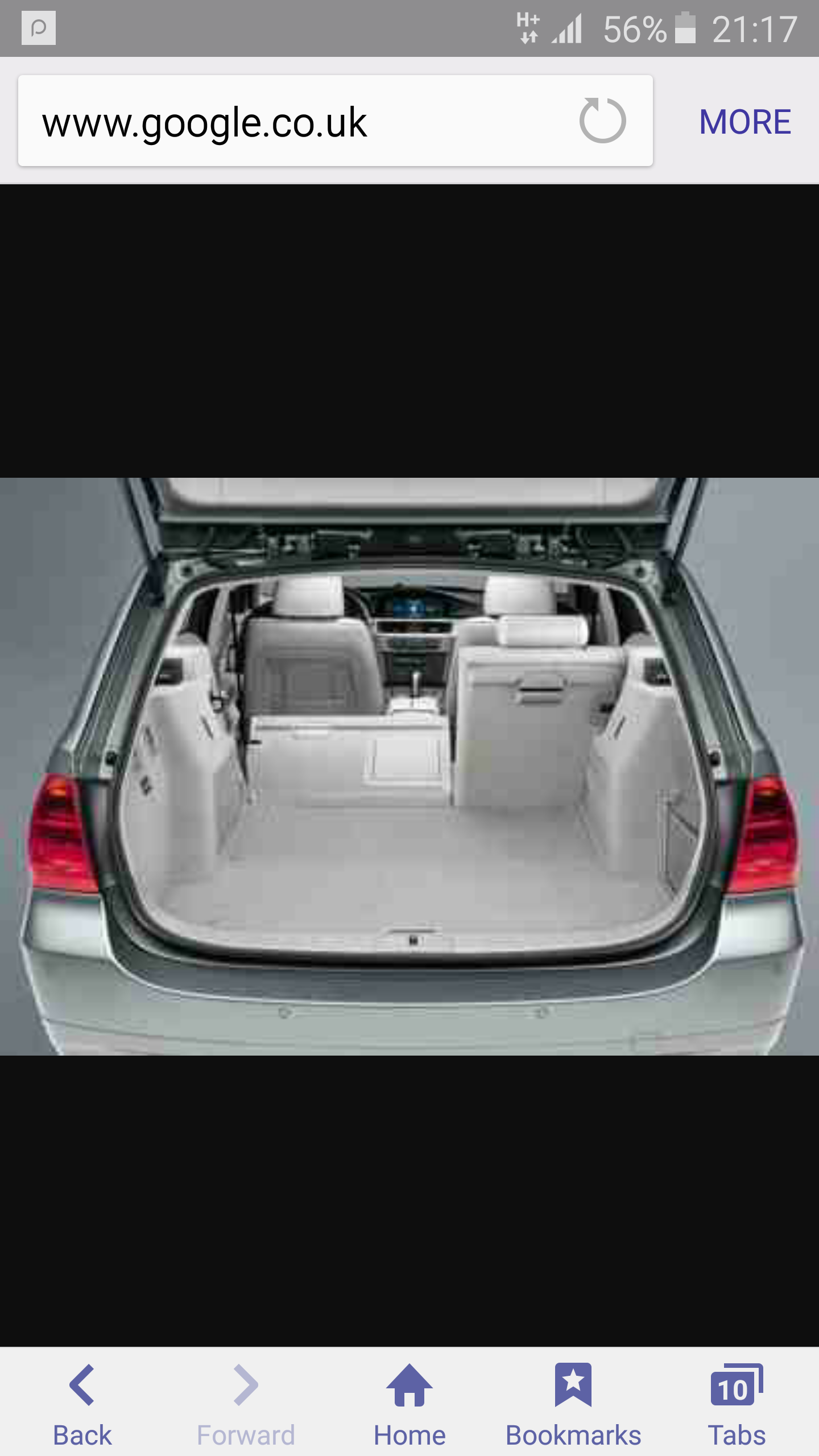

It's a BMW E91 3 series touring/estate...
Does that vehicle have a firewalled trunk?
Sorry mate.. I don't understand what you mean by firewalled trunk...
If it means a separated boot/trunk from the interior than no its a estate like a hatchback....
Hope that makes sense!!!
Ok, I understand. Some European cars have the trunk separated from the cabin by a metal wall, makes getting bass from the cargo area into the cabin very difficult. Fortunately you don't have that problem.

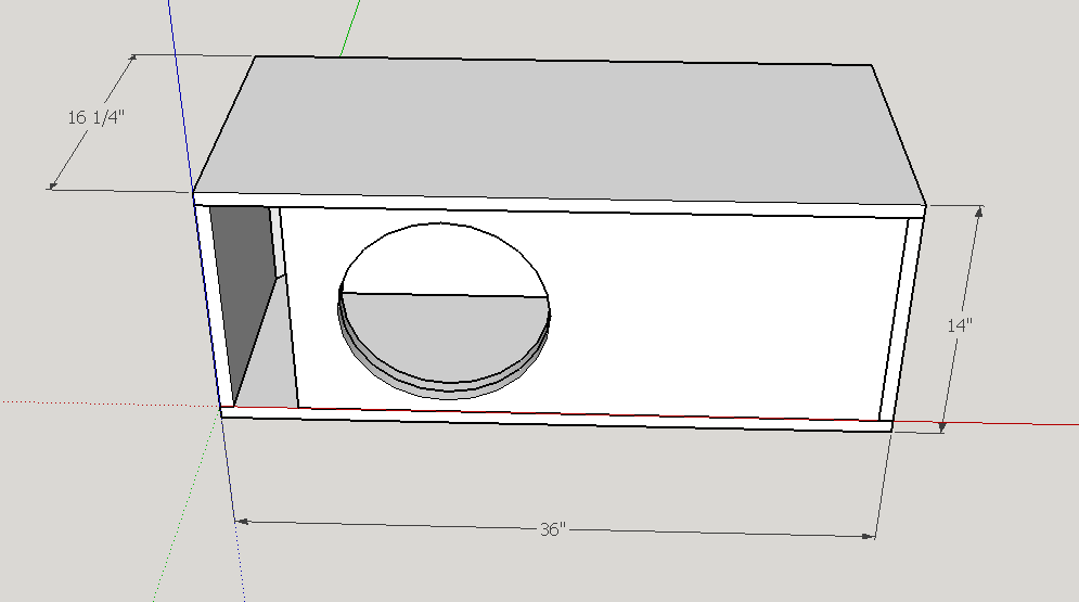

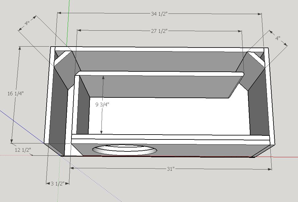

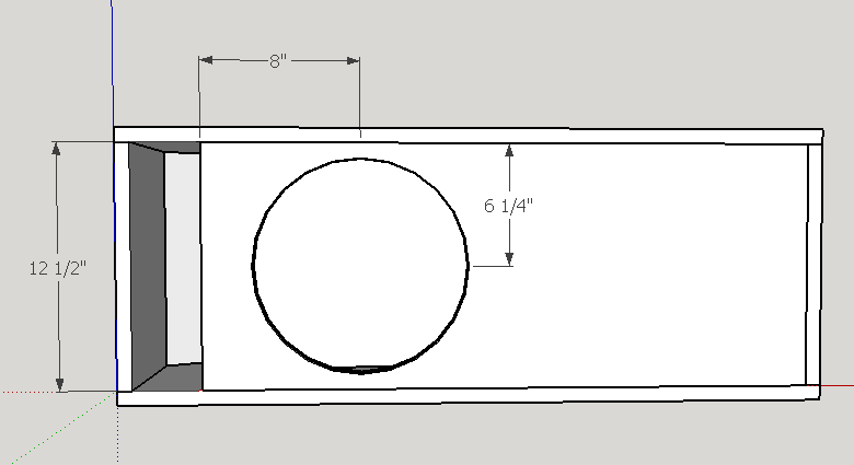

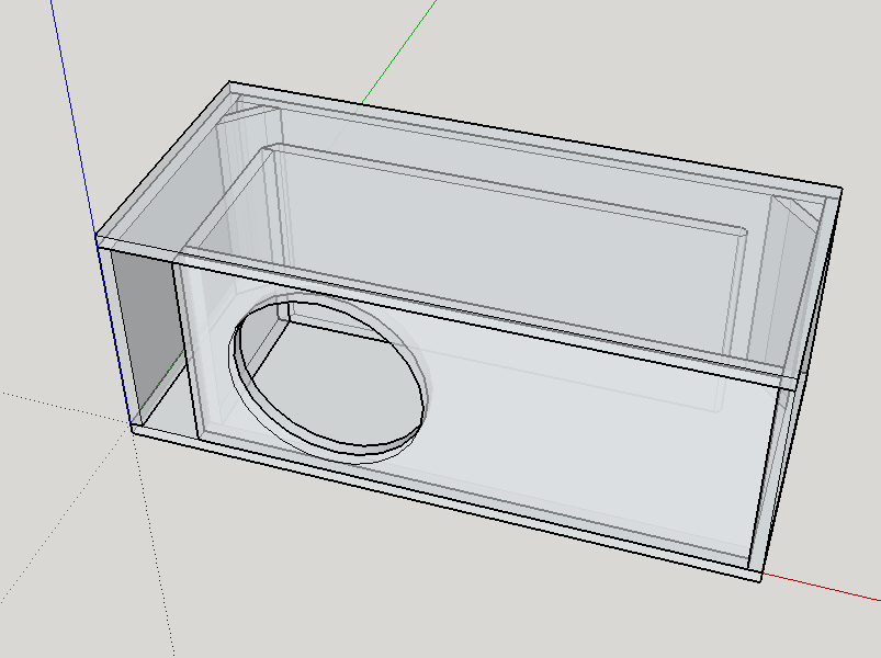

Here is a design that should work well for you. Its 2.0 cu ft net tuned to about 32 Hz with about 44 sq in of port area. I tried to hit a good compromise between port area, tuning frequency, and port length. Nothing is perfect but this should do about as well as you could hope.
The design assumes 3/4" thick material. All panels except the top and bottom are 12.5" wide.
You are going to want to place the box about 4" from your rear hatch for best results.

As long as I keep 2 cuft after all displacement and with 44sq in port area,.. it should be perfect...
I may alter dimensions a little as the depth of the HCCA is just under 11 inches!!!

No prob, glad I could help.
I think you should be good on mounting depth, with how I have it laid out you should have 11.25" of depth available between the top of the baffle and the internal port panel. Those subs sure are deep.
If that sub has a pole vent (pics online suggest that it might), you need to leave at least 1.5" and preferably more between the back of the magnet and any nearby walls.
Not also that Orion says that this driver should be used facing up or down.
Given the specs of this driver, I'd probably use it sealed and if one didn't provide enough bass, I'd use two 🙂.

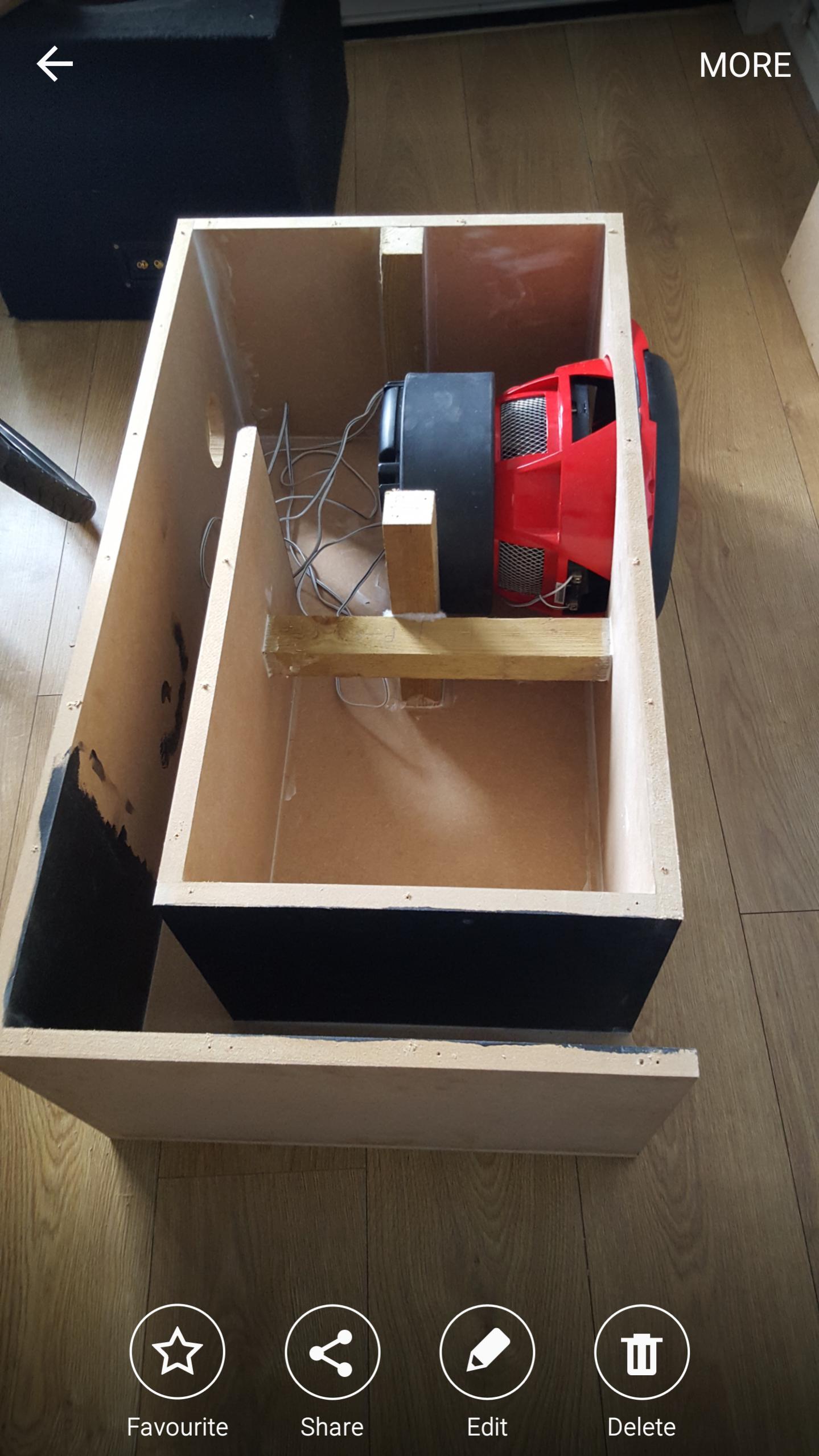

Yes it does have a pole vent so I may move around with dimensions a little...
And I've tried it in a sealed box a little larger than recommended and it sounded s+++...

Curious. I've heard two of its 15" cousins in a sealed box and it sounded pretty impressive. Not as loud as a vented box can get, but it good deep and sounded good playing everything (rather than being "one-note" and capable of sounded good playing only rap and the like).
Note: location in the trunk can also make a noticeable difference to how a subwoofer sounds (upper range of its frequency response).
