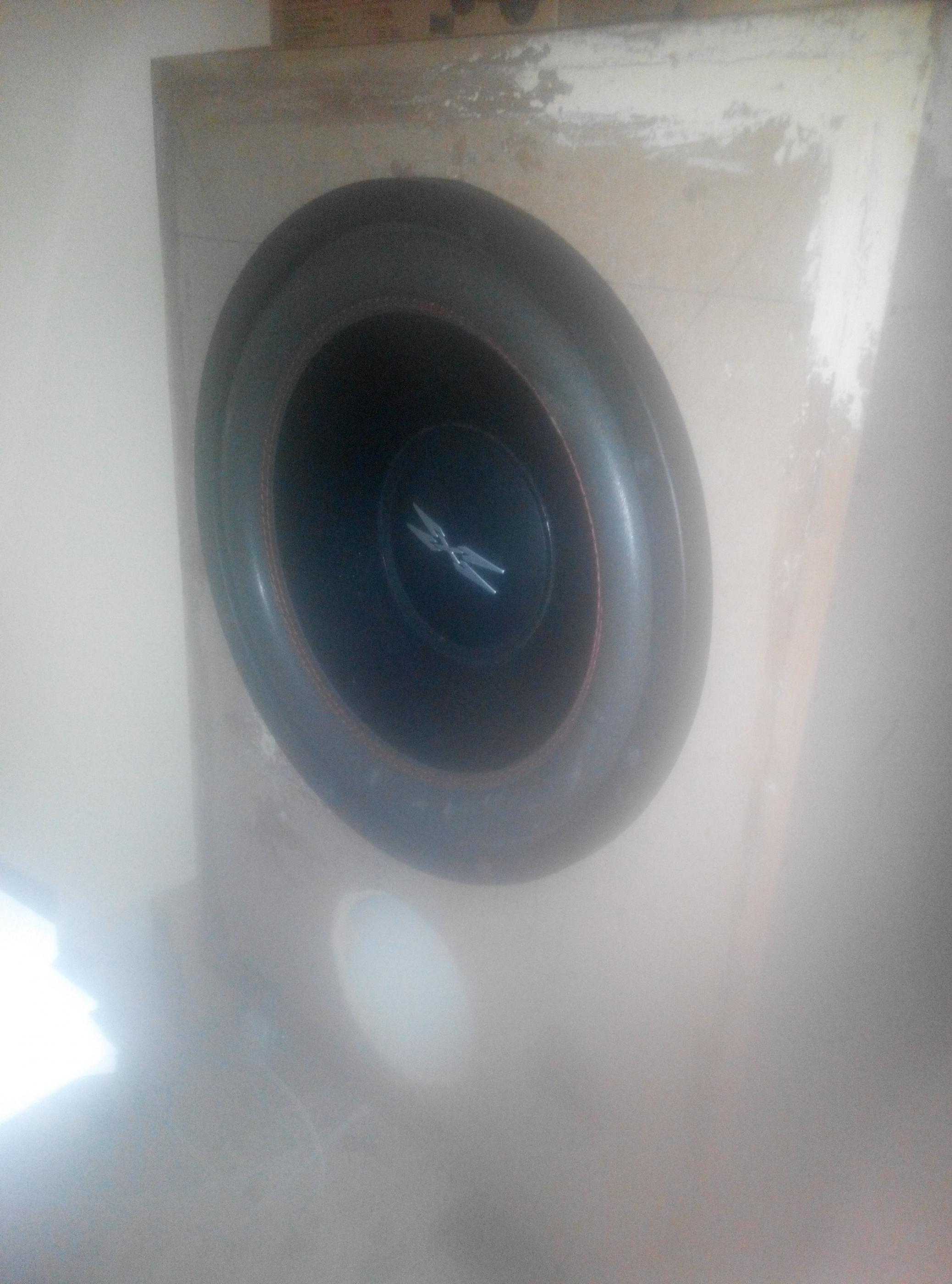

The box that I built, (won't let me attach pics) low bass sounds really hollow, and at times sounds if the sub is bottoming out... Not playing below tuned frequency. It drops well but lacks the deepness in sound and have lost upper bass noticeably which is accepted tuning at lower freq. But still plays mid bass well...

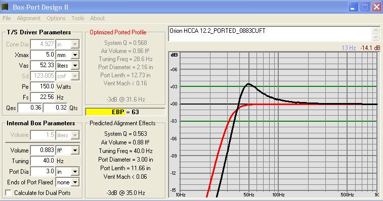

Hi abbss1

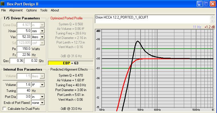

I think your box tuning is off. According to the thiele/small parameters, a 1.6cuft tuned to 40Hz looks like the first plot.

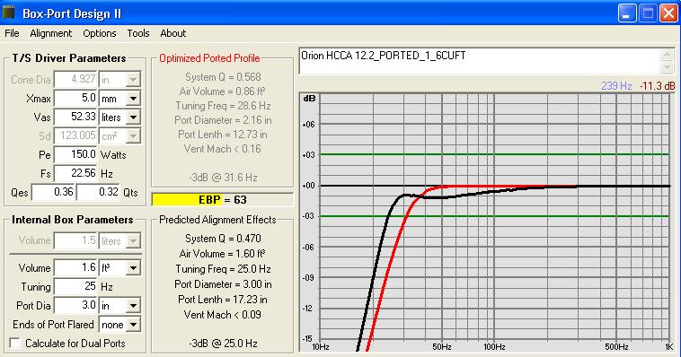

For the same volume (1.6cuft), I would tune to 25Hz (second plot).
The optimum volume is 0.86cuft. tuned to 28Hz (RED PLOT).
This is for home use. If you're using it in a car, then the tuning is different.
Hope it helps.

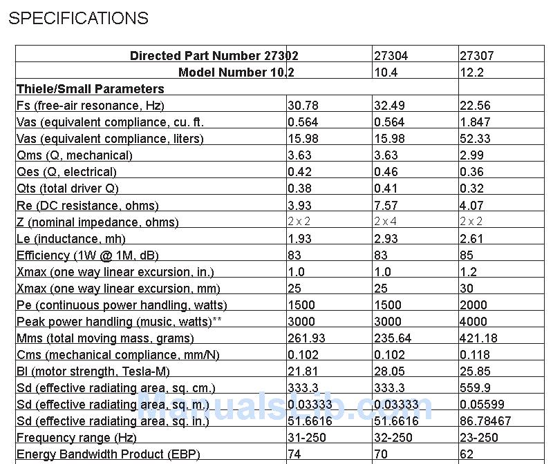

Also Michael Chua...
I've got different t/s parameters to you...
This is the newer black cone spec.

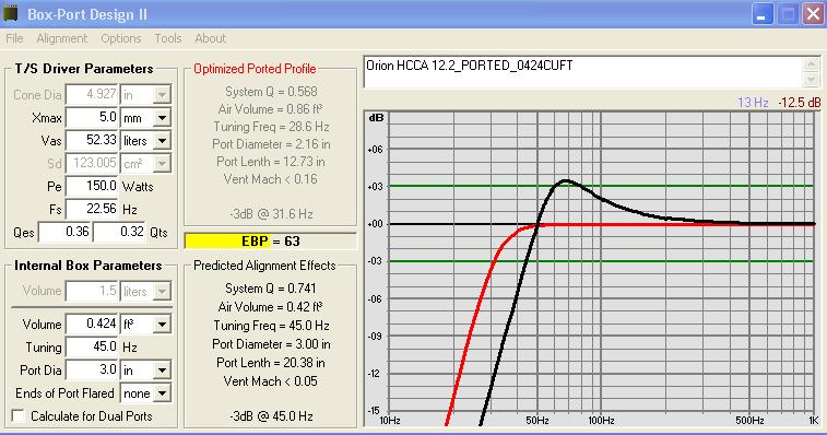

For car use, you'll need to tune to something like this. With cabin gain, The low bass on the left of the peak will increase to almost the same level as the peak.
In the first plot, the box volume is 0.53cuft (15 liters) tuned to 45Hz. This is very small for a 12". Obviously, you'll need to tune it with a slot instead of a round tube.
You can also use a slightly larger box of 0.88cuft (25 L). This will be easier to work with. Tuning is 40Hz. The problem with a larger box is the loss of mid-bass.
Ideally, the box volume should be 0.424cuft. This is very small, 10 liters. Tuned to 45Hz, the peak centers at about 70Hz. You'll be able to hear the bass notes with good bass extension.
