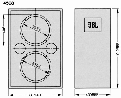

I was looking at a double 15" pre built cab with handles and corners pretty much ready to load cabs for $250 each with finish already, I mean literally just slap the 2226 woofers and your done. Well I kinda measured the exterior it seems the same size as the JBL Enclosure guide plans for double 2226 but only had 2 port tubes 4" X 4" long. Now should I add 2 more port tubes of equal length to get close to 40Hz as possible?

Not sure which JBL plan you are looking at... I have the 4508's, they only have two ports each, not four. Not a big deal to get to 40 Hz, easily done with some EQ.Well I kinda measured the exterior it seems the same size as the JBL Enclosure guide plans for double 2226 but only had 2 port tubes 4" X 4" long. Now should I add 2 more port tubes of equal length to get close to 40Hz as possible?
Oh Ok if you look for it in google it'll come up JBL Enclosure Guide and looking at making the #10 plans. These are pretty old page I have seen this since the 90's but I was looking on the 4508 are those double 15" woofers as I have 6 2226H being reconed now as we speak they will be ready Monday and shipped back to me. Just curious what are the port size diameter and lenght and does your 4508 go down to 40Hz? I don't know what drivers are loaded in JBL 4508? Thanks!😕

if the diameter isn't an exact match adjust the length, the volume of the port is what is important.

Yes, I forgot to mention the dimensions shown for the port, are the total required, and you need to divide the figures according to how many actual ports are used in your cabinet. I use a pair for my home studio, and they are loaded with 2226H's.
So if I use a 6" tube, I would need it shorter than the 4 1/4" length that is needed as original 4508?

Now how to compute the port tubes using 6" diameter?
There are many online calculators for just such purpose, you can ignore the JBL port info posted above and just use the 6" tube as your input parameter.
Is the port on original 4508 2 X port tubes at 5 5/16" diameter and 4 1/4" each. So the total to make it simpler 5.30" X 4.25" = 22.525 sq. inches??? X2 = 45.05 sq. inches total?
