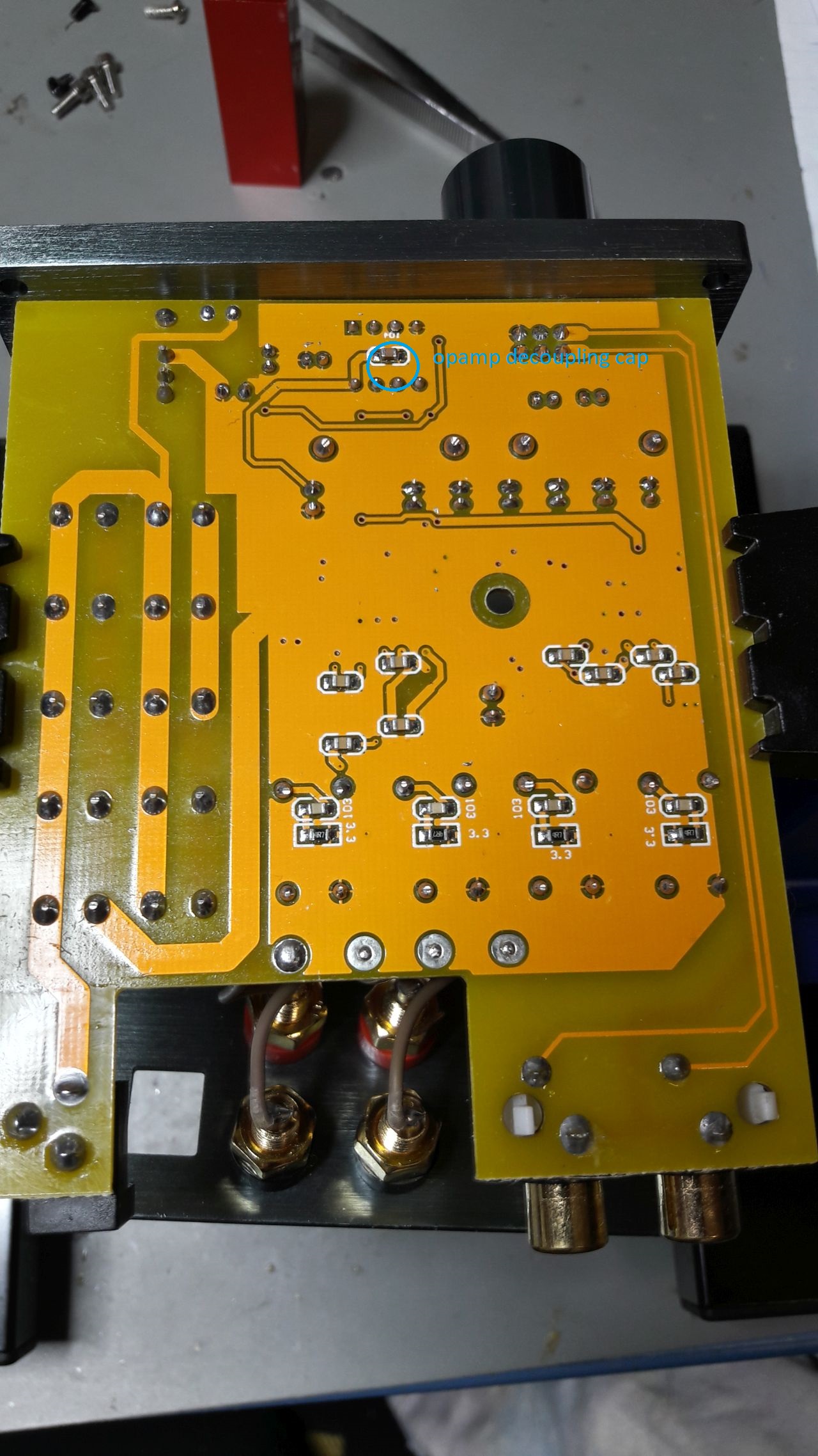

Hi tyler
yes ICG is right. at this amp you have to start to solder!-->SMD is a bit delicate to do it. open the amp, put out the board, remove heatsink...
its decribed at here - post 22: https://www.diyaudio.com/forums/cla...tpa3116-2-0-100w-dual-chip-3.html#post5791089
at the position where 104 resistor put in a 5600R=5k6R resistor smd and the other put out. data sheet table 6.5

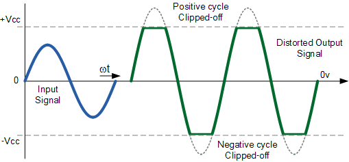

The position of the knob does not say xx% of the maximum power is used. The problem is the gain, on some amps there are dip-switches to change it, on others you have to start up your soldering iron. I'm sure there are several solutions already here in the forum, search for 'tpa3116 gain'.
You could also put a voltage divider on the input or use a different potentiometer (ie. 100k instead of 20k?), the best solution is to reduce the gain though.
hi tyler
here is an illustration about input signal and output signal = gain
and what happened if the voltage get to the point of the max power supply (rail) voltage= clipping
amp 2 changed outputfilter and opamp+ gain 20db

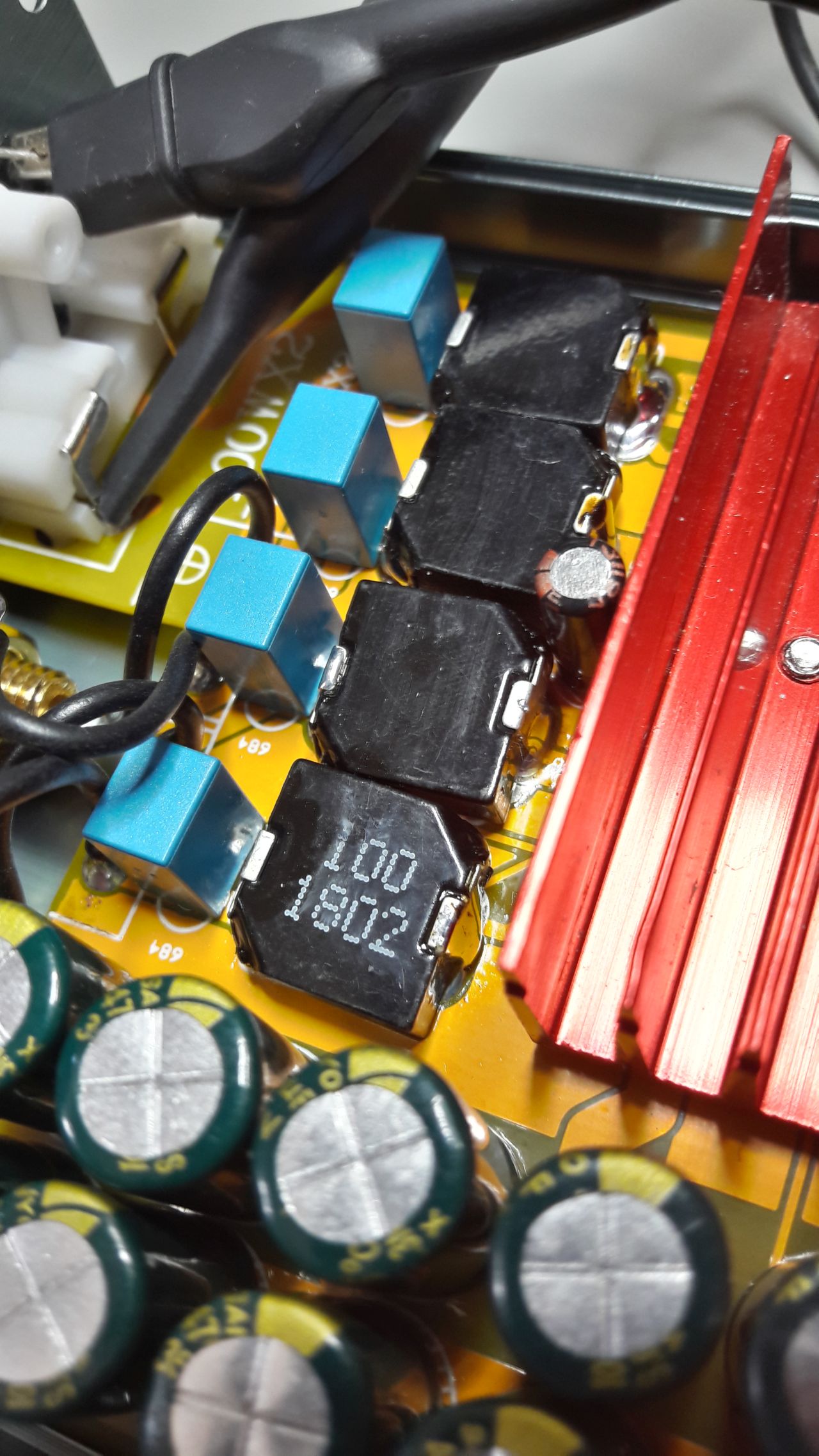

here are some pics with changed output filter 10µ Bourns SRP1250-100M at conrad shop about 1,83Euro each and fits perfect in this small housing. the output filter caps are TDK 0,68/100V. additionally i changed the gain to the lowest = 20dB=5,6kR. the opamp is the 4562. the origin was really fake because the dimension of the legs was unacceptable big that i have to push hard to get it out.
after 3 days burn in its a very good sound- i mean its near the tpa3250 (fx502spro). maybe the gain setting (20dB) is fitting best to this amp.i can say that the 4562 and the "better" coils(Bourns SRP1250-100M) fit very got together. opamp rolling will be done.
i report back.
btw...dont clean the coils with pcb cleaner...the printed label is gone

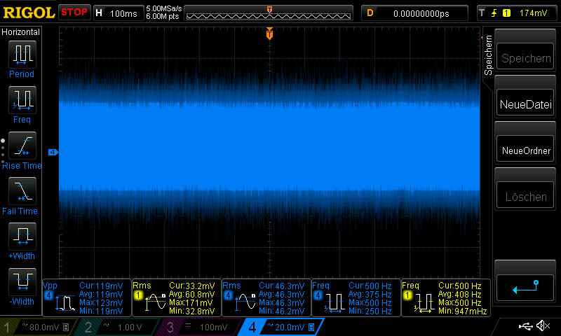

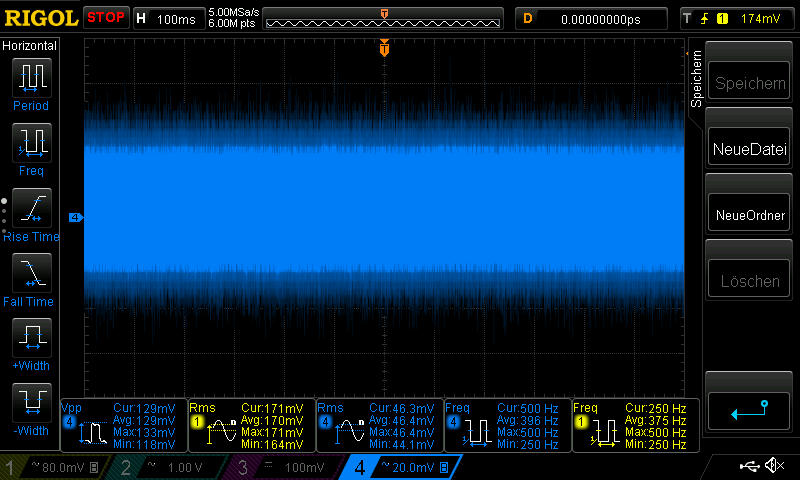

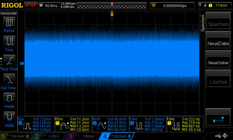

Btw. have you monitored the opamps supply rail directly at the local decoupling cap?
i did it with my differential probe ...but i am not sure if that is correct/ok
pic 1 pin 8 and pin4 amp on signal is a sweep 10hz-35khz with 100mVrms
pic 2 pin 8 and pin4 amp on no signal
pic 3 pin 8 and pin4 amp on rca shorted
about 120mVpp is too much ??
chris

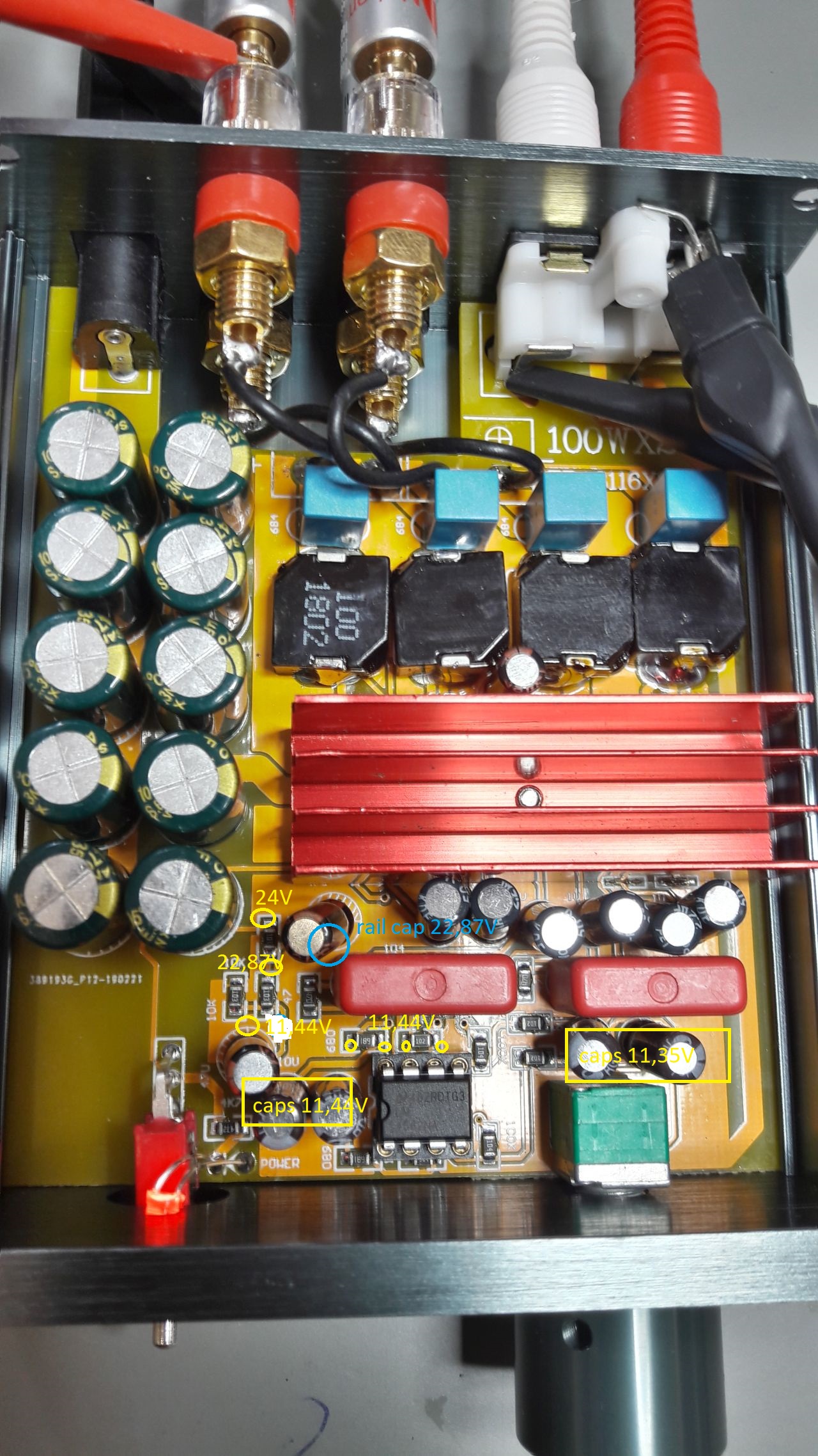

voltage at the opamp area
Hi
i did some DMM probes: the input is 24V from the power supply. a resistor divider set the op amp voltage to 22,87V.= 100k....only 1 rail cap(far away) is existing-blue circle.
10k resistors ......all yellow circles are build by this voltage divider 11,44V.
on the right corner the voltages sags to 11,35V
what schematic is that???
chris

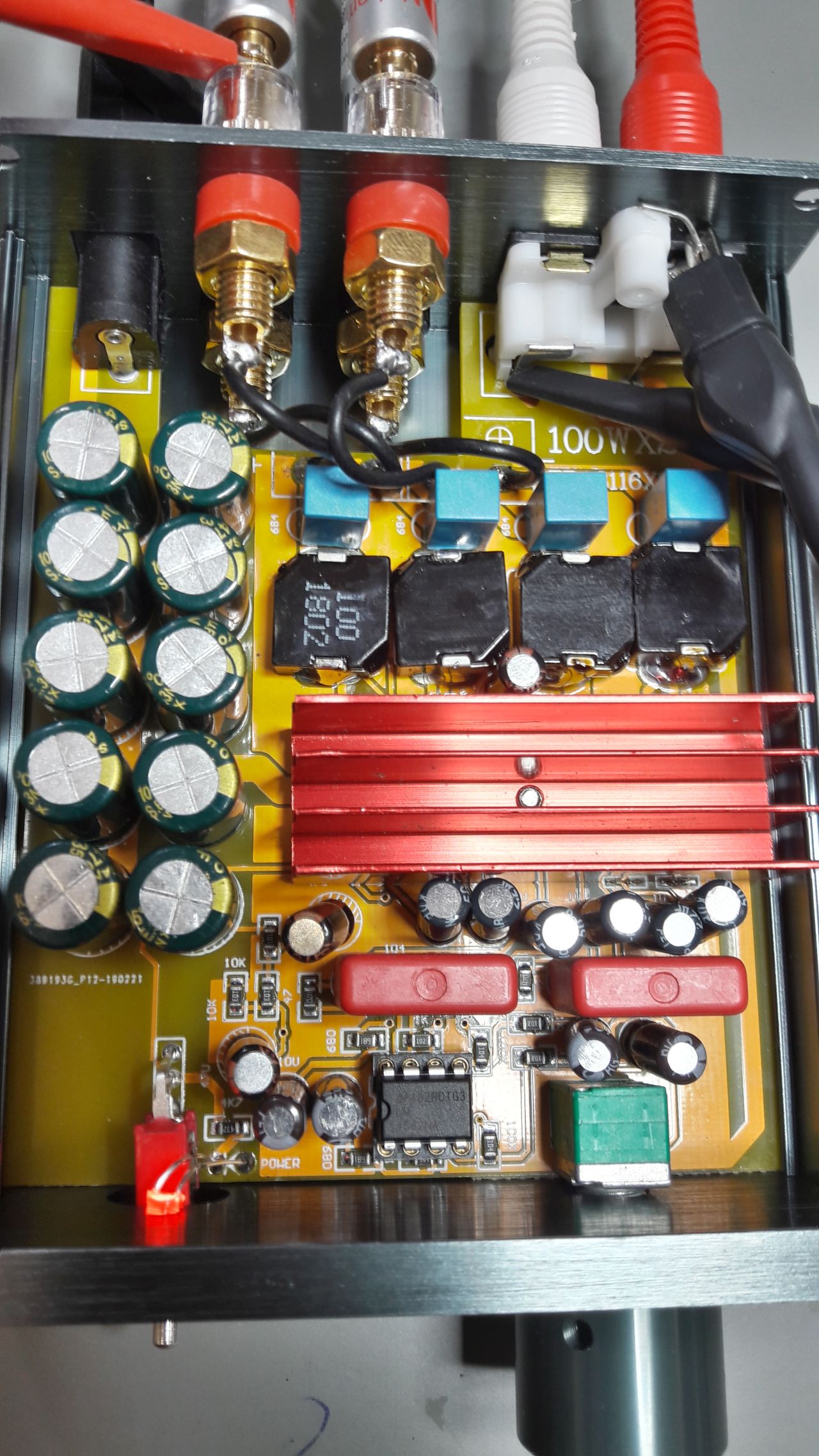

Hi
after enjoying the first summer period...i am back...
amp1 was 26dB gain setting with soft ferrite coils- amp2 was set to 20dB and the Bourns SRP1250-100M coils at the output filter. i did a lot of compare listening session-amp rolling and a 3rd op amp plays a compare roll. it is the NE5532 (bought at conrad 1,8euro).
1st the delivered NE5532 are not sounding at that level as the 49720 or 4562. Why???? i dont know. i "burn in" 2 pcs. but the sound is not really nice....
amp 1 step 1:
I changed the output coils to the Bourns SRP1250-100M. Gain is still 26dB. SQ check was slightly better in case of voices on the top level and the instruments= piano give slightly more "sparkling"
amp 1 step 2:
set the gain to 20dB--> now the amps 1 +amp 2 are sounding the same. i get the impression that the amp is getting "compressed" with the higher gain setting, some "critical" voices getting scratchy and annoying some times..
on amp1 I changed the input caps - post 36 https://www.diyaudio.com/forums/cla...tpa3116-2-0-100w-dual-chip-4.html#post5797917
after these 2 days compare i can propose again- set this amp to gain 20dB. you get more out of sound stage and the rhythm and tact i better.
amp1 changed input caps with 49720
amp2 origin 2,2µ caps and lm4562
chris
