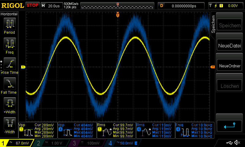

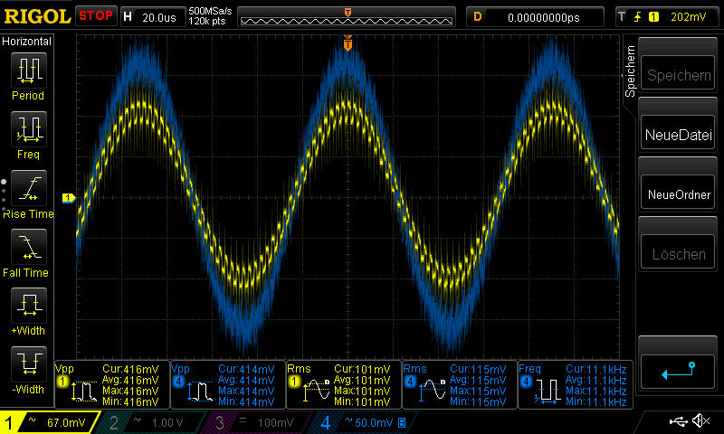

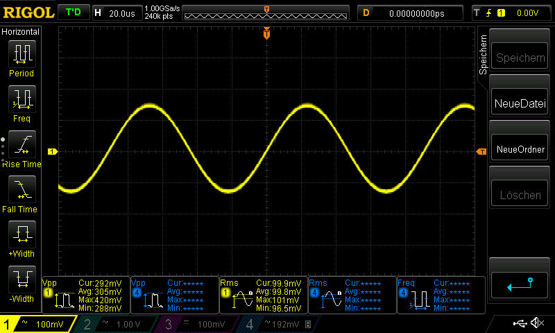

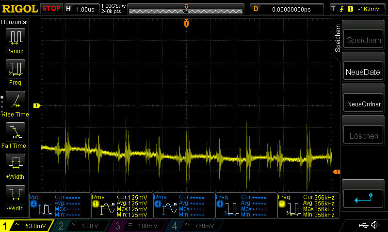

Hi
after a short comparison of the opamp 4562 and the 49720 i found that the 49720 fits very good. i want to have a closer look because the 4562 sounds "hard"...maybe ringing??
at my amp 1 (yes i have 2 amps 😀) i did some measurements but i found something strange for me.
11khz 100mVrms input on both channels
pic 1 is the input signal on the Lch RCA yellow amp off
pic 2 is the input signal on the Lch RCA yellow amp on
--> what happened here?? why is the input signal destroyed..scattered???
pic 3 is the input signal on the Lch RCA yellow amp off blue is the signal on pin 1 of the opamp
pic 4 is the input signal on the Lch RCA yellow amp on blue is the signal on pin 1 of the opamp
both opamp doing the same
chris

That looks like a stray high frequency rectangle (radio?) interference. That could come from the outside but if you say it's also on the input, it's also possible the amp IC is defective. To exclude that, switch the input L+R. If it persists, it's located within the amp.
Put some ferrites right next to the OPamp inputs. Murata offers nice 0402 ones with 1k impedance. (Not the solution but will help somewhat)
The LM4562 is a bipolar input opamp and prone to RF EMI demodulation as seen here. Ferrites may/will help to improve PSRR here. If the input layout isn't well made (unsymmetric) things are getting worse.
Btw. have you monitored the opamps supply rail directly at the local decoupling cap?

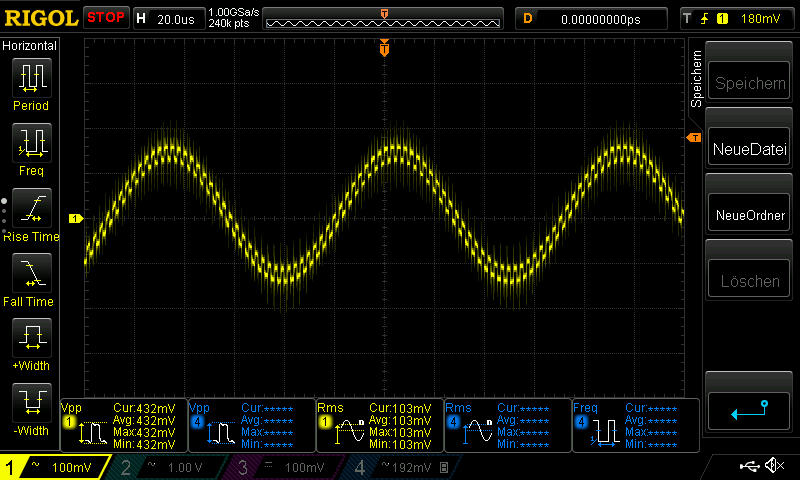

Hi
i did yesterday night the same measurement on the right input channel. its the same. the amp2 shows the same behavior. if i zoom in on scope you get a pic with some 400khz "working" frequency
chris
yes i guess its the small not well designed layout, because both amp do the same and the all chips are fail its not real. i try with mu metall foil to protect the rca inside the amp without shorting something....no result...
if turbowatch2 can do the same measurements then it would clear that´s the design.
